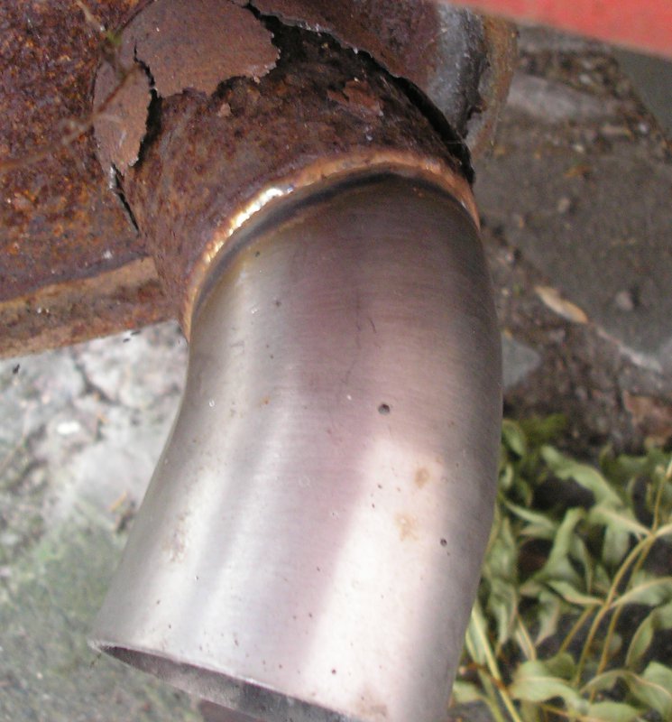

I agree in principle but the service environment plays a huge role. There's various architectural/decorative applications that aren't gonna challenge the corrosion resistance of stainless where burnt/coked welds are more of a cosmetic/time wasting deal when partial pen and/or fillet welds are acceptable.Sorry another Q.
Surly we select ss for it's corrosion resistance and we remove oxides and heat tint etc to aid with those characteristics. I cannot think of a case scenario where sugaring/coking is ok. Yeah I suppose a dull weld can soon be brightened back up but the underside is knackered surely if you create coking.
Not a coked example but FWIW just taken this pic of a stainless tailpipe welded to what's left of an (origionally aluminised) mild steel exhaust
I made that at least 8 or 9 years ago, might well have used 316L wire as i'm more likely to have had some in 1mm than with 309L etc. Definately wasn't purged and never been cleaned until 10 mins ago when i wiped it with a rag (it wasn't about having a shiney tailpipe, just a convenient bend offcut kicking about)
