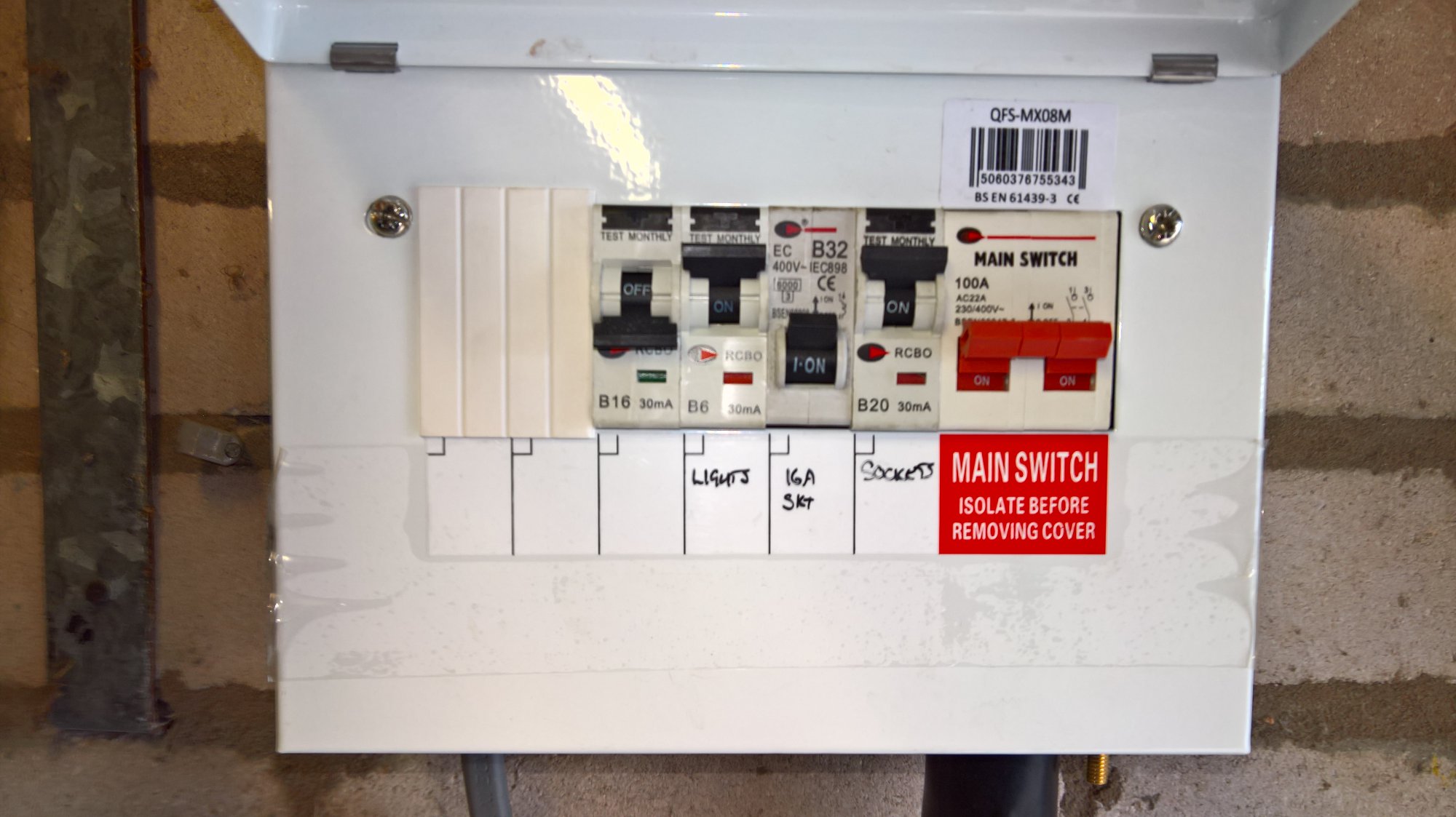

    hi I have a boc 190c mig welder single phase. I have just had a new 6mm swa cable wired up to my garage with a 16amp socket fitted for the welder. The problem is I can't run it on full power or it trips the breaker. It was wired to a b16 amp and because that didn't work my electrician fitted a b32 amp and it still trips. Why is this happening? The welder has 8 power settings and it even tripped on the 16amp breaker on setting 7. Setting 7 works fine on the 32amp breaker. Any advice on this subject would be grateful.
  2. Fife Member
    Messages:
    47
    Location:
    Scotland fife
    WP_20160408_16_48_31_Rich_LI.jpg This is what i have. The rcbo on the left isn't wired to anything that was initially used for the 16amp socket.

    My initial thought was it may be tripping on earth fault rather than overcurrent - but it looks like every circuit except the welder has earth fault protection - they are RCBOs but the welder is just an MCB - I think....
    I'm assuming the entire garage supply is earth fault protected at the supply end as well - if not, I would be a bit wary of running the welder without some sort of RCD.

    bit of a mish mash of unexplained combinations, I`m guessing this board is fed from the House DB ??? whats the breaker and protection for the SWA cable to the garage?
    Worse, we have a 16amp socket protected with a 32 amp breaker??

    The 32 amp breaker is only there because the b16 amp was tripping so should be getting replaced with a c16amp. The garage is on the house consumer unit on a 32amp breaker.

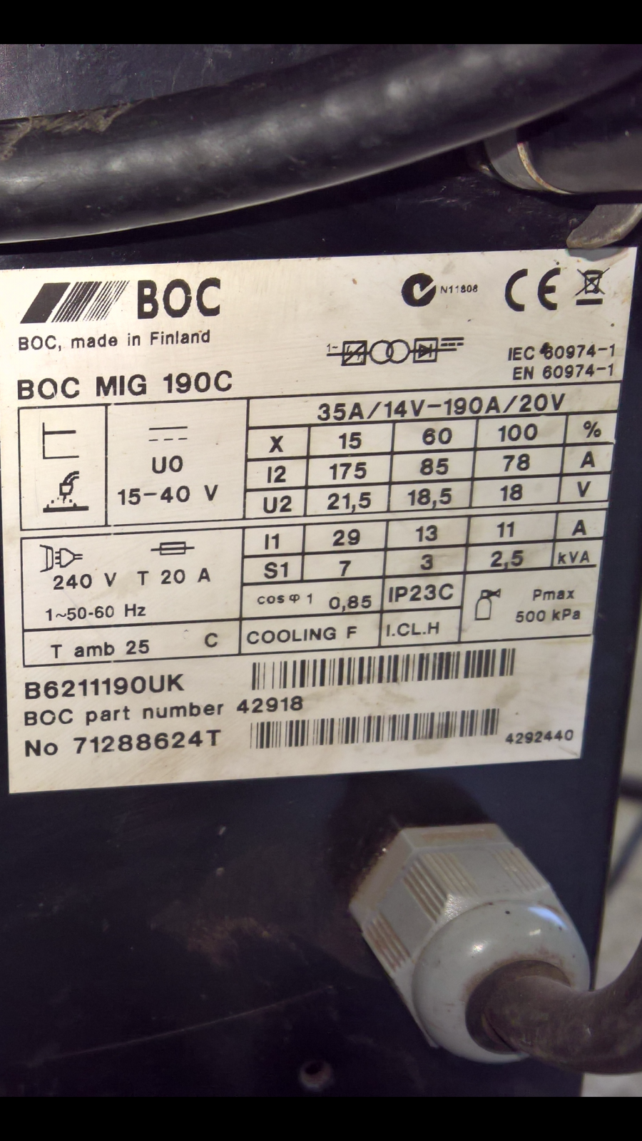

  16. Fife Member
    Messages:
    47
    Location:
    Scotland fife
    Here is the data plate.
  17. dobbslc
    dobbslc Forum Supporter
    Messages:
    4,608
    Location:
    Hertfordshire UK
    Looks like it's a 20a supply needed.
  18. Fife Member
    Messages:
    47
    Location:
    Scotland fife
    Yeh so I need to get a 32amp socket as well then.

    Your plant asks for a 20 amp so give it a 20 amp slow
