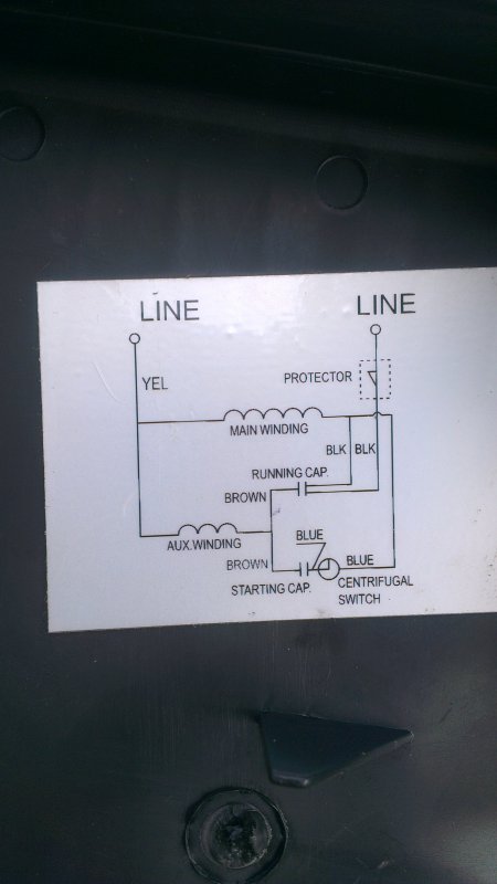

You might be right there,I think you will find that the run cap is the 50uf one and start cap is the 200uf one.
Would this not switching the start coils off cause this fault? ie running both coils at once for too long.
Start cap (50 uf)went almost straight to 0.5 meg ohms
The 25uf run cap measures 25uf
Yeah it's 50uf I don't know where I got 25 from.I didn't notice this earlier but is the run cap 50uf or 25uf
If its a 50uf one and it measures 25uf then the motor could draw more current to run, causing the fuse to blow.
My fault, I meant the start capacitor. I just wanted to isolate the switch from the equation.It will trip if you manually switch off the start winding, as the start winding has to be in circuit with the run cap attached for it to keep running.
I like to be sure what's wrong before spunking cash on a new motor especial as the windings both meter out as ok.It's been a week already and you still haven't figured out you need a new motor!
Seriously dude. Get a new motor, get on with life.

all the centrifugal switch is doing is switching out the start CAP which leaves just the run cap in circuit when above certain RPM, the start winding runs in conjunction with the run cap to give the motor more torque and if disconnected it will O/L the motorIt will trip if you manually switch off the start winding, as the start winding has to be in circuit with the run cap attached for it to keep running.
