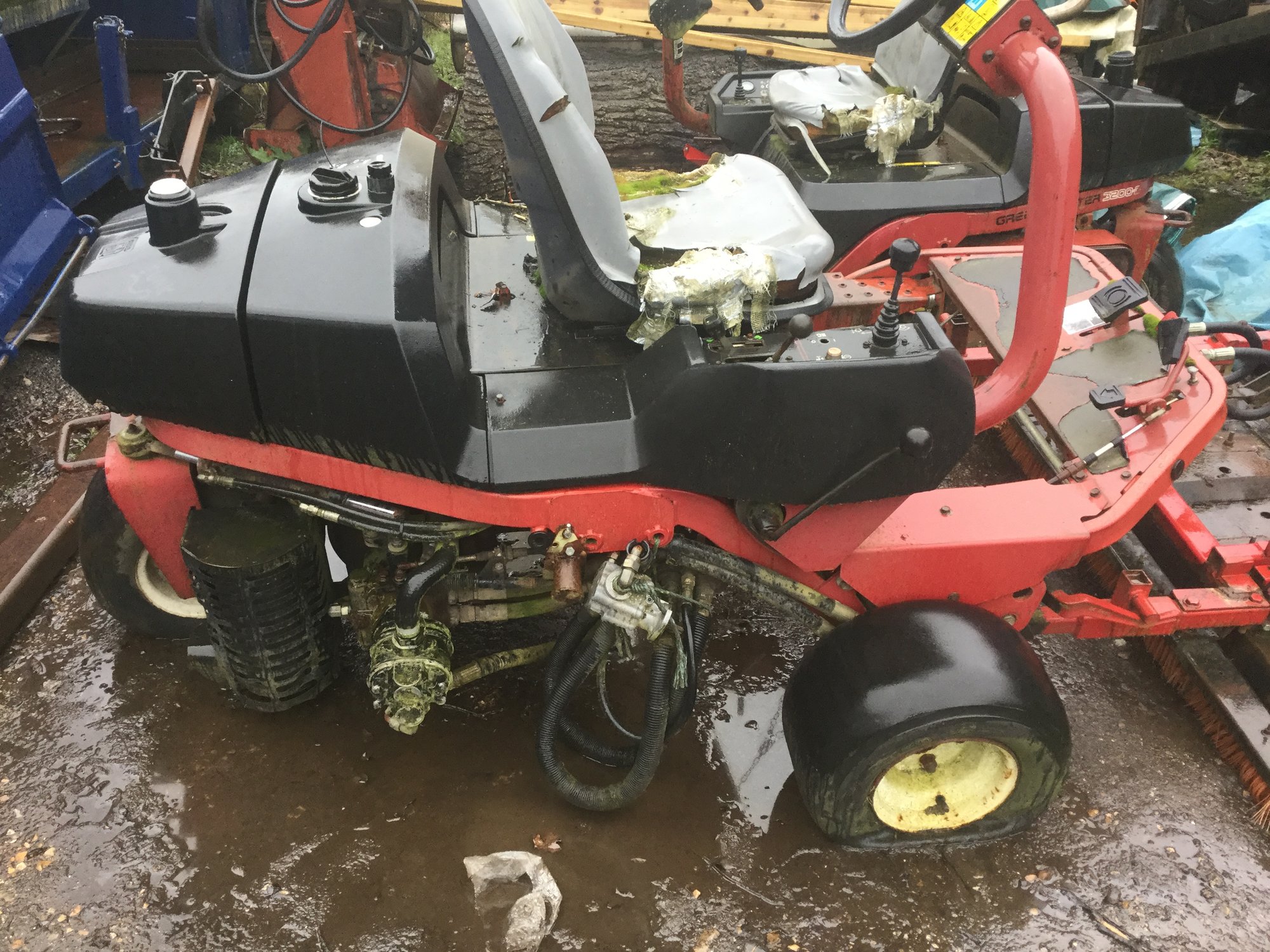

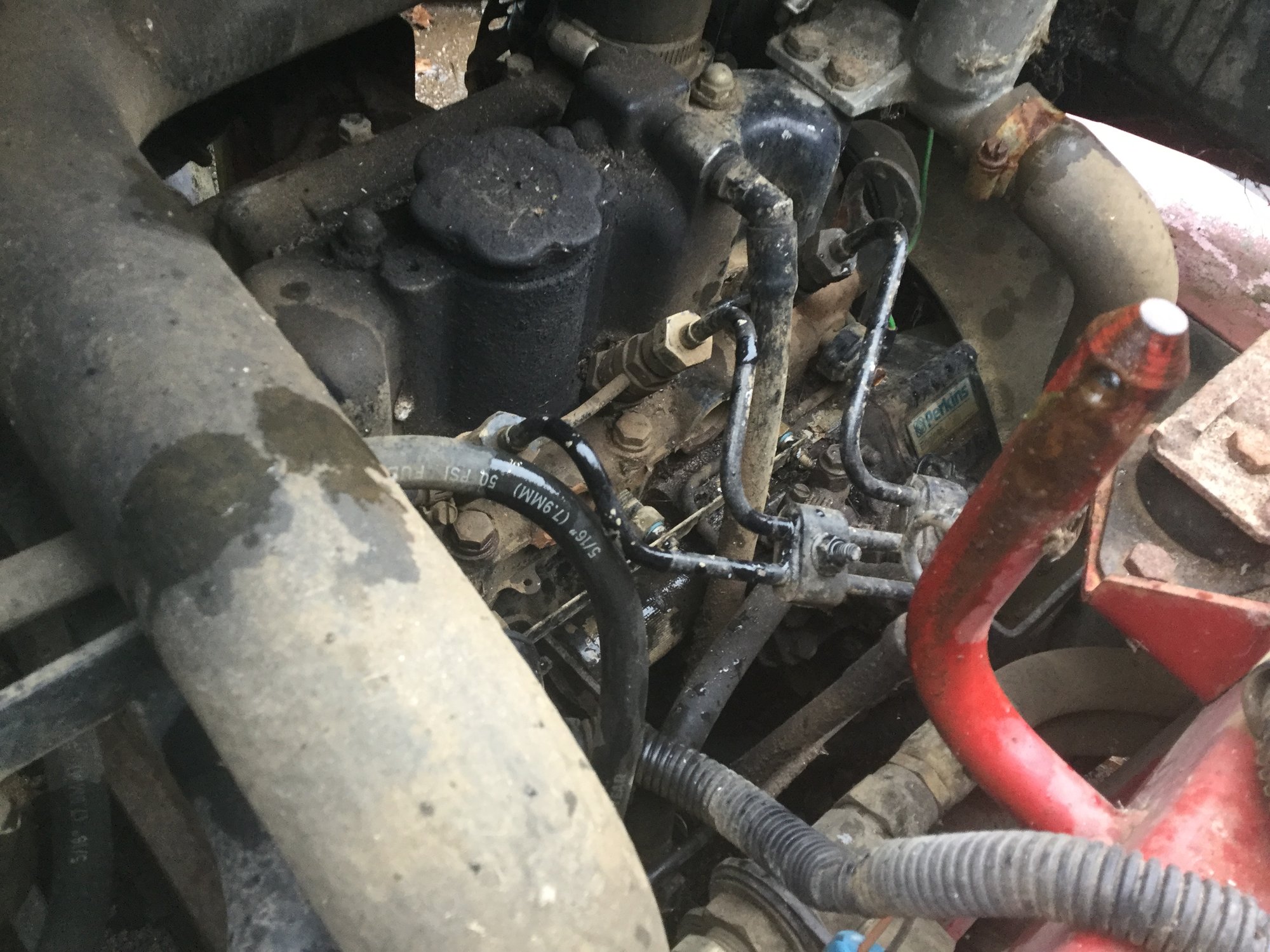

Yes one of them but not the £8k price tag.
Or more closely trying to make of theses
Weight will also be an issue as will alignment as the processor will be trailer mounted. As per the video mounting on the 3 poi t link makes sense.
