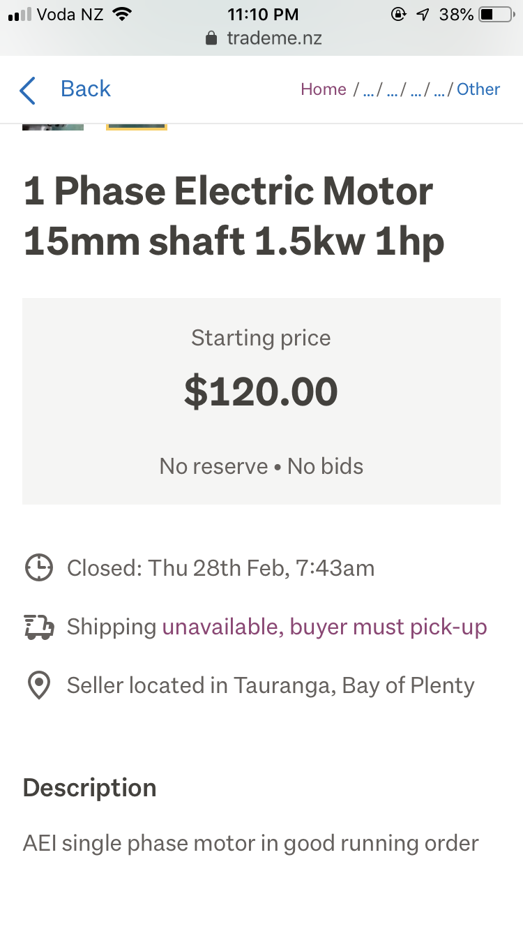

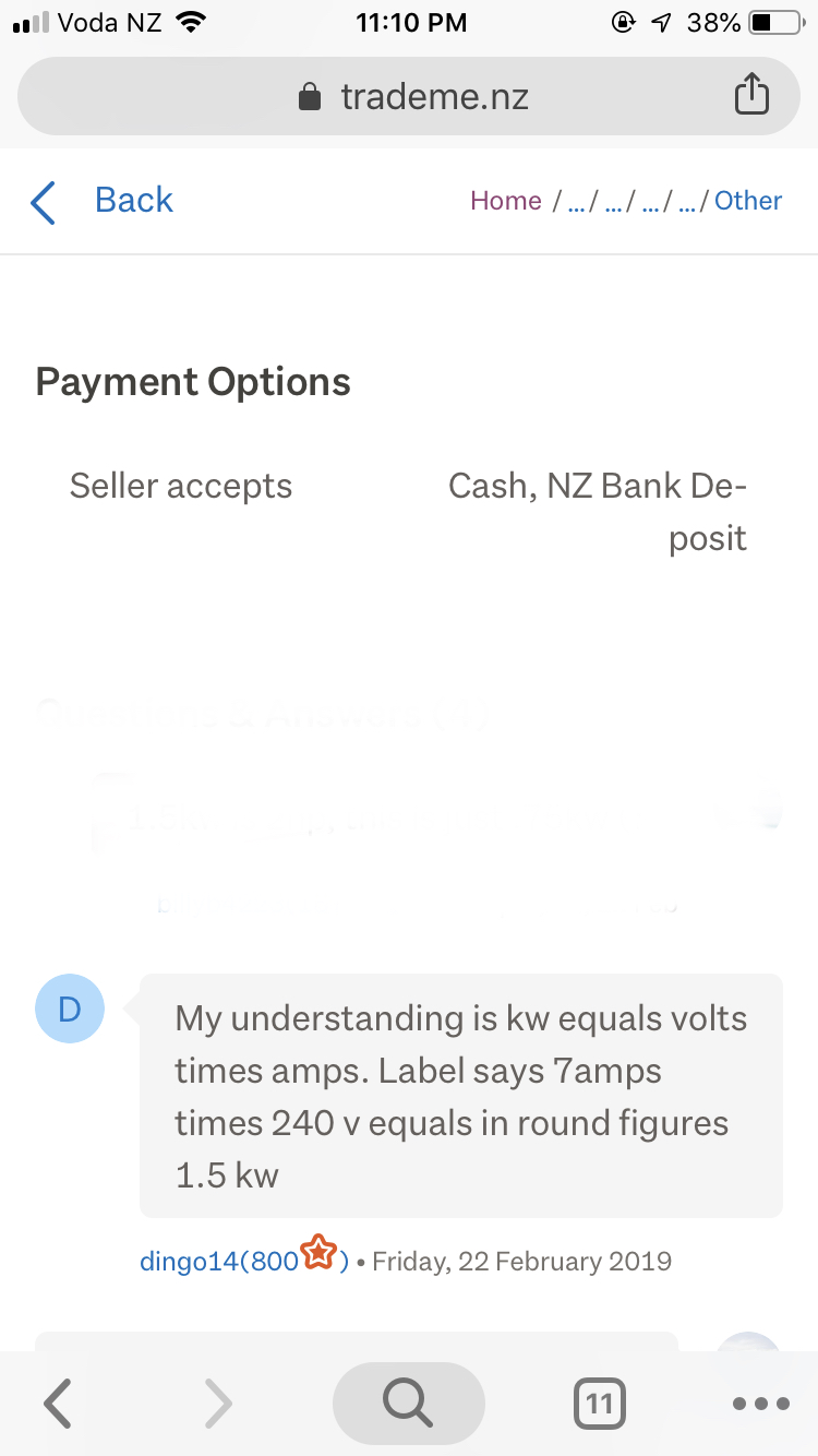

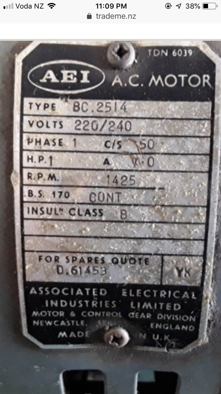

ps, i know what you're saying about 1hp *always* equals 746w.
of course it does. its like saying 60 seconds *always* equals 1 minute.
no-one would argue otherwise.[1]
but we're talking about older? motors - pre metricalization(!) - where input power is given in volts + amps (which are multiplied to get W), and ouput power is given in horsepower, NEVER in watts.
[1] maybe they would, this IS the internet!
