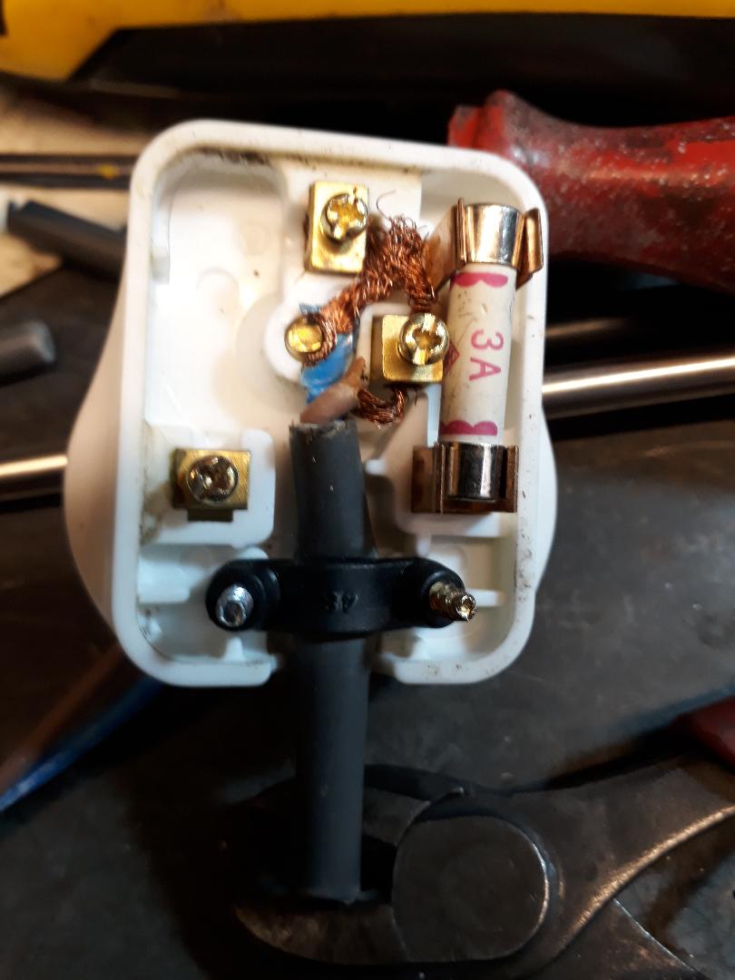

I'm honestly wondering if it's been wired up especially for some sort of ring main/socket test?
Its one way of introducing a fault on a test board, if you're learning, for instance.
I can't make it out If the copper as touching the earth then the fuse would just blow on insertion into a socket.I recon some one wired it to electricute some one especially on a pressure washer lol

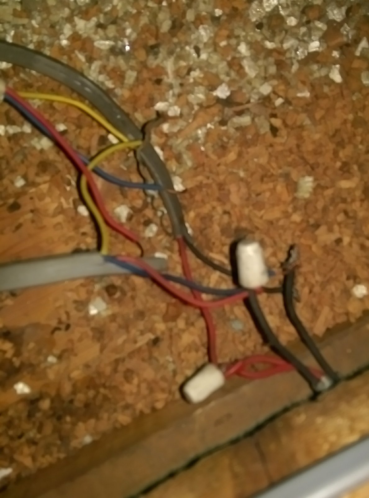

porcelain screwitsFound this under the floor in one of the boys bedrooms, still live!!!
The dogs cock connector was missing on the neutral...
its only 3 amp you wouldnt even hear it pop a 13 amp and would have lit up like blackpool lights and crapped yourselfI'm glad the fuse was all ready blown when I plugged it in,could of been X marks the spot lol
If it wasn't touching the E then not much would happen as L down the L&N wires so the device just wouldn't work.
Way to high risk, if you were going to do this it would be in a box with resistors.That's what makes me think it's been made for some sort of test rig.
We have rigs at college to practice various tests.
A socket hidden inside a "black box" where something like the plug in the OP could be inserted would be a good way of introducing a specific fault to be found on a "dead test" (ie, done with electric disconnected, for anyone who doesn't know).
