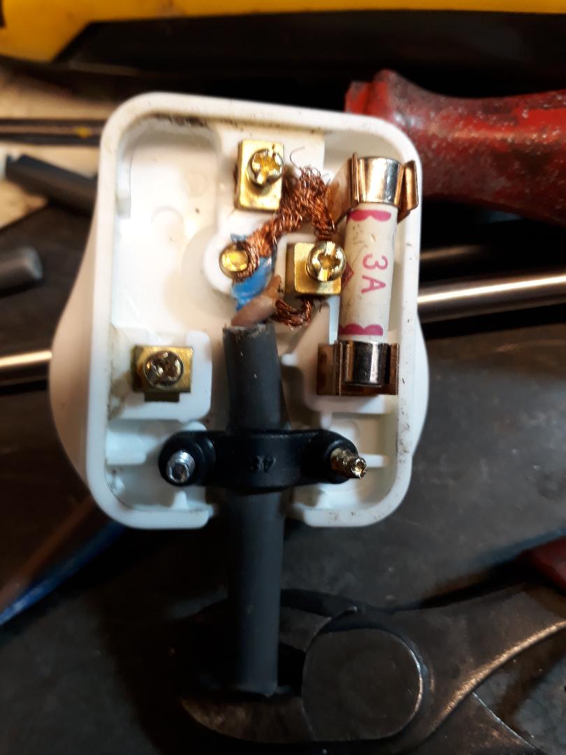

I'm honestly wondering if it's been wired up especially for some sort of ring main/socket test?
Its one way of introducing a fault on a test board, if you're learning, for instance.
I can't make it out If the copper as touching the earth then the fuse would just blow on insertion into a socket.I recon some one wired it to electricute some one especially on a pressure washer lol
porcelain screwits them were the daysFound this under the floor in one of the boys bedrooms, still live!!!
The dogs cock connector was missing on the neutral...
its only 3 amp you wouldnt even hear it pop a 13 amp and would have lit up like blackpool lights and crapped yourselfI'm glad the fuse was all ready blown when I plugged it in,could of been X marks the spot lol
If it wasn't touching the E then not much would happen as L down the L&N wires so the device just wouldn't work.
Way to high risk, if you were going to do this it would be in a box with resistors.That's what makes me think it's been made for some sort of test rig.
We have rigs at college to practice various tests.
A socket hidden inside a "black box" where something like the plug in the OP could be inserted would be a good way of introducing a specific fault to be found on a "dead test" (ie, done with electric disconnected, for anyone who doesn't know).
