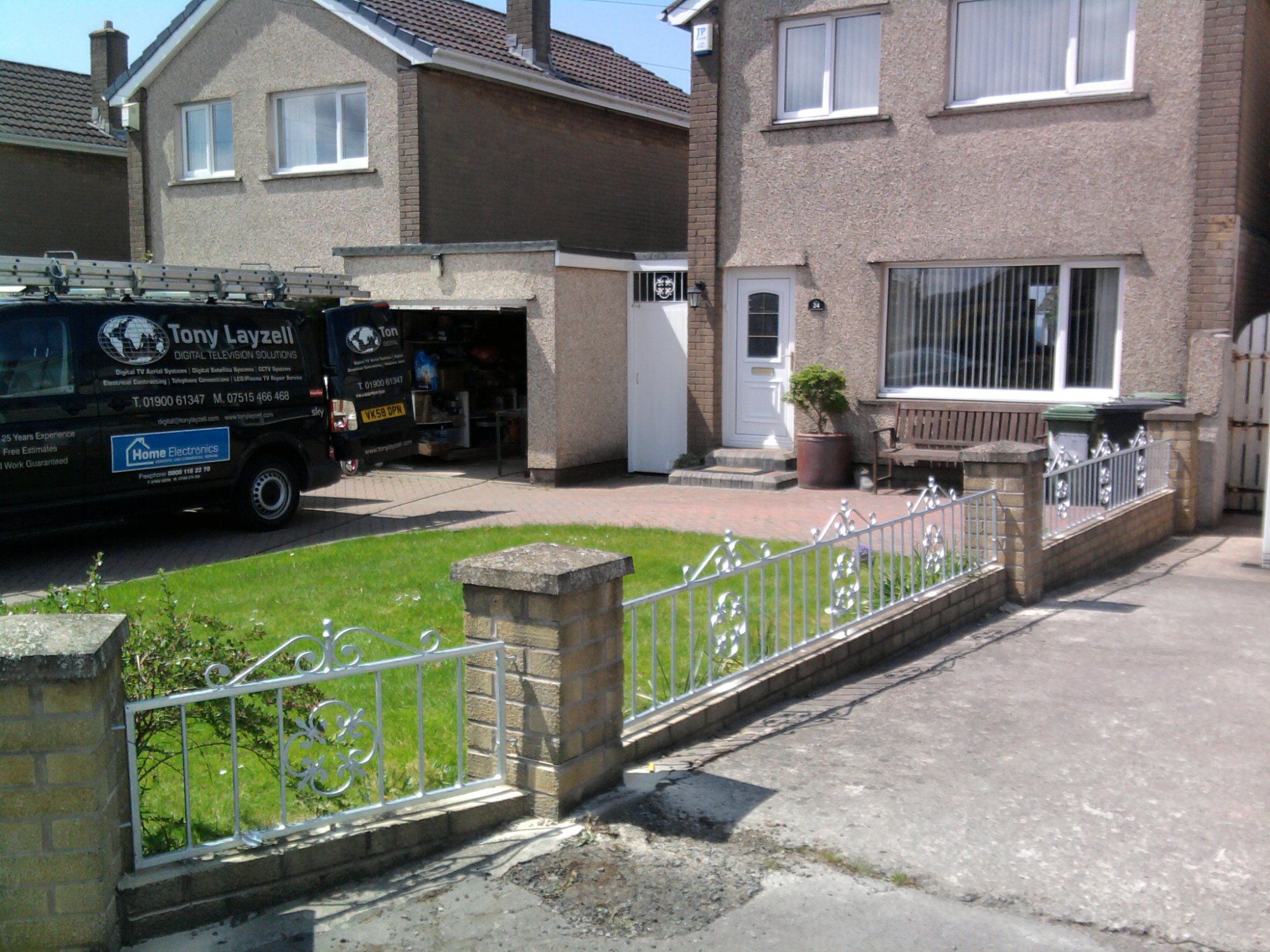

I have made railings using a 135 Clarke, 25mm box frame with 12mm bars with no problems, now obviously the experts will say they are not welded to full penetration etc etc and I will agree 100%, I will also guarantee it would take a hell of a big hammer and a lot of sweat to break apart and it would bend long before parting.So for migging gates n railings what amperage do you need? no bells and whistles ,but enough guts to do the job without releasing the special smoke which holds the special sparks in it..
