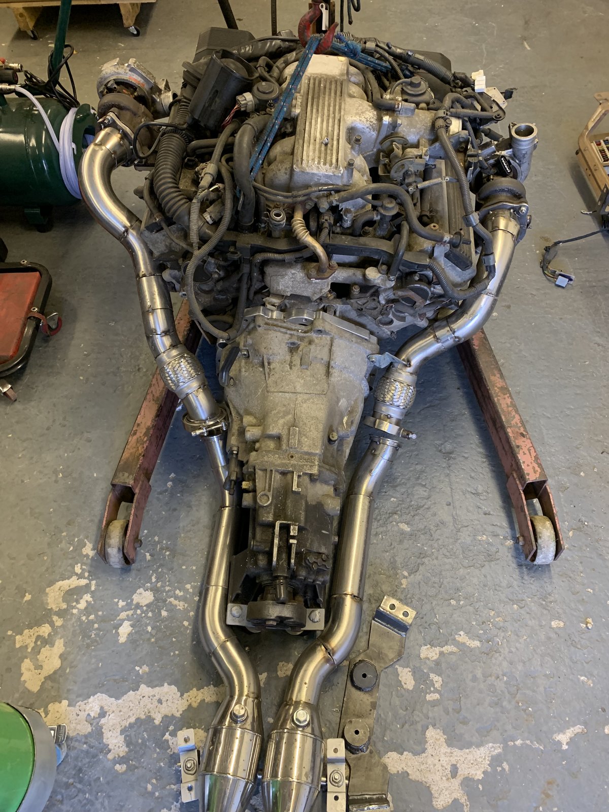

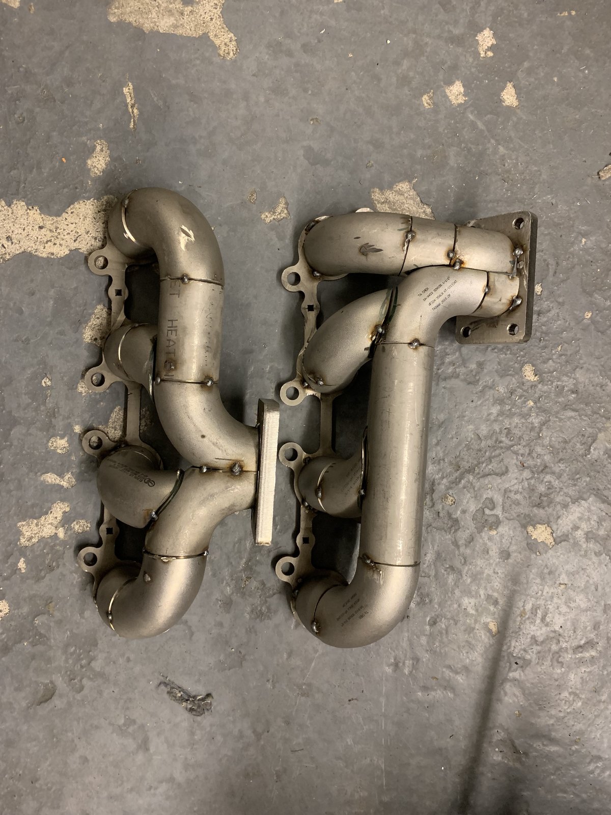

That looks like the bulk of your welding work is a dc application.Not really, but I have a full exhaust to weld (manifold and turbo back) to do on my car, a mates van exhaust cat back, boots pipes for my car, exhaust valves on my daily, as well as a couple of little bits and bobs. The main thing it’s holding me back on is my project that needs the exhaust.

If it’s mainly stainless and mild he’s welding I reckon he could spring for a nice Lorch DC only set with a nice torch with £1300 to spend. What’s available?That looks like the bulk of your welding work is a dc application.
Looking at what your faced with there I wouldn’t be concentrating my priorities on worrying about a machine that would be secondary. You need a nice torch to make a good job of that.

He’d get a lovely little micortig 200 basicplus for that. Same set you played with at Cannock.If it’s mainly stainless and mild he’s welding I reckon he could spring for a nice Lorch DC only set with a nice torch with £1300 to spend. What’s available?
