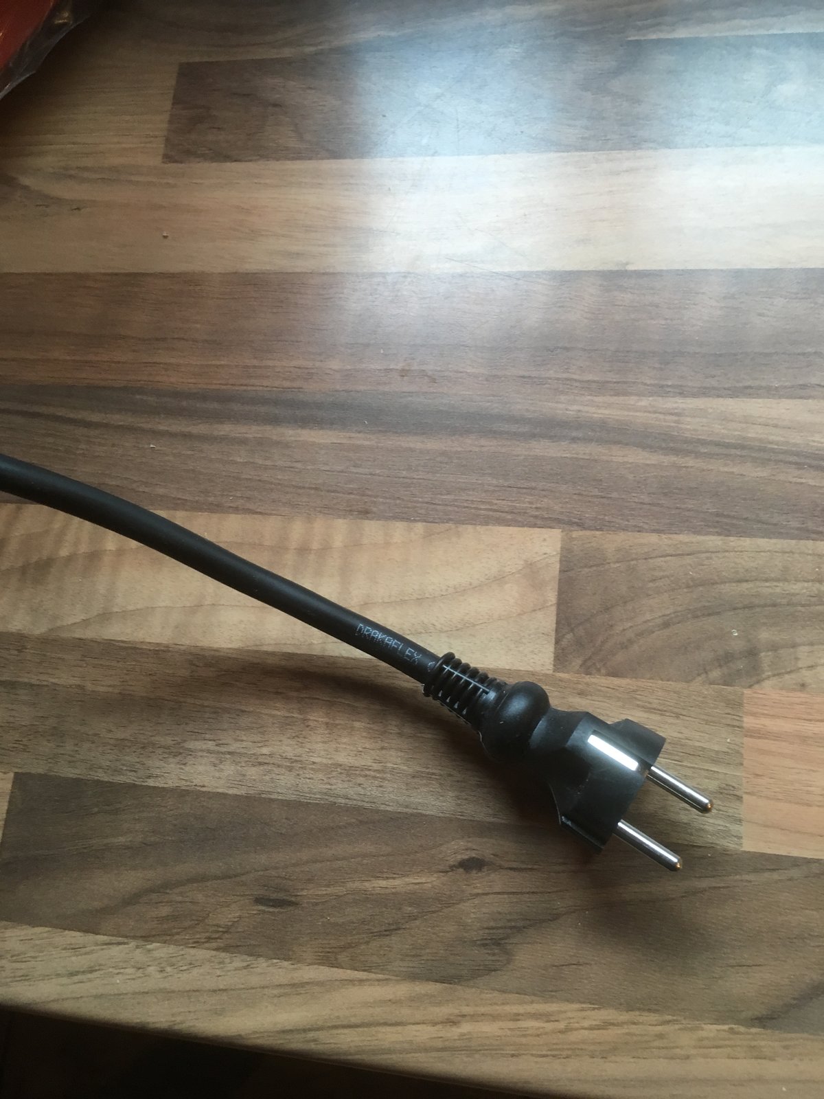

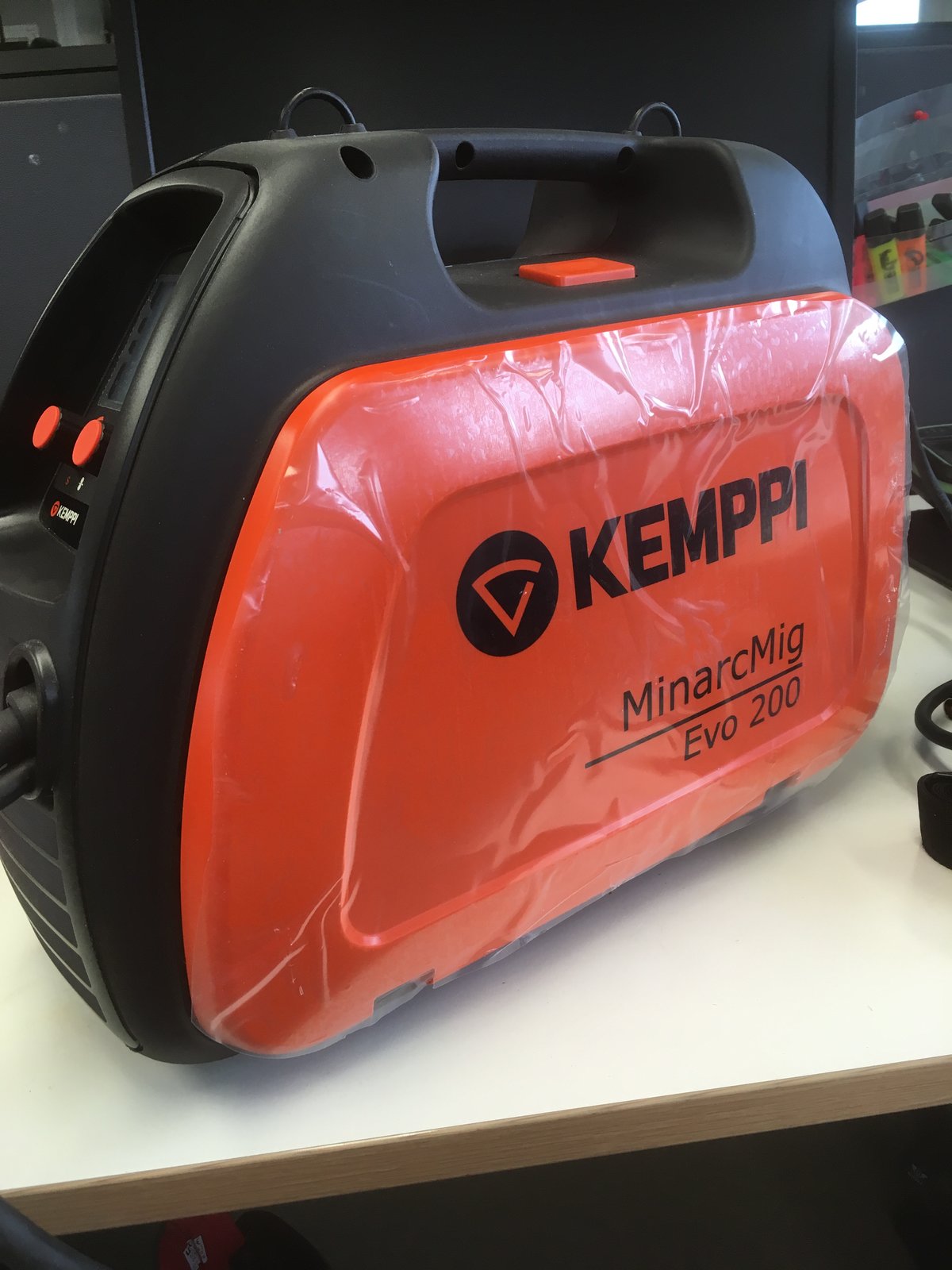

I don't see why not I use 40a on all mine or you could just bang a good 13a on itView attachment 141818 View attachment 141819 just got me new welder,kemmpi,now my old welder was on a 32A plug,will it be reat with this one too
The 32a on my welder clamps 2.5 tight enough to leave dints in the cable if you take it offBetter over rated than under rated.
It’s only going to draw what it draws.
Put a 32 on it.
Just make sure the gland on a 32 amp plug nips that thin cable tight enough to prevent a core pull. I think they are best suited to 4mm cable but @brightspark will know for sure.
Just a question because this isn’t my field of expertiseunlikely event of a fault.
Would down sizing the breaker avoid thisRCD's ONLY sense earth fault current! If a dead short were to happen it would melt before it tripped.
RCBO's sense both earth fault and over current but if it's an overload on the wrong size breaker it will still cause damage / melt / catch fire....
What's the point it would only get a mig tip shoved in itYes, a smaller mcb of 16A would do looking at the welder cable flex size.
When is someone going to make a Commmando style plug with a fuse in it???![]()
in the event of a short/fault the breaker will trip regardless of rating, to melt the cable requires a load over the cable rating but lower than the breaker rating for a continued prolong time.
