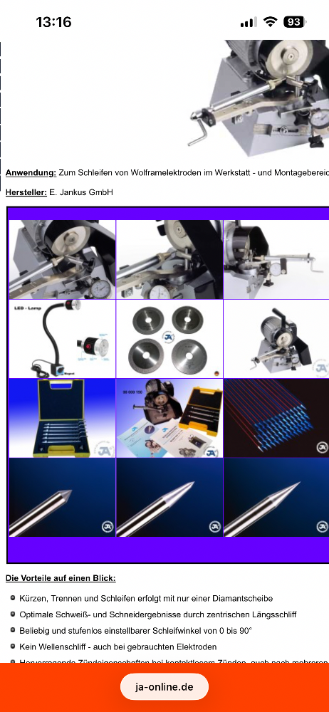

Just reading around the web tbh, it seems like a lot of people use CBN but I've no idea between that and diamond. It's for my son, he's doing welding and fabrication at college, 3rd year so deffo learning but hopefully getting there.Is there some reason you have gone for CBN? From what little I understand, I thought tungstens were normally sharpened on diamond wheels.
