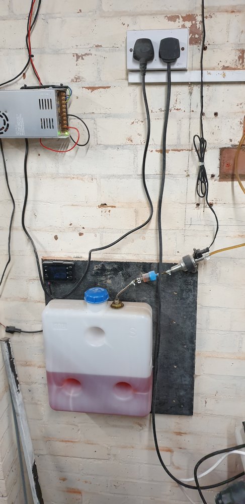

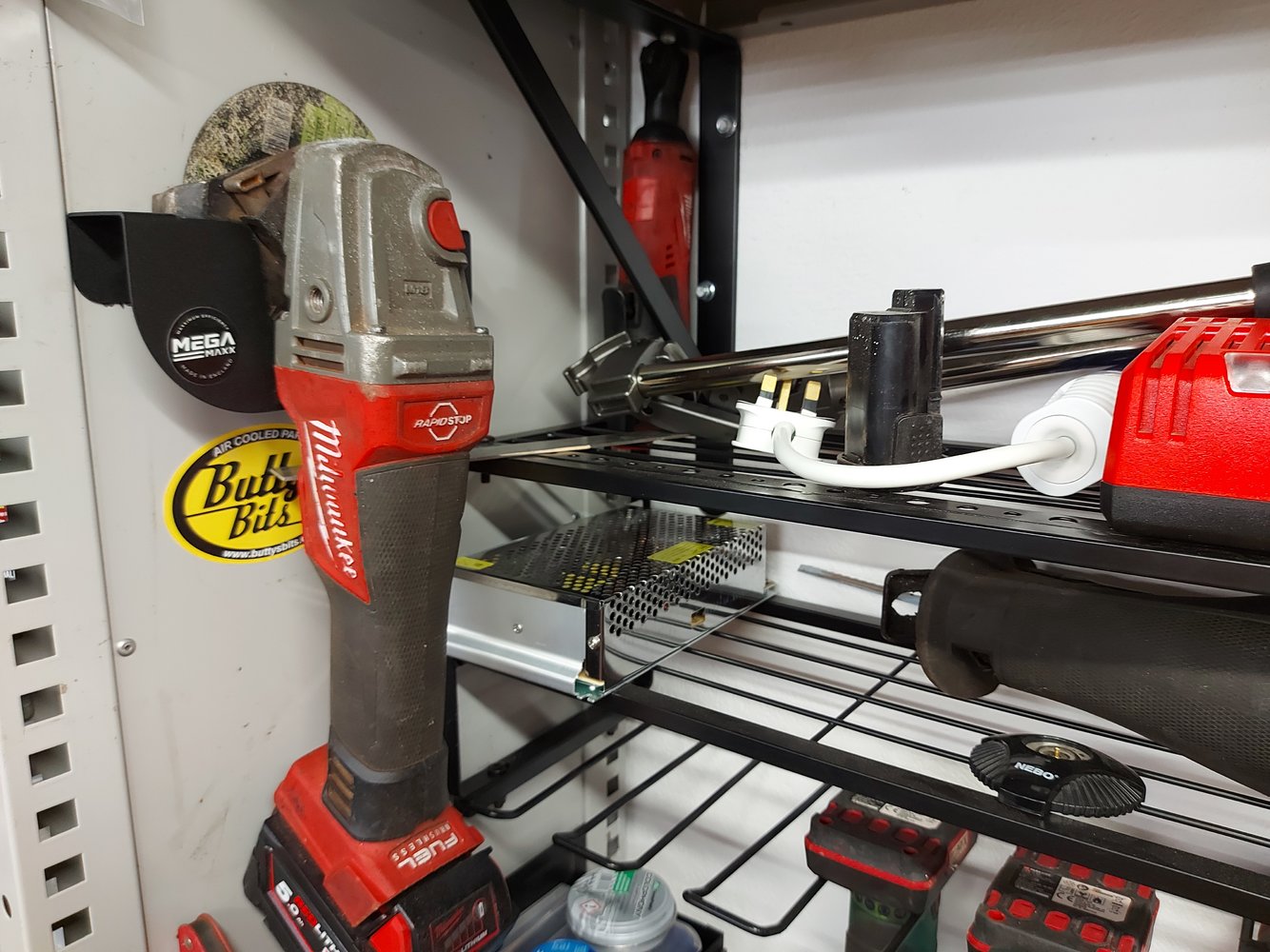

I quite like the look of those PS, except for the open terminals. Especially having 230vac unshrouded terminals - that's more than a bit shoddy.
That said, it looks like they are designed to be inside a cabinet/enclosure as part of a built assembly rather than as a stand-alone unit.
Bunging one in a larger, well-ventilated GRP box might get the answer? I've done that with some panel-mount SMPS charger units with similar terminals to make safe to handle.
Just get a cheap plain enclosure & either drill lots of small holes on top & bottom, or if feeling fancy, cut out bigger square sections and stick some mesh overYes I agree I'm definitely not keen on the exposed terminals. And it does need good ventilation maintained I would say. I'll search for a suitable electrical enclosure box.

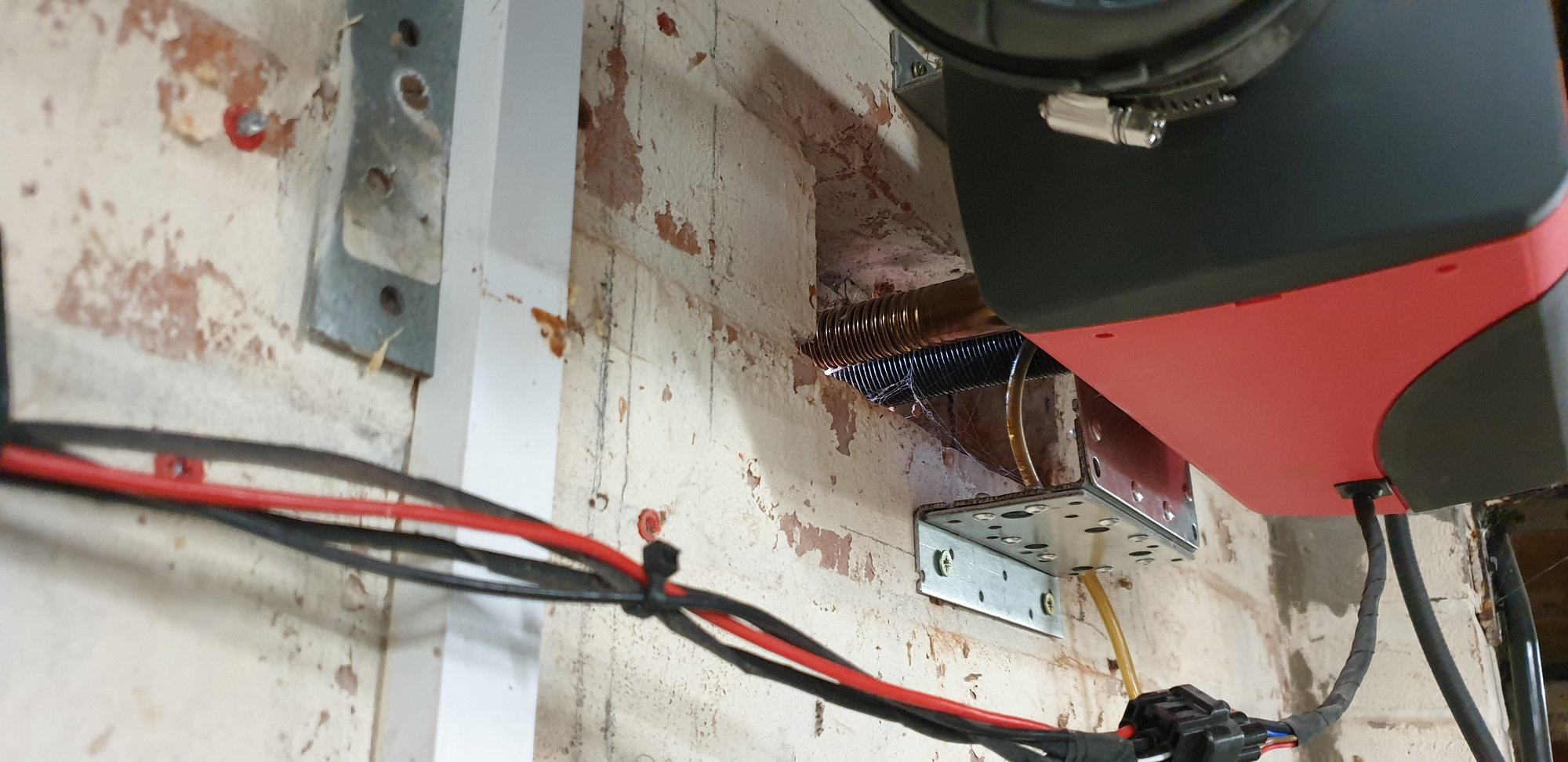

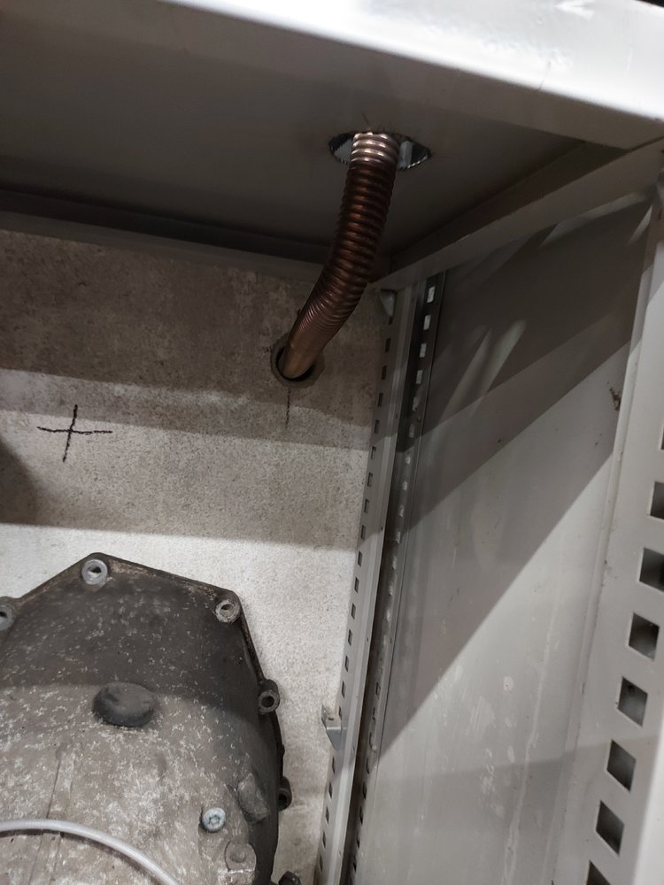

Why have the heating air inlet where there is a chance it will ingest exhaust fumes

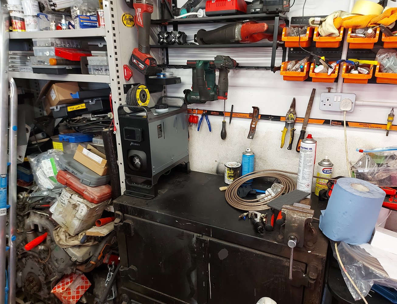

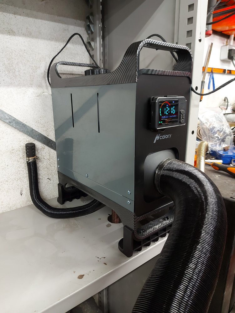

This is what I did with mine. No overheating, safe and works well.Just get a cheap plain enclosure & either drill lots of small holes on top & bottom, or if feeling fancy, cut out bigger square sections and stick some mesh over![]()
