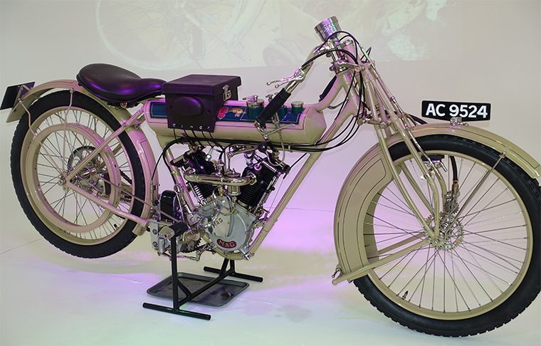

not one of mine but looks nice, may use that style of tank as it was offered in 1911,
