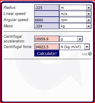

If the speed of the grinder is measured from the spindle then the speed of the wheel should remain constant as the wheel size decreases. If you draw a line from the centre of a disc to the edge it will always rotate the given number of times per minute no matter what size, the line will always pass a zero mark at the same time.
