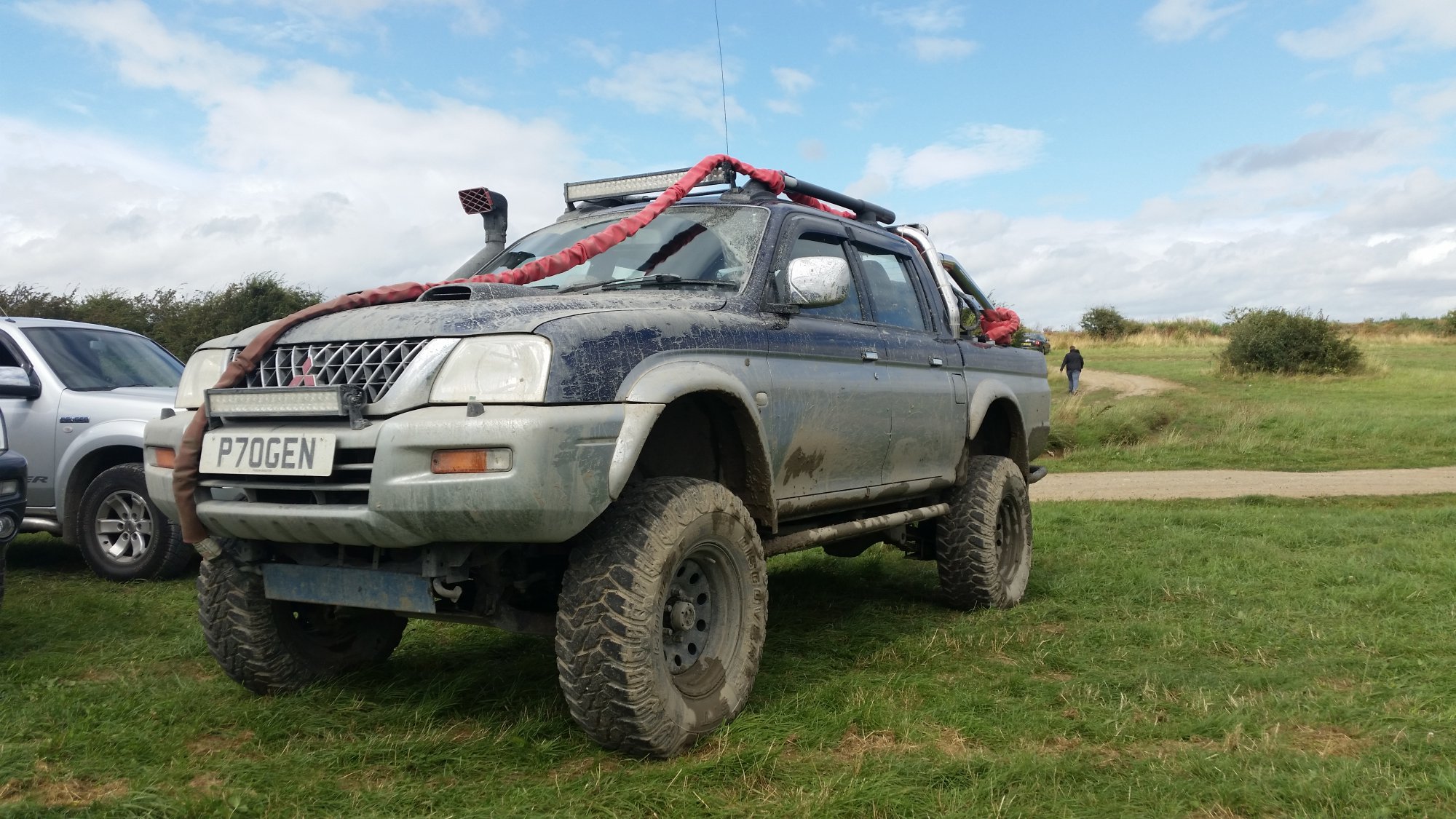

What car is it ? If it's only two studs push them out they are probably on a spline, cheaper than thread restoring and peace of mind
Oh no it gets worse
Please don't tell me it's 30mm spacer

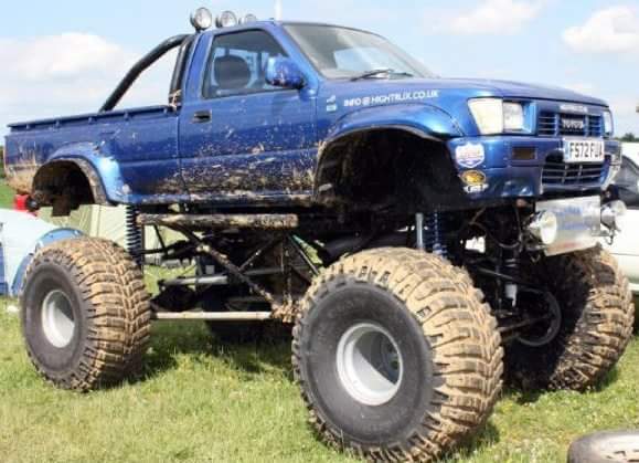

Half the fun is rebuilding but we are talking taking things to the extreme on mine and not worrying about cost but I dare say you don't want to be shelling out money if you don't want or need to.

they are rubbish i took a closer look at the threads compared the the standard mitsi nuts and the threads are much better cut and deeper on the oem ones
