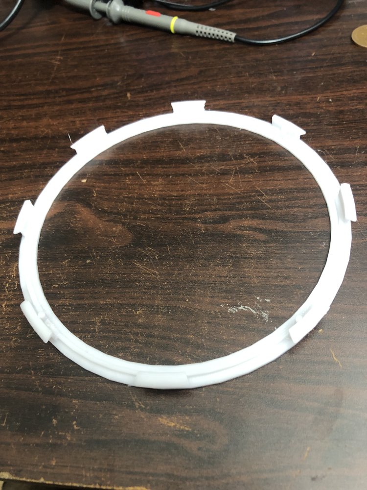

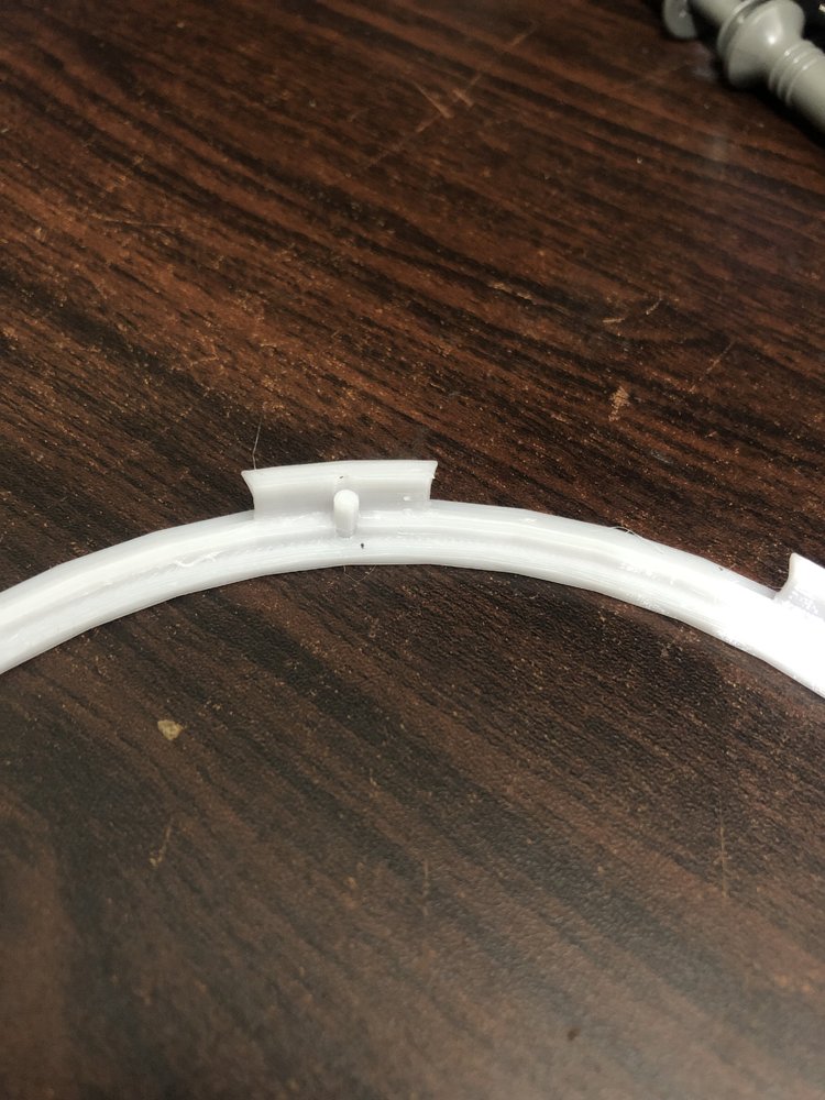

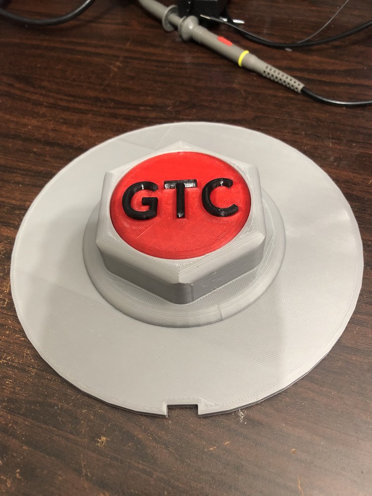

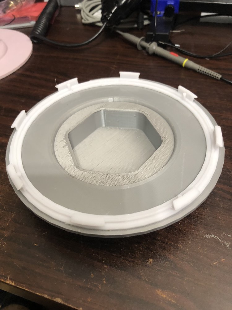

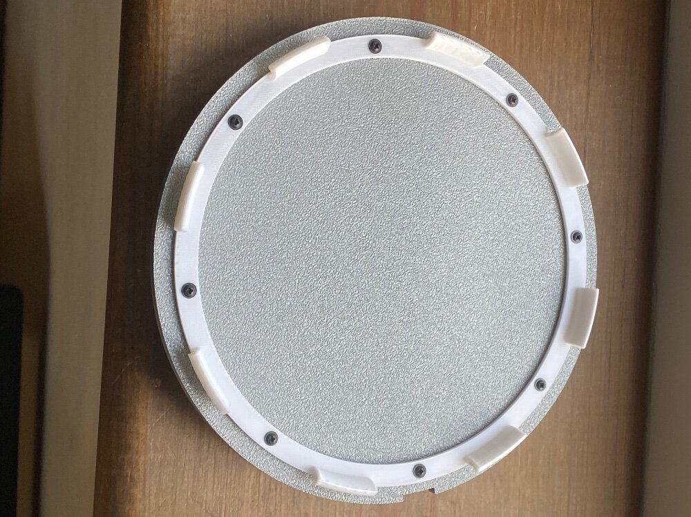

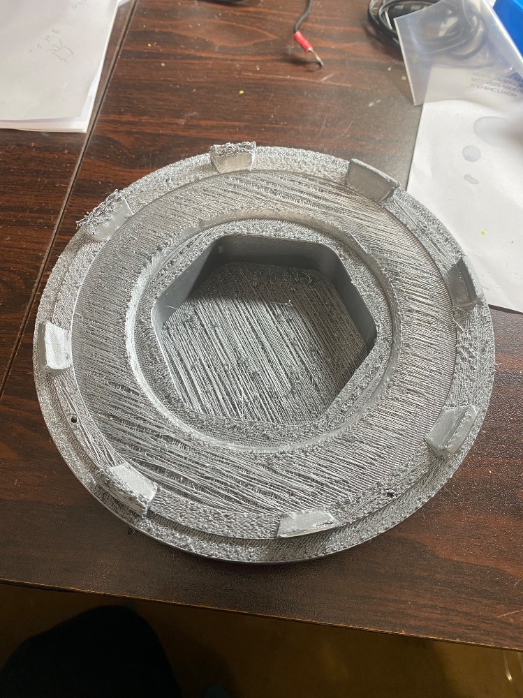

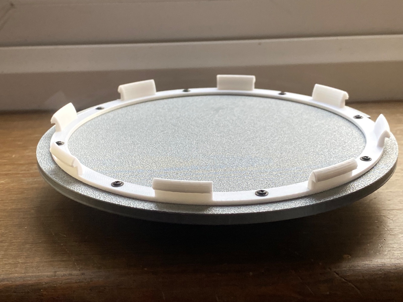

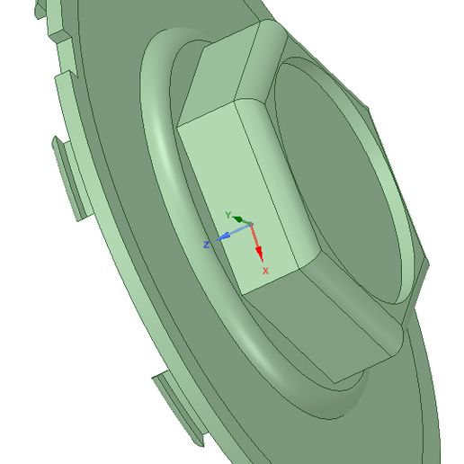

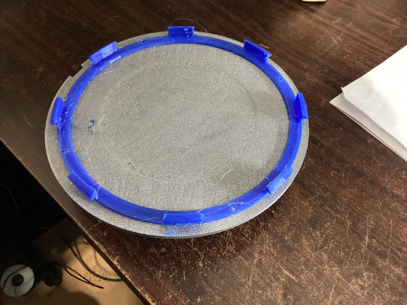

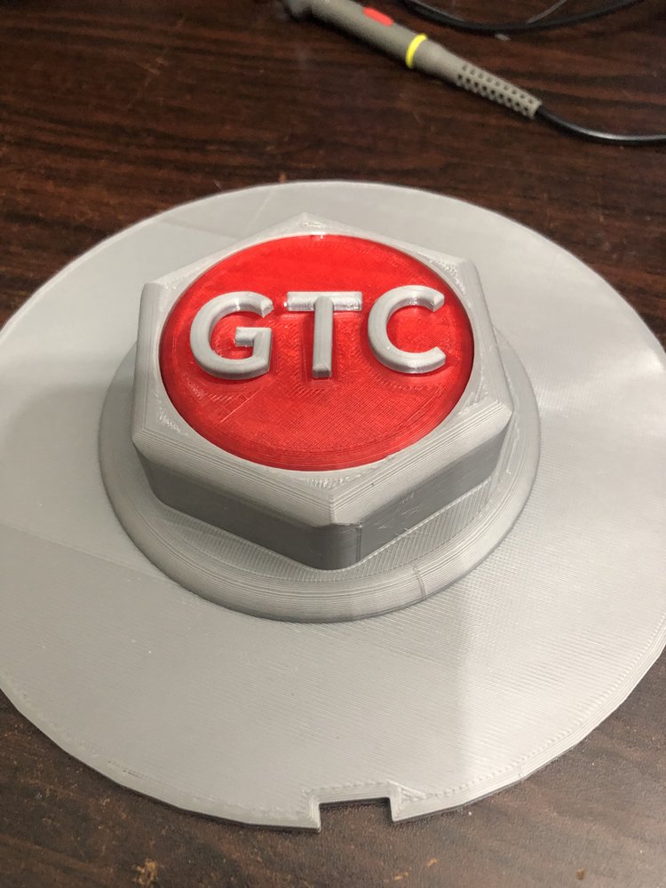

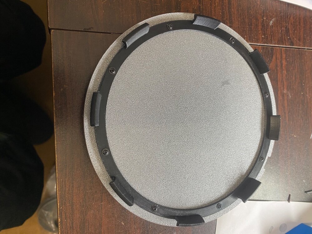

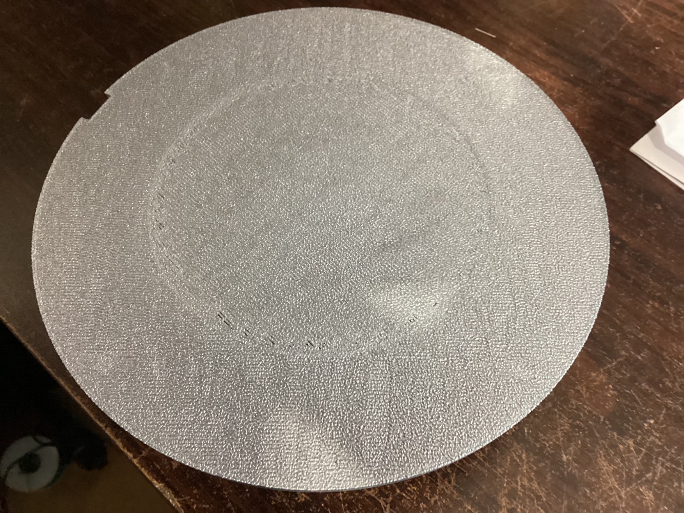

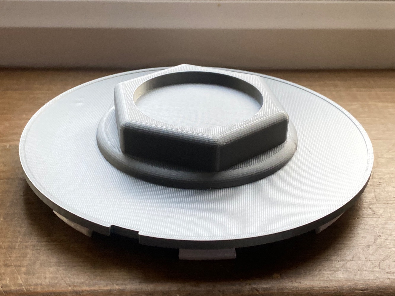

I am just playing with my design for replacement wheel centres for the Middlebridge Scimitar wheels. I have been having trouble trying to get a decent print on the fixing claws but a little lateral thinking sorted that out. Instead of printing it in one shot, I am now printing it without claws and fitting those afterwards by means of alignment pins and adhesive. The other great benefit of that is that if the claws are removed from an original, my claw ring can be fitted in their stead to prevent them falling off.

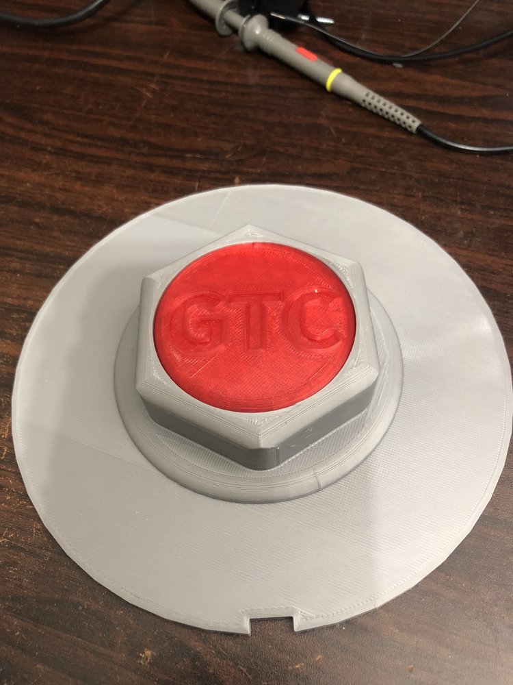

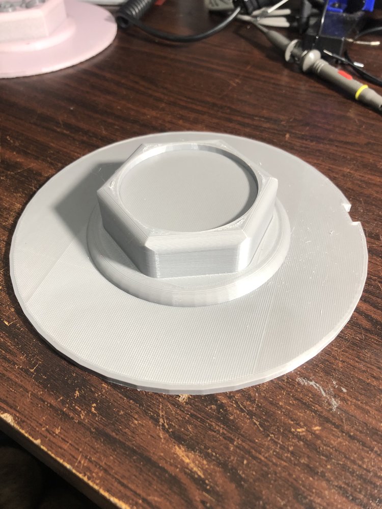

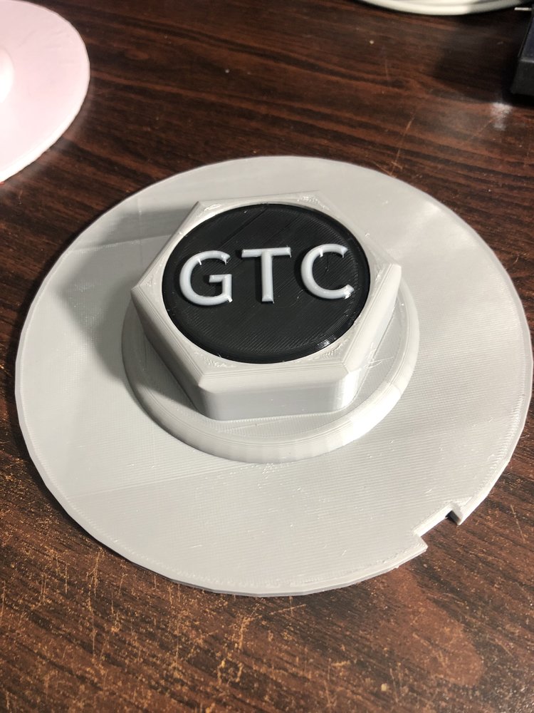

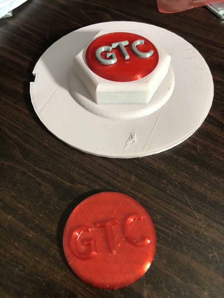

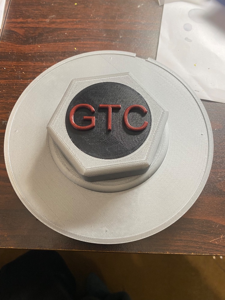

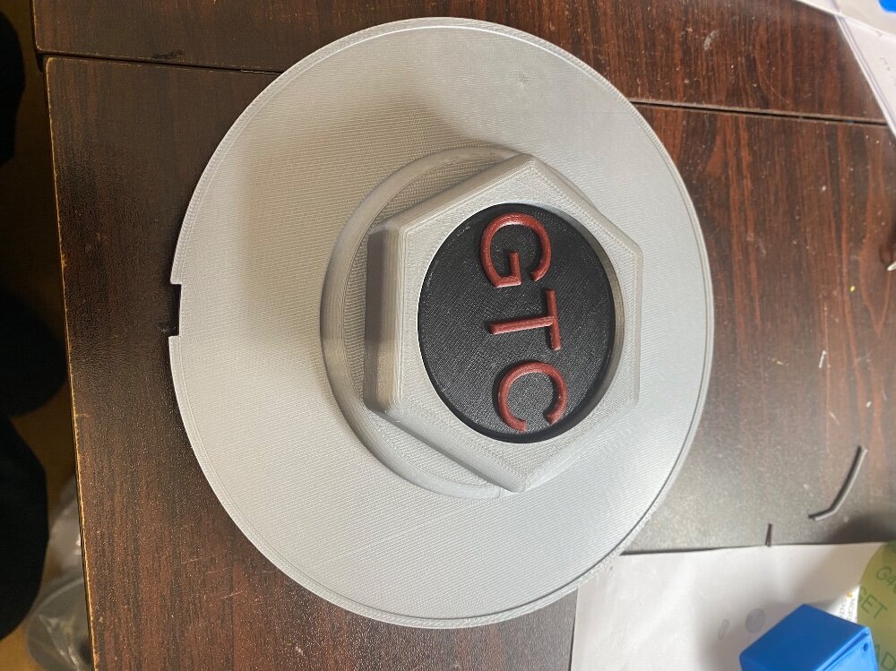

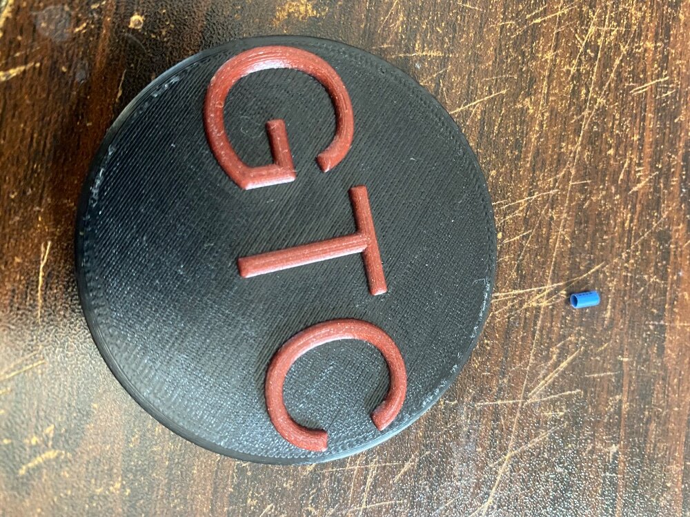

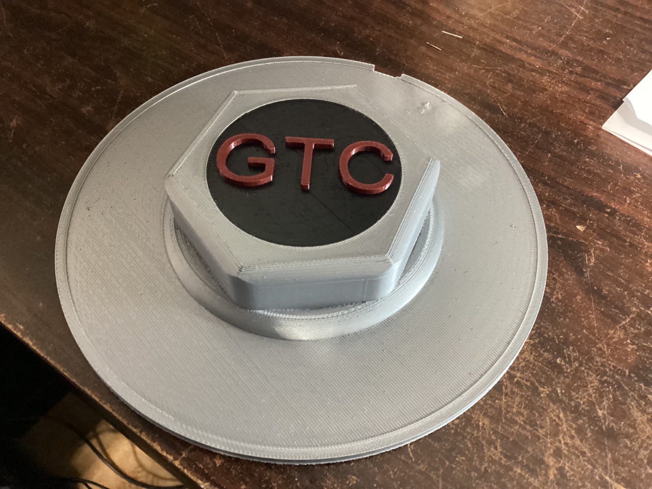

Badge wise, I did look into the resin dome type but wasn't going to pay what a small quantity required so I have also been playing with different iterations of that to suit my GTC. The option is there to fit whatever is desired into the well of course.
These are very much Mk1 prototypes so still some work to do before they can be released out into the wild...
