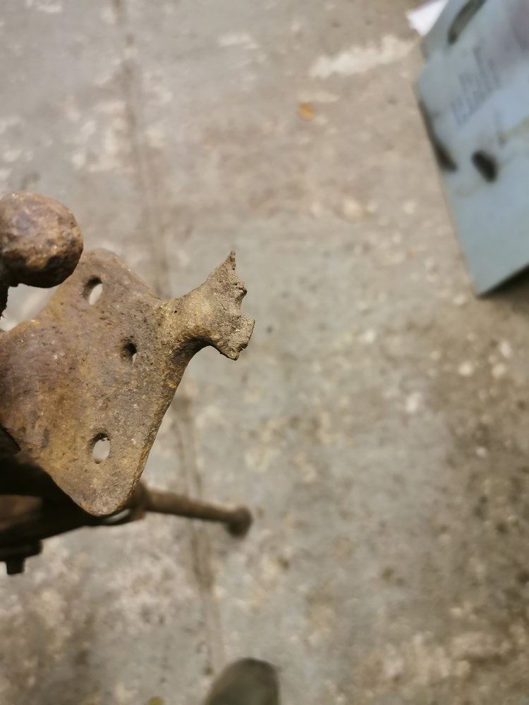

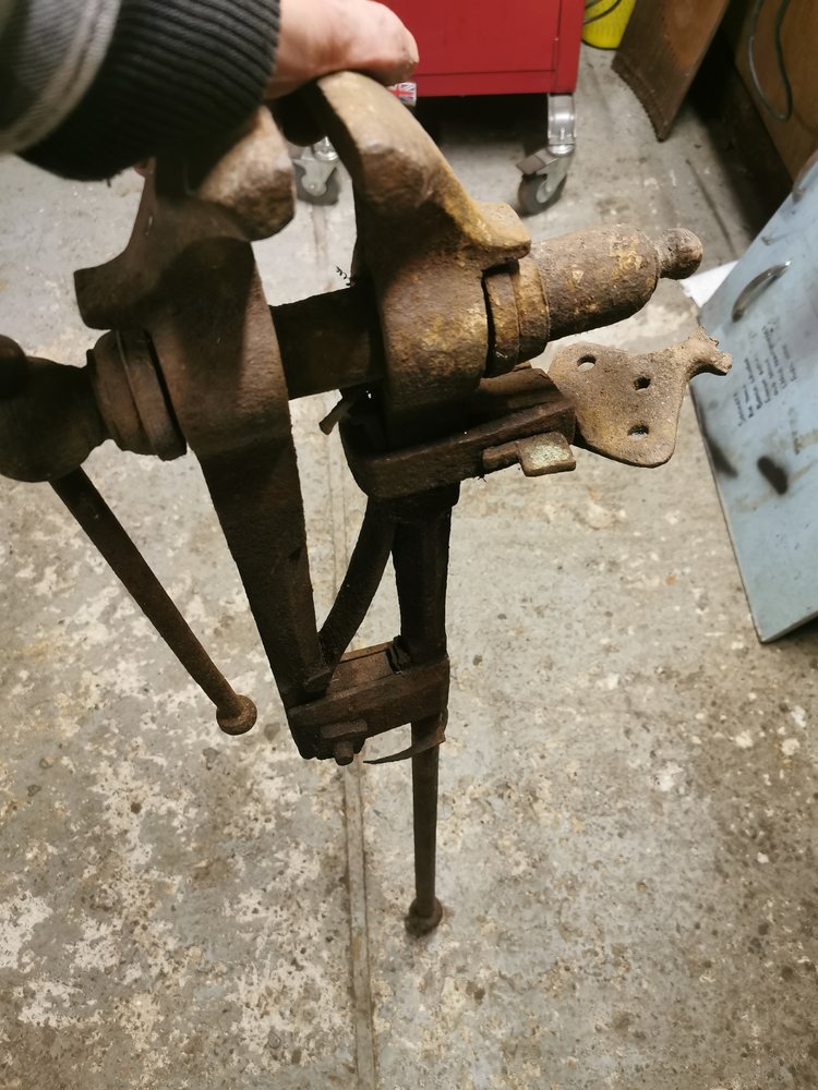

M many_methods Member Messages 91 Location Croydon, UK Nov 25, 2024 #1 Hi all I'm wanting to make a new end for this bracket and then, of course, weld it back on. Would this be steel or cast iron does anyone know? TIA
D dave h 2 Member Messages 1,046 Location West mids England Nov 25, 2024 #2 Might be wrought iron lots of flaky layers that may not weld. Leg vices are OLD.
Pond frog Member Messages 553 Location Warwickshire uk Nov 25, 2024 #3 I’m not sure if it’s worth the effort, there are three holes already on the bracket that should suffice. I think I would just cut the end bit off and neaten it up
C carbonarc Member Messages 198 Location Southport UK Nov 25, 2024 #4 Hi many_methods a grinding test on the vice material will provide information on its nature. Check on internet for full details.
The_Yellow_Ardvark I'm a citizen of Legoland travellin' incommunicado Messages 20,403 Location Going Away. Nov 25, 2024 #5 Don't weld it. Make a new part and braze it on.
M many_methods Member Messages 91 Location Croydon, UK Nov 25, 2024 #6 Thanks, all helpful responses. Agree it doesn't necessarily need it added back on, just fancied giving it a try. Cheers
pedrobedro Man at Matalan Messages 13,134 Location CX near Chesterfield Nov 26, 2024 #7 Bolt a strap to it to hold it on.
