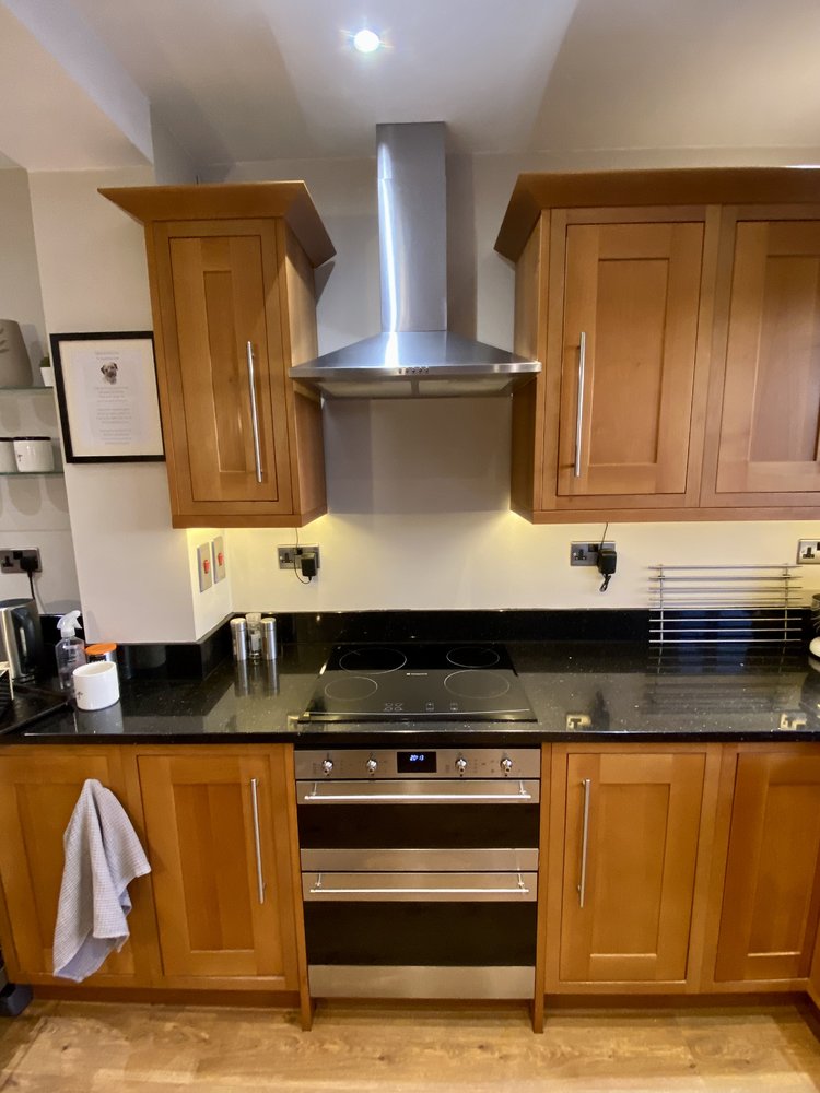

And put's the grease & smoke into the next county.....It could now probably suck a golf ball through a hose pipe, costs less to run and is a lot quieter.
That's a good idea using an in line fan, I've recently purchased two 150 mm Chinese ones . One is in place as a wet room extractor sucking in from two points via 110 mm soil waste pipe Elbows & a Y connection in the wet room set in the roof void . The other fan is a spare as they are easily interchangeable should/ when the in use one fails .The useless on/off/speed touch controls went faulty on ours and the manufacturer said it was obsolete.

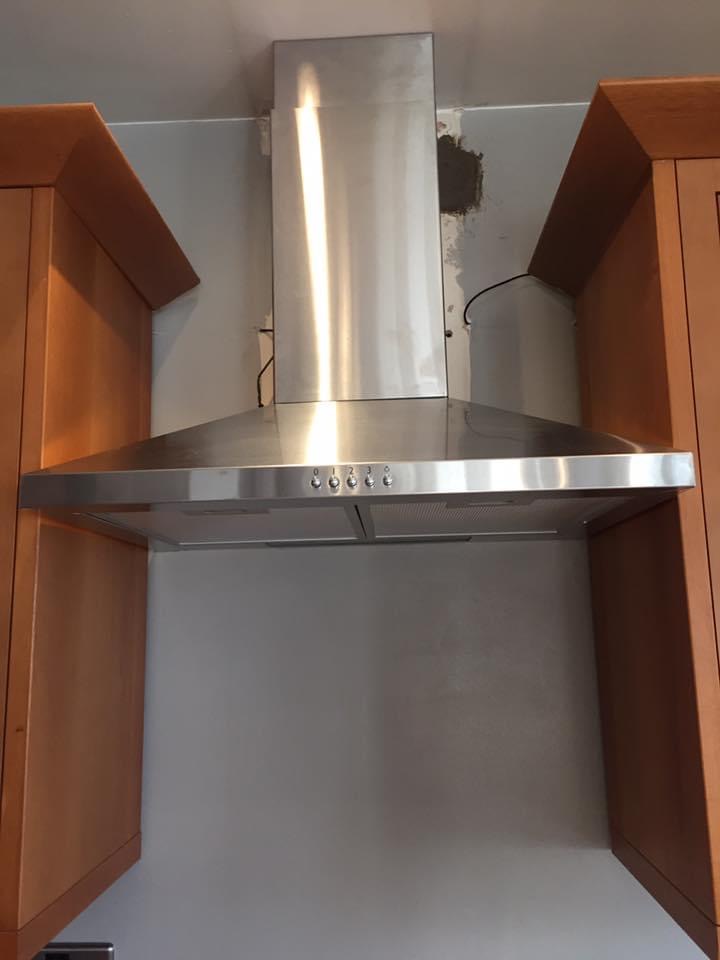

But we liked the overall design. So I gutted it of all the gubbins including motor, enlarged the extraction hole in the wall from 4" to 6", fitted an inline 6" fan on the other side of the wall, and a separate on/off switch and speed control. I threw away the expensive to run halogen spots, fitted a 12v transformer and LED spots along with a new switch.

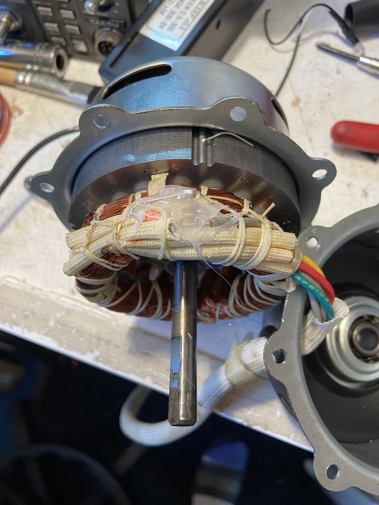

Rutt Roh, that looks exactly like the one I put in 2 years ago....Just been having a look through my photos. The old one lasted 6 years which is fair do’s really it was only a cheap one
