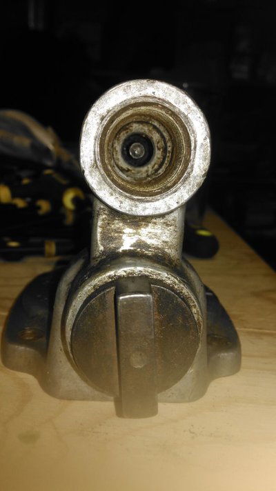

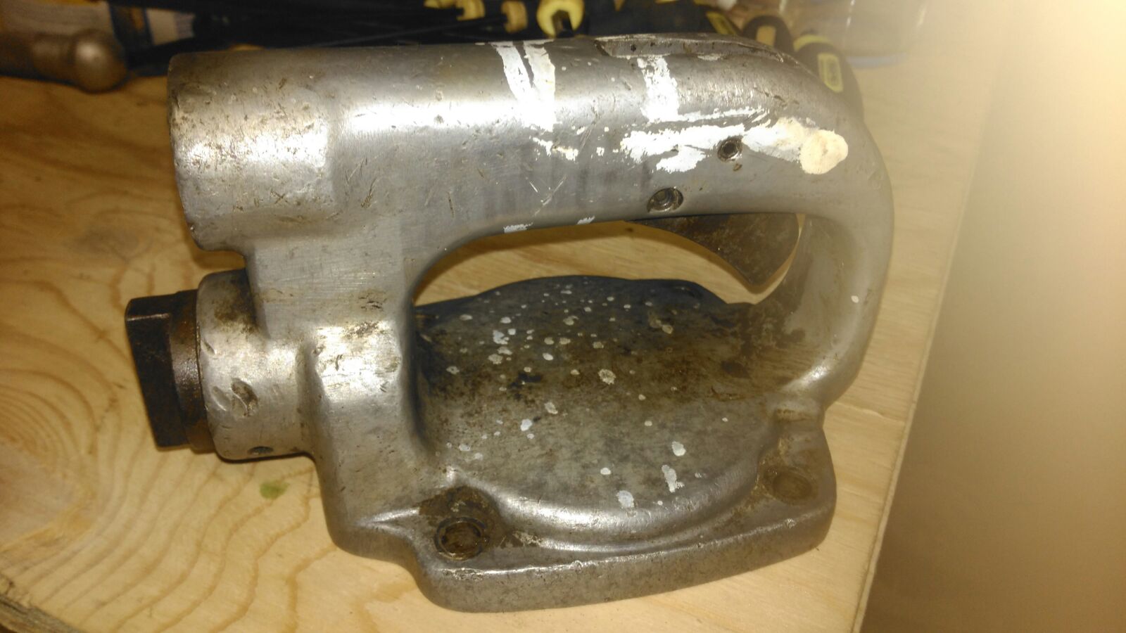

Works fine but there is no trigger as such it just flops about and doesn't stop the airflow atall
Only way to stop it is to unplug
Upon taking it apart a load of leathery sort of crumbly bits were found where i reckon the sealing washer originally was
As can be seen in the pictures the centre pin is operated by the trigger which pushes whatever seal away from it's seat and it is then returned by a spring pushing on this seal from the opposite side when the triggers released
Question is what is this seal meant to be as can't seem to find it as a spare part not even in america!!
Rubber??
Leather??
Metal and rubber??
Think whatever it's meant to be will have to be homemade now
