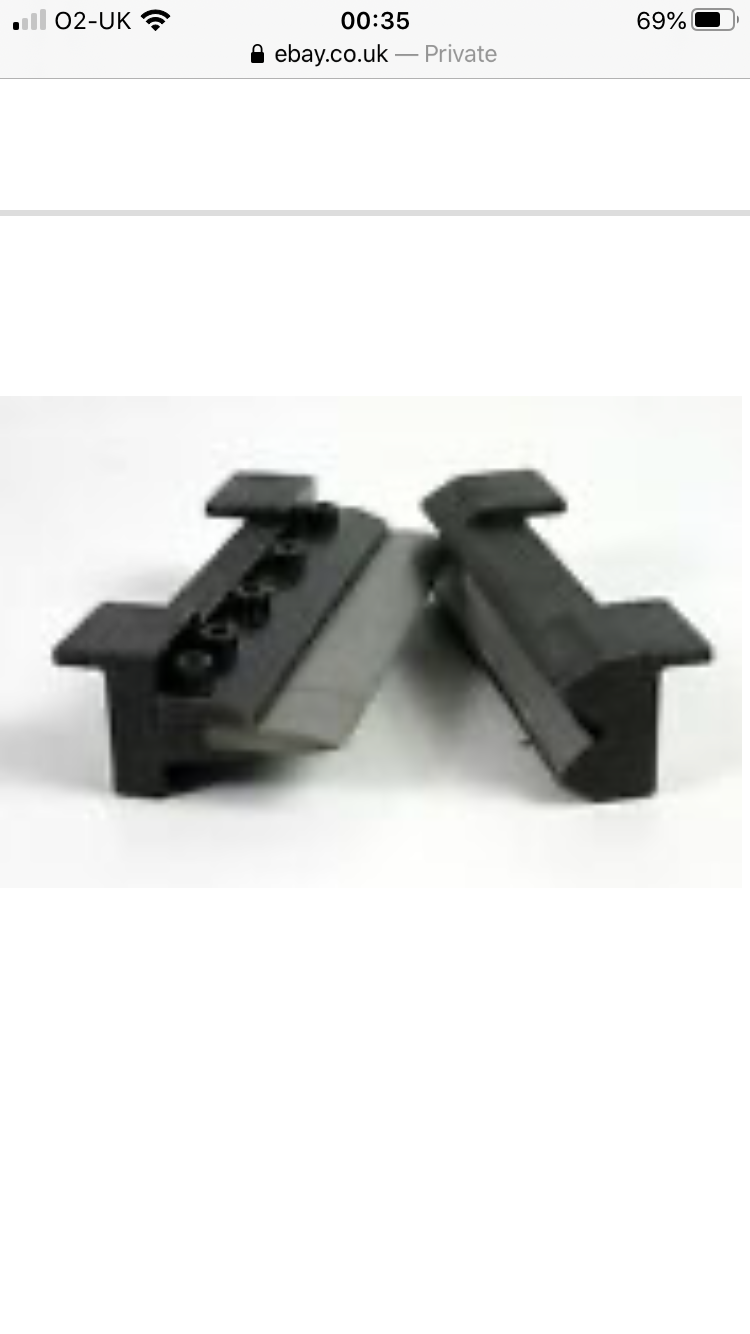

Jlg Member Messages 2,592 Location Cumbria Jul 9, 2020 #1 Does anyone know what this stuff is called need some for my press for bending some sheet E3A4FD08-250E-4E0B-9A3A-0BB38651805D.png 755.5 KB · Views: 60
S seanc Member Messages 282 Jul 9, 2020 #2 go under a few names search for, vice mounted press brake or vice brake

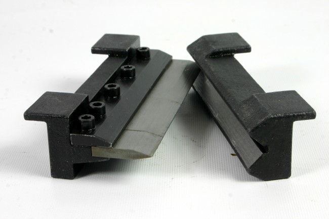

cheb Member Messages 3,887 Location Ostdeutschland Jul 9, 2020 #4 https://www.axminstertools.com/axminster-adjustable-vice-jaw-bender-150mm-310013 I've got one of those and it'll bend 2mm steel well enough.

Jay1st AdeptusMechanicus wanna be. Messages 296 Location South West FRANCE Jul 9, 2020 #5 brake press dies, and they have a vice adapter on so it's a Brake Die Vice

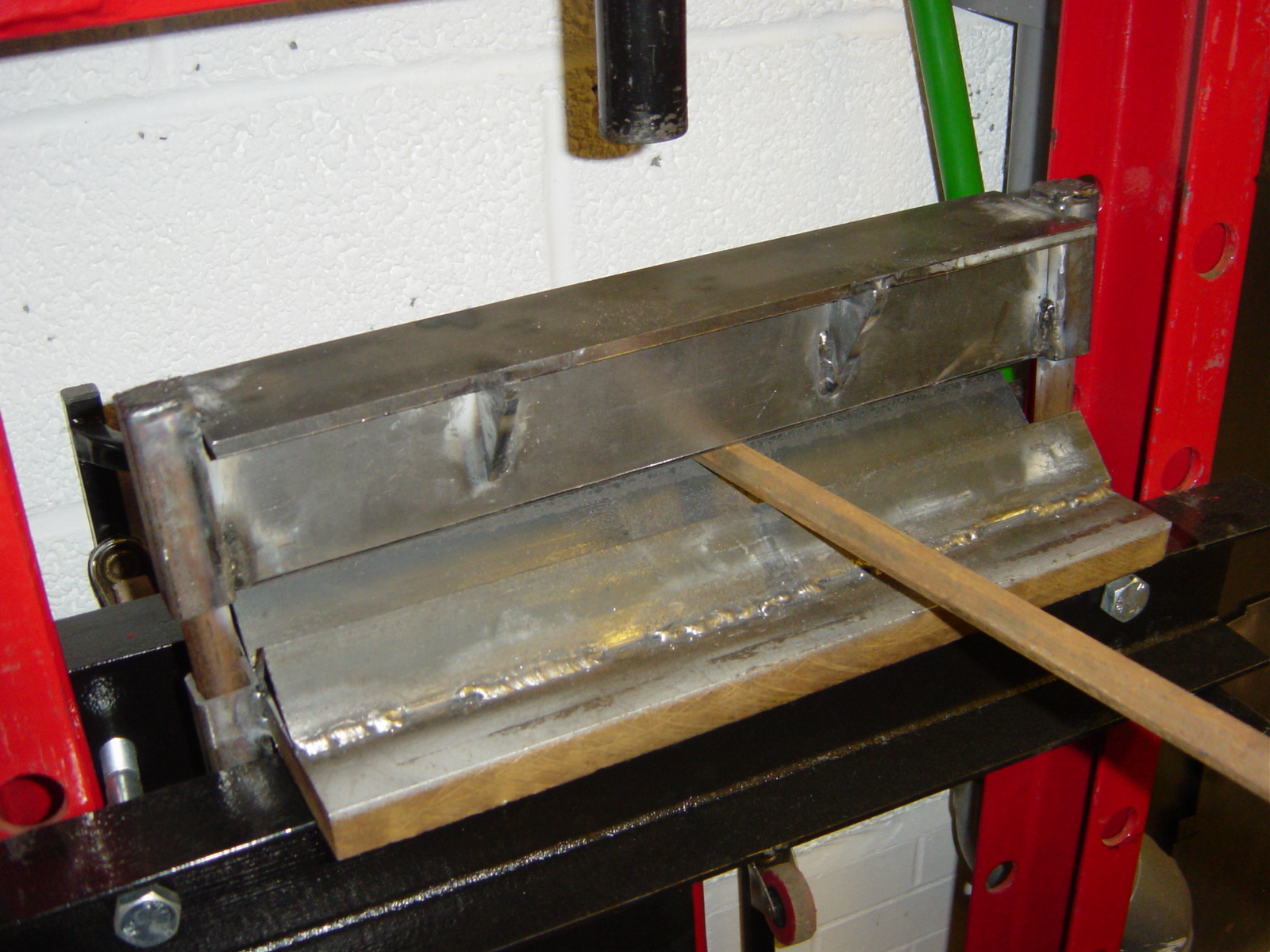

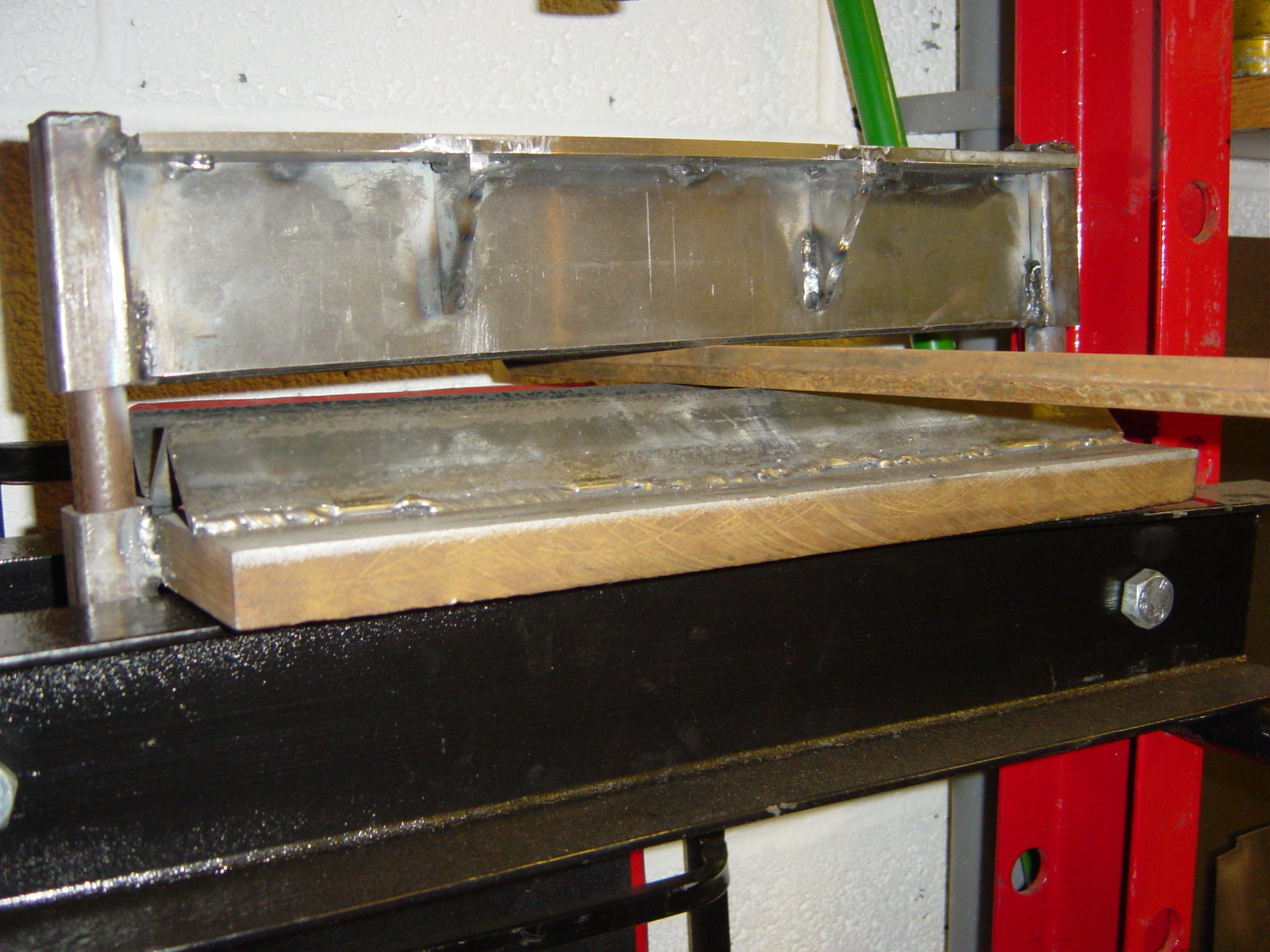

M MoreWellie Forum Supporter Messages 1,912 Location Warwickshire, UK Jul 9, 2020 #6 Jlg said: need some for my press for bending some sheet Click to expand... I just used some 6mm plate and an angle grinder to form the edge DSC07344.JPG 820.3 KB · Views: 57
Jay1st AdeptusMechanicus wanna be. Messages 296 Location South West FRANCE Jul 9, 2020 #7 i should have a file with a die drawing, you cut the number of plates you need with a plasma and stack them for welding them in a single die piece
