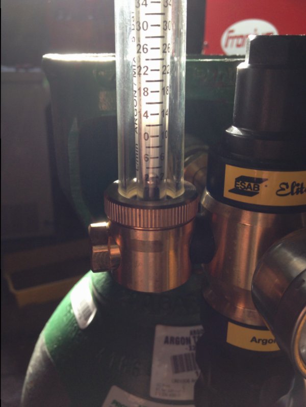

Well it's for a bit of both really. The collet body is as you know very acceptable for Alu. The lens does offer a more evenly distributed gas flow direct onto the pool so it can only improve things further. I pay for my own gas so the biggest advantage for me is the saving as I've dropped my consistent usage to over 1lpm. I've not had contamination issues with a collet body set up on Alu before but to achieve the same results I've had to have higher flow rates.
I'm in the very same boat, i work for myself also, so i know every LPM counts! i wont however scrounge on gas in favour of quality on any job.
it was just to illustrate that clean beads are possible with an R-tech.
