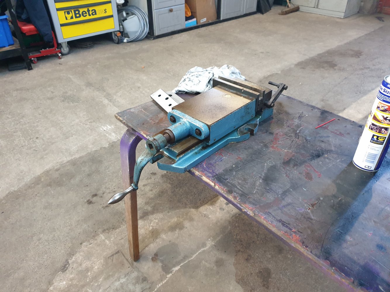

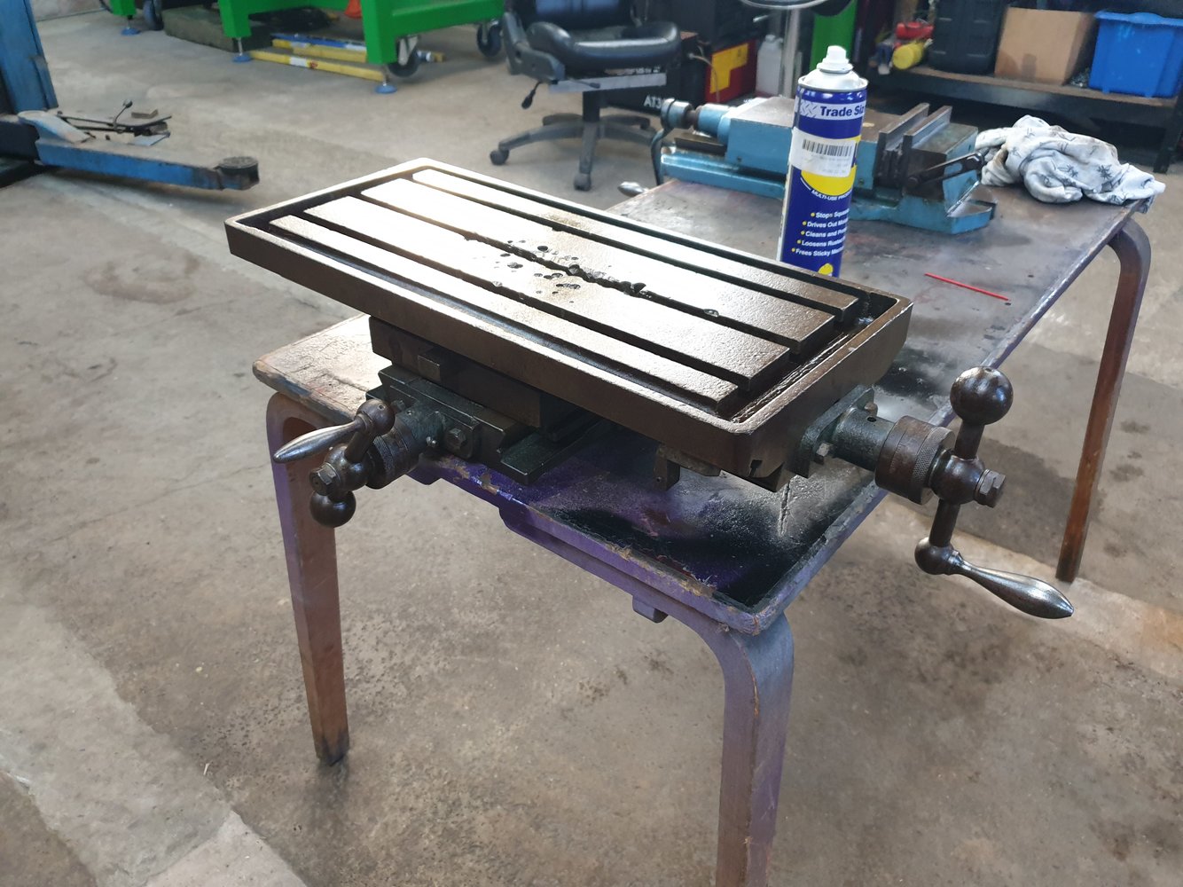

I can't comment on how they compare, but I've got one of the machine mart ones sitting on the parcel shelf in the hallway waiting for me to get round to photographing it & sticking it on the for sale forum section.So are the Machine mart Clarke xy vice which are around £60 any better than the £25 ones on ebay?
No, I just haven't used it since buying a milling machine.was it that bad?
Do you want to sell?
I've just posted it in the For Sale section with as many pictures as I was allowed to attach. I've said in the listing that you can have first refusal if the moderators allow it (I was too lazy to check the selling rules) as you're the one that made me pull my finger out and get it listed! It'll hopefully appear sometime soon once the moderators have reviewed the listing.thanks
