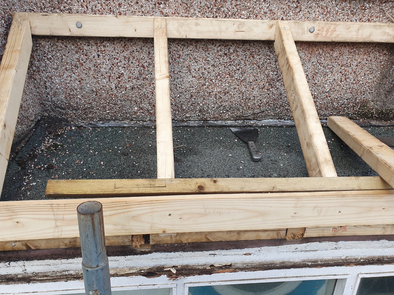

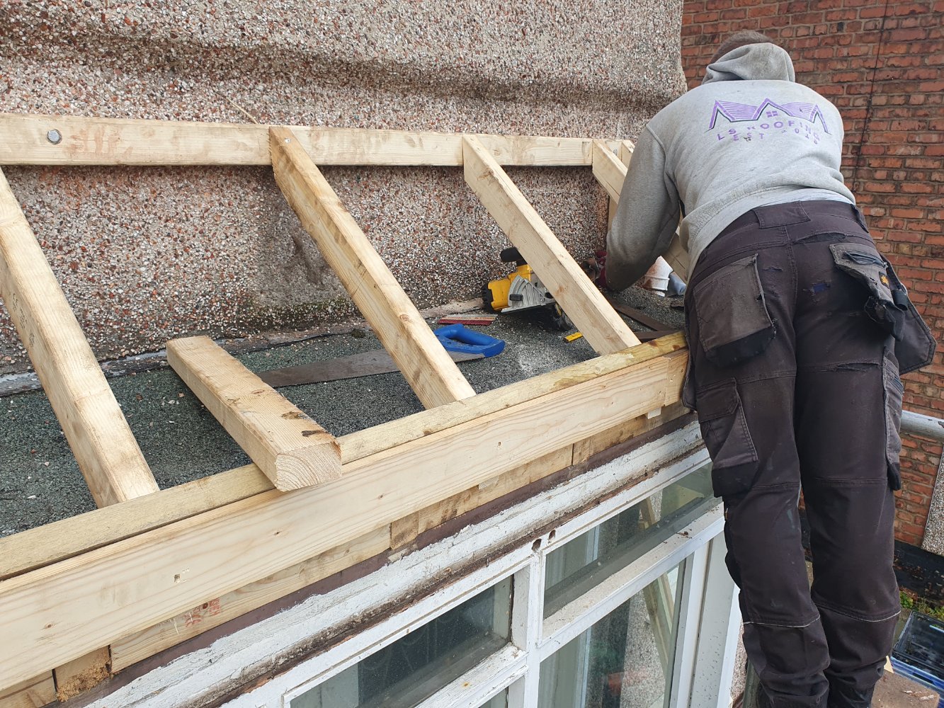

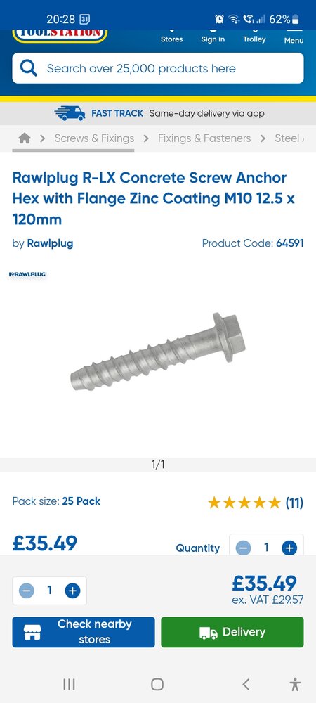

If the brick work is old and liable to split/ crumble use Fischer chemical anchoring and lengths of studding /all thread , so you get a stress free anchor in the brick .When I battened the wall of an outbuilding I was recommended to use Fischer frame fixings. Drilled through the wood & straight into the wall in one go.
Not if the bricks were laid properly with the frog upwards and filled with mortar .
