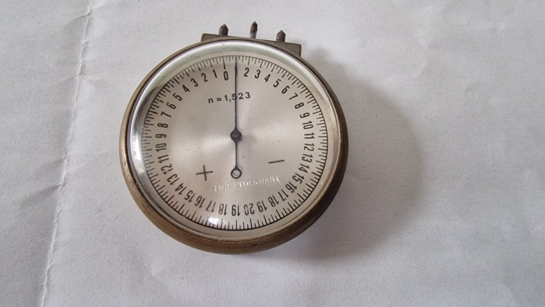

Have used something similar in the dim past called a spherometer. Used to measure the curvature of a surface.
It's a 'Lens Clock' apparently
Well spotted - a quick squirt of WD40 and it is back on zero. The bezel doesn't turn or anything like on a dti.The one in the link shows 20 (not sure if it is plus or minus 20) in its relaxed state. Fizzy's one shows -1. Could his one be gummed up?
I am guessing zero is with all three points co-linear.
The German one increases anticlockwise; the linked one increases clockwise.
Perhaps I could turn it into the worlds most useless watch
Yes anti clockwise!Yes, zero should be with the probe and points against a flat surface. If there is any adjustment, it would be to set this contition, I think.
I think the sign convention *should* be +ve for a convex face. If so, the needle on Fizzy's will turn anticlockwise as the plunger goes in. (I could easily be wrong though.)
