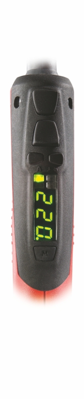

Wow it does look bulky but I suppose with a display and all those buttons it needs to be to fit all the gubbins in there. Bet they cost a fortune to order separately.I had almost forgotten about my Lorch I torch that I ordered with my new tig set.

To look at it looks a tad bulky.
In the hand. Well let's just say lorch did a fabulous job.
It sits so well between fingers.
It's super flexible.
Only down side is it is a ridged head
It's difficult to see but the water pipes look like over braided flex which is a rare thing on OE torches and a nice touch. The Kemppi torch although looks a little less cumbersome on the handle was fitted with quite stiff cables. Not sure which way Id go if I could only chose one. Flex cables or smaller handgrip![]()
