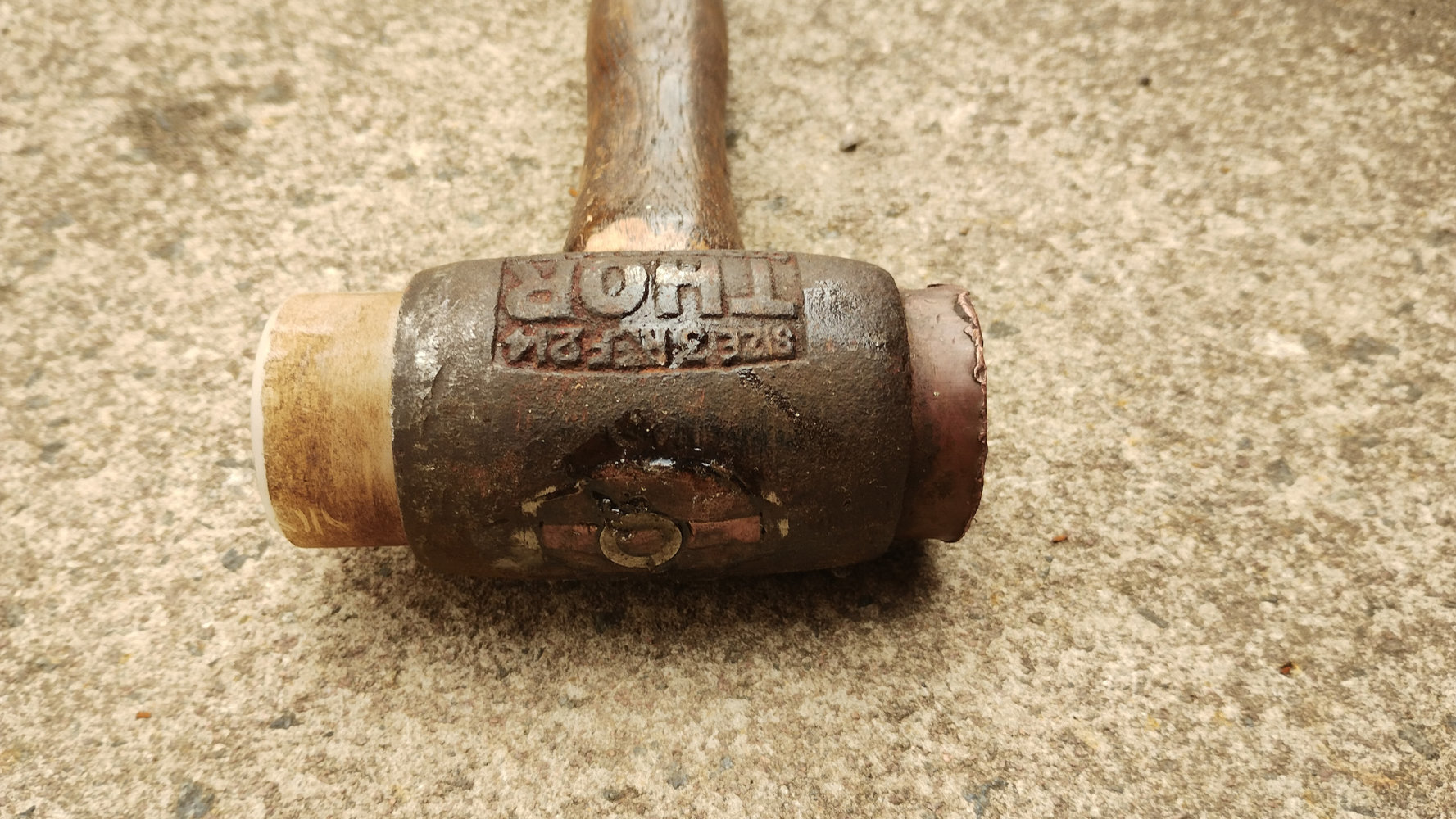

The sockets in the head are different or hide and copper, they sell plastic faces but I don't know if they suit the copper or hide socket.

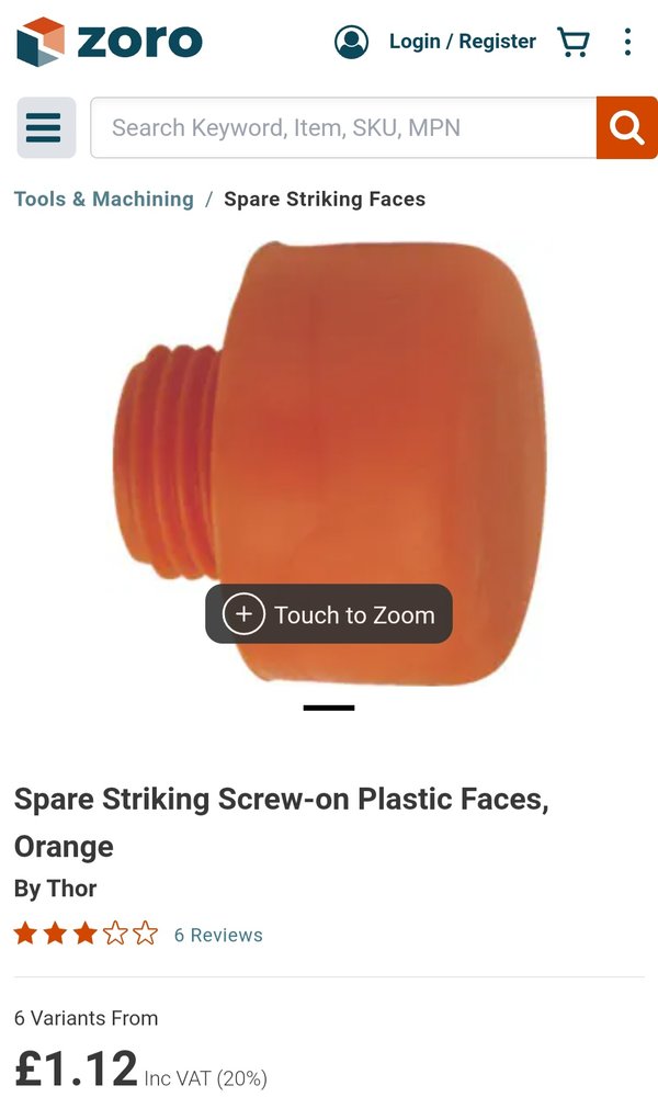

The plastic are screw on faces, are they not?
This type, I do have a replacement plastic face direct from Thor for a 3lb copper hide hammer I was given with a broken handle and worn out hide, definitely no screw threads on the plastic face, I'm going to make it fit in place of the hide even though I'm not sure it is the correct side.The plastic are screw on faces, are they not?

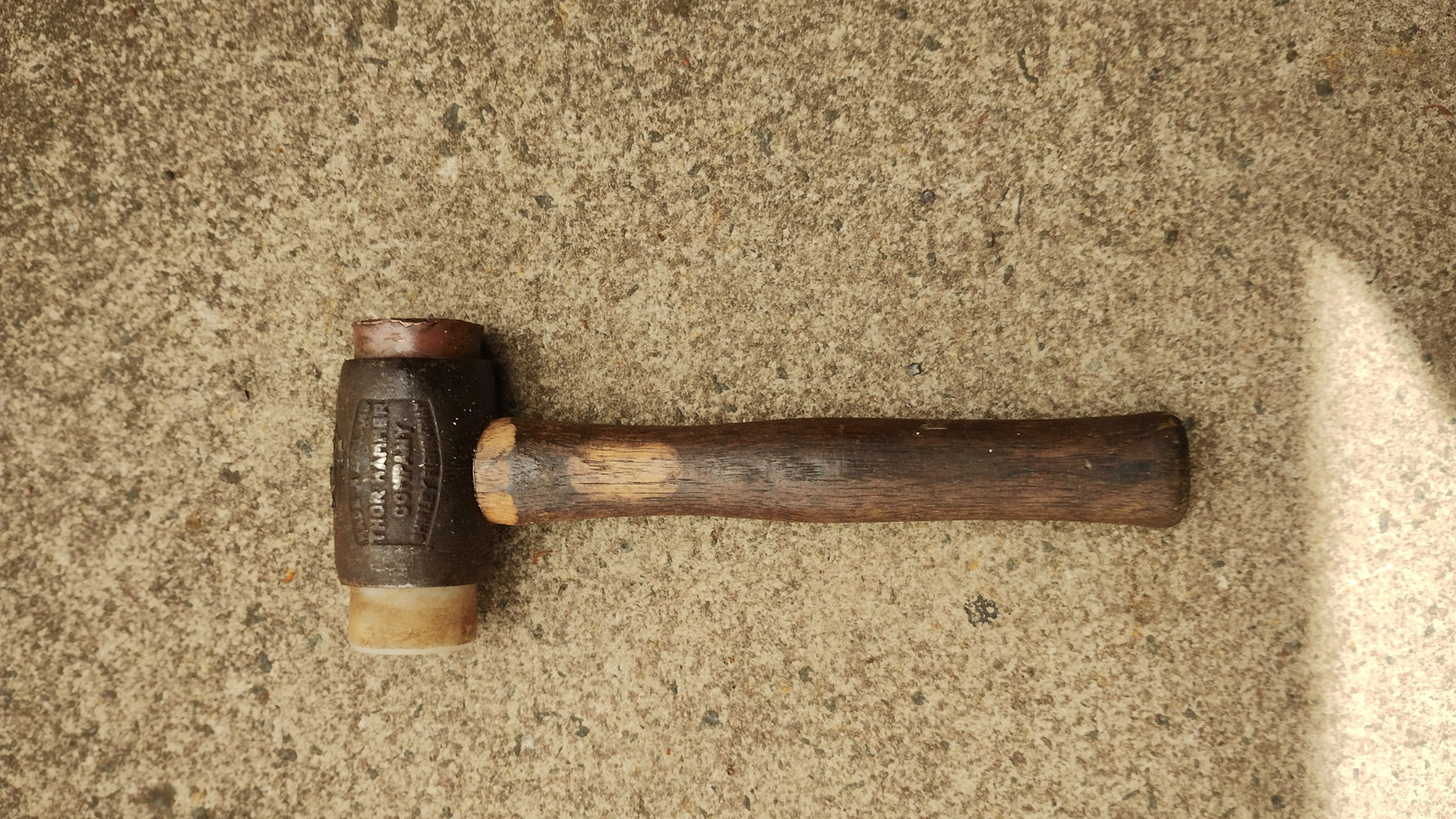

i popped the leather in a cup of water for a few minutes and got the gorilla glue out spread a bit round the socket and then put the leather face in the glue goes off real good when the surfaces are wet stuck it in the vice with a bit of pressure and 3 hours later solid as a rock

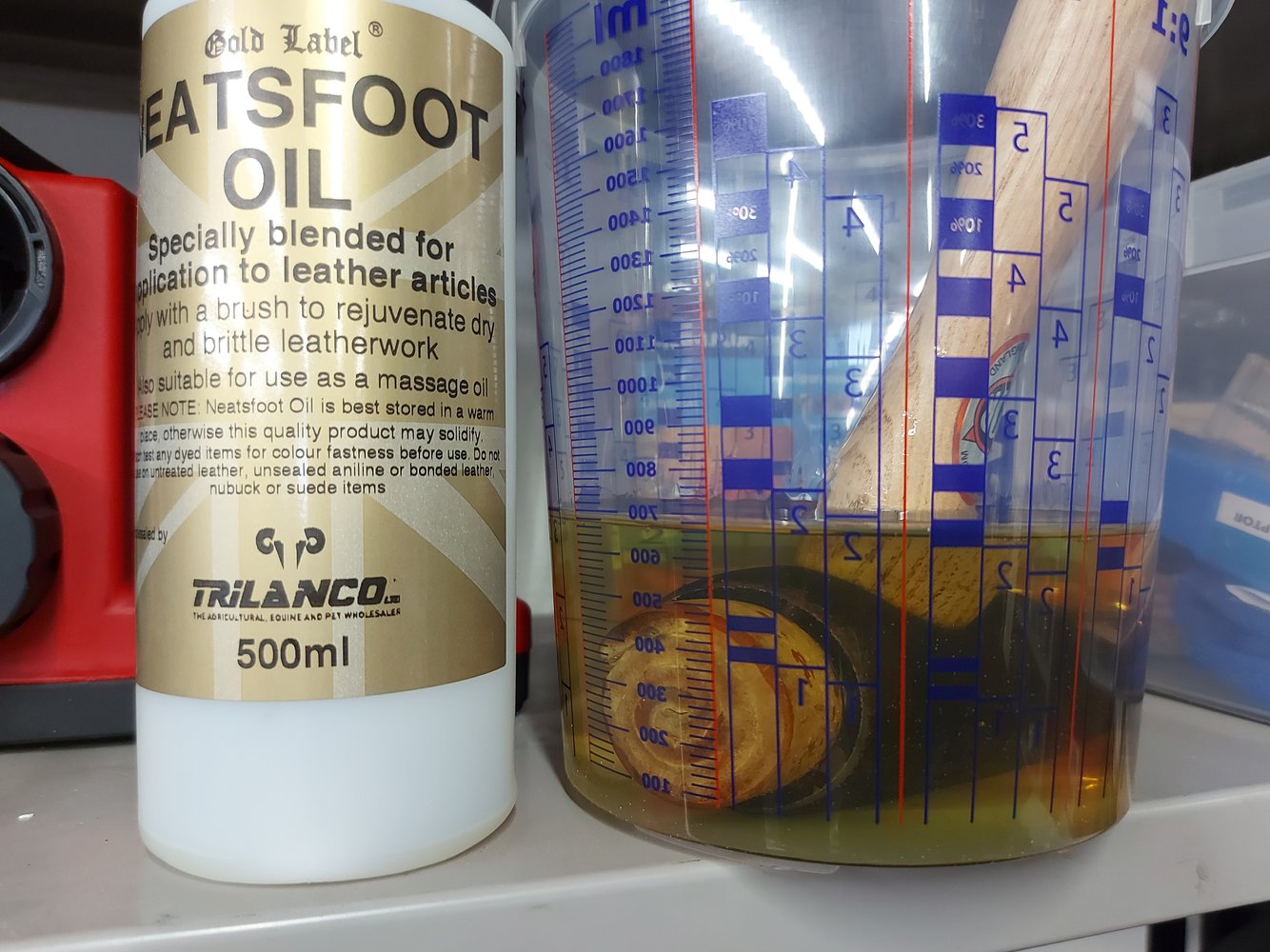

the leathers nice and soft again might put some leather oil on it as well or saddle soapmine took 5 minutesThe varnish was intact on the leather face. So I sanded that off with a flap wheel and bashed it on concrete for a bit.
No change still loosy goosey.
Hence its getting a 1 week spa
I will report back on findings in 1 week.
I will rebottle the oil of course.
my others getting the same treatment as wellOK I'll see what it's like tomorrow night. It really was dry dry dry.mine took 5 minutesmy others getting the same treatment as well
It replaces the hide part, well that's where i fitted the plastic head on my thor no3.
Do you need the tool shown on their website to fit a plastic head in. place of of a hide?
seemed too tight to just ram it in
