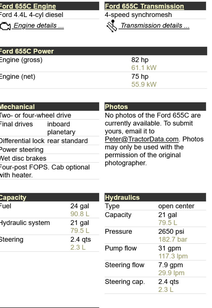

My 655C backhoe has a few leaks. One looks to be from the hydraulic oil cooler - not 100% sure yet as I need to clean it up and confirm the leak is there.
Anyway - got to thinking about replacing it and thought, 'well, its just an oil cooler, the machine isnt worked hard, surely any aftermarket one that can be made to fit will do... rather than the $800ish new ones seem to sell for?'
Then i started thinking a bit more and suspect it isnt that simple. The current cooler isnt like a normal radiator - with flat 'tubes' between the side tanks. It has a series of what look like 8mm (ish) diameter tubes that run between the side tanks - you can see it here - https://gulfsouthequip.com/product/ford-555-cd-cooler/ (and the price of new). I guess flow rate matters which may be why the tubes are 8mm rather than the flatter setup in a normal coolant rad? Anyone hazard a guess as to what the flow rate for a 655C backhoe would be?!
Can anyone suggest any aftermarket alternatives that dont break the bank?
Is it possible to recore these?
