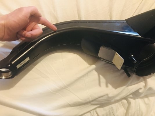

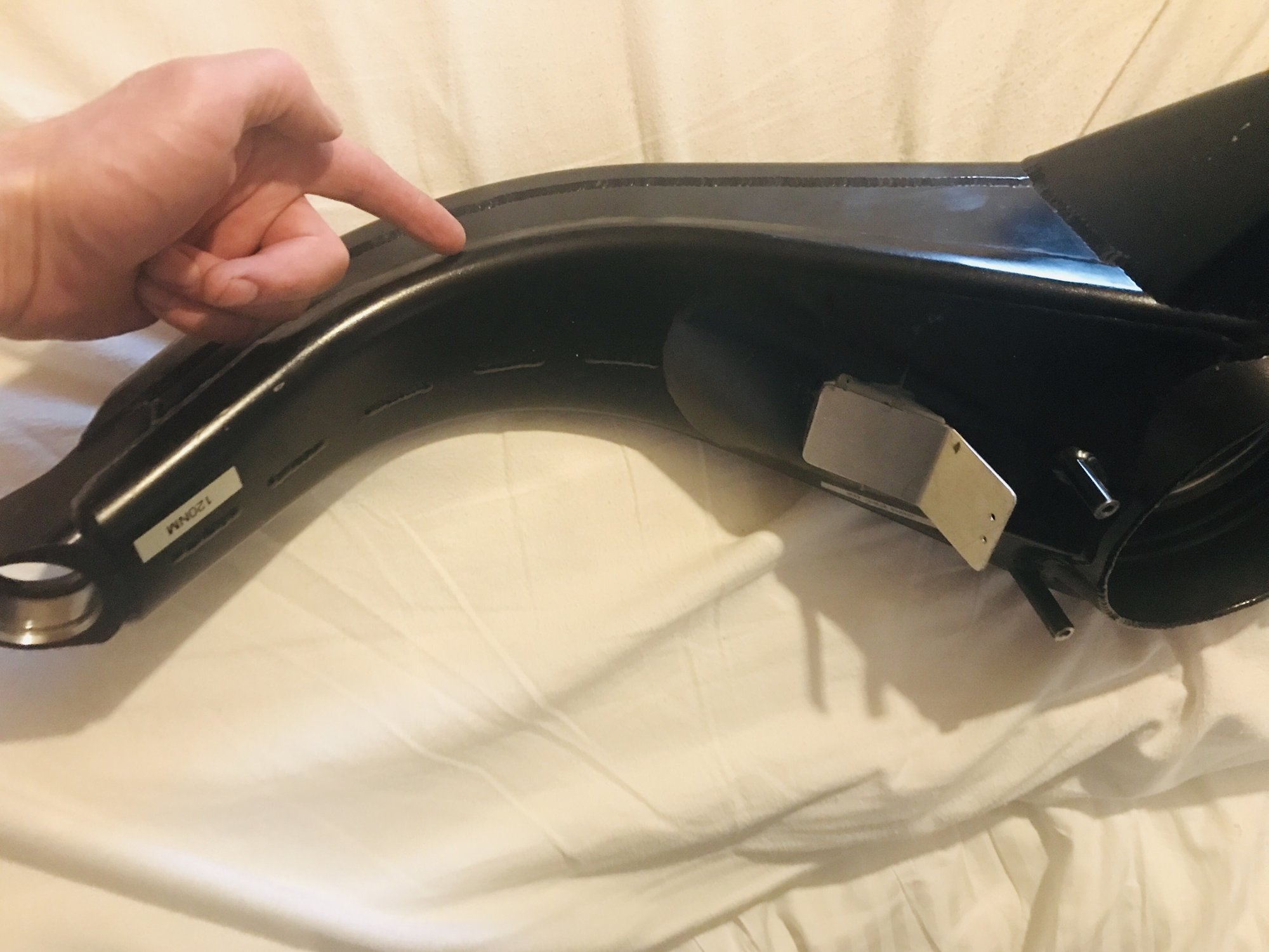

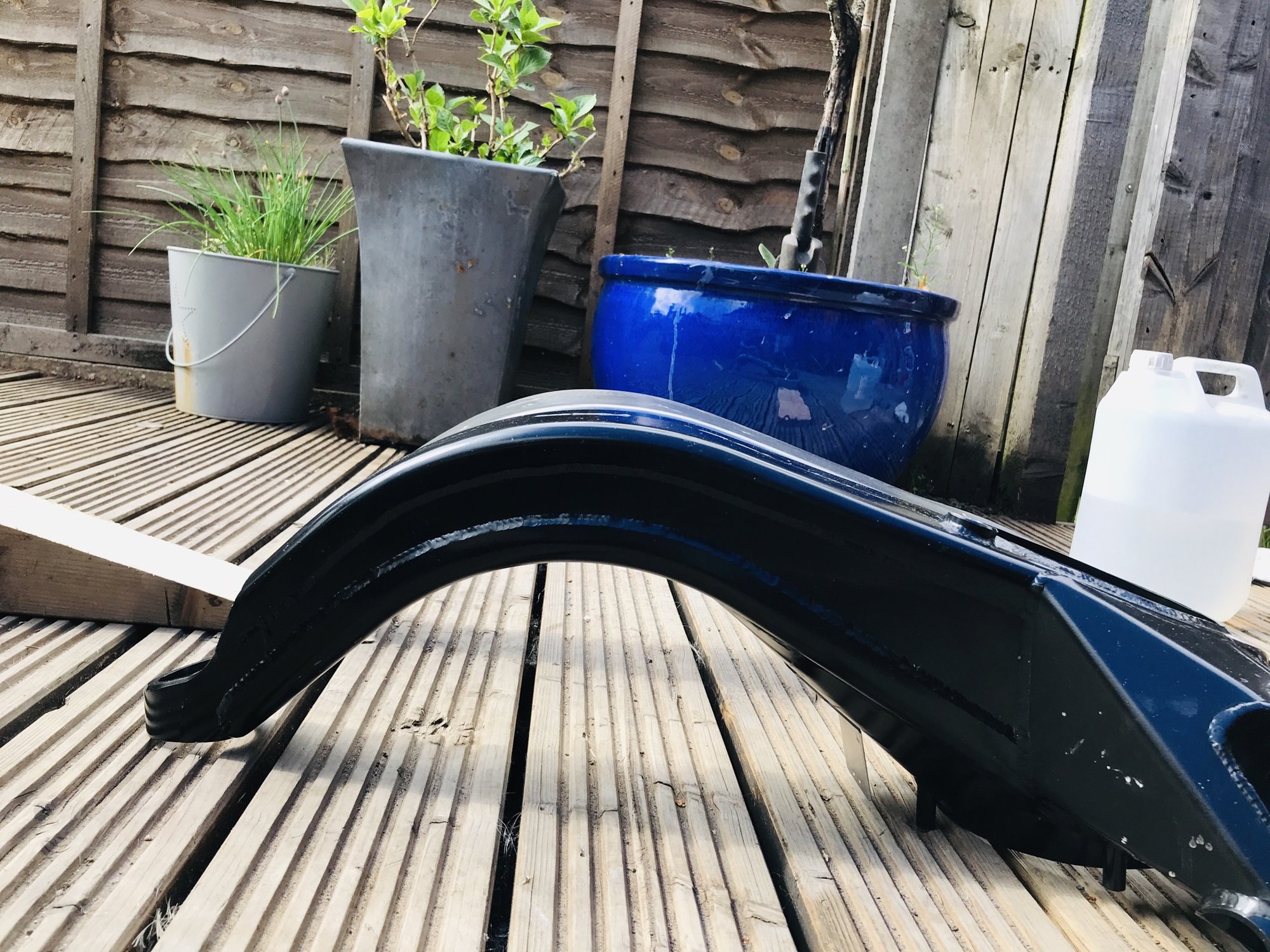

What tig welder would I need to re create this part

    As per the other replies, what you’d like to attempt is a mammoth task! Even working with 2mm steel is a lot more difficult that shaping body panels at 1mm (or less). I, like seemingly everybody else on here, am up for a challenge but sometimes you need to be realistic about what you can achieve with the skills, equipment and time at your disposal.
    If tubular arms aren’t allowed, I’d think about adapting something; how far out are the road car items? Even then, it’s obviously a safety critical part so you’ll need to be sure it’s done properly.

    You’re steel gonna have to be ChromeMoly and may need a heat treatment after welding.

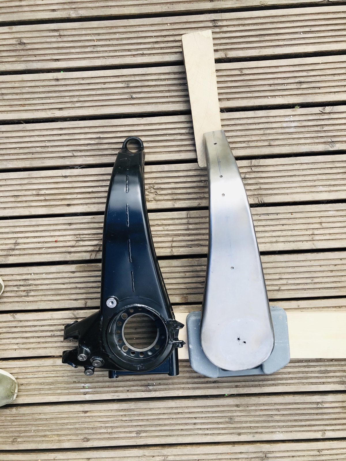

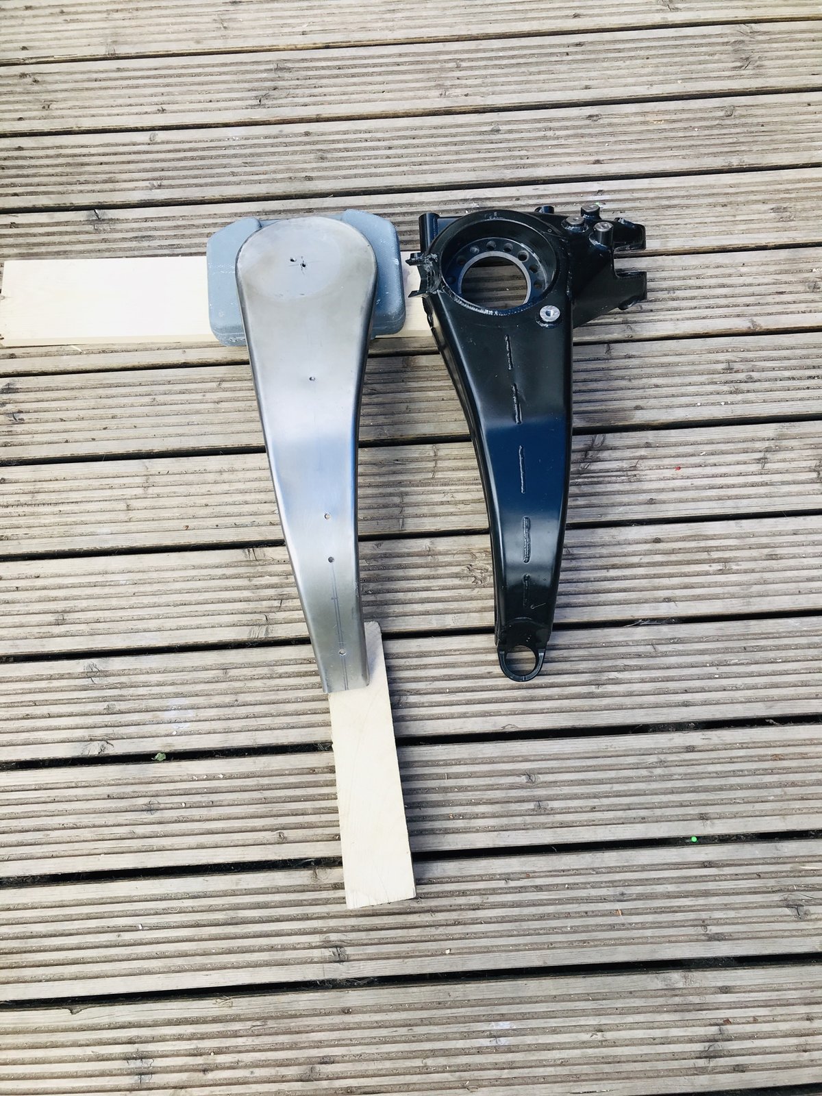

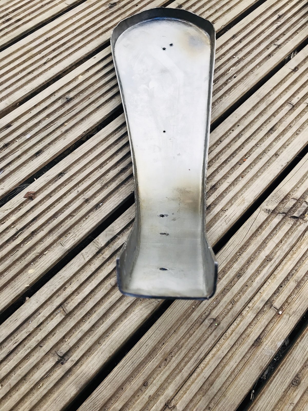

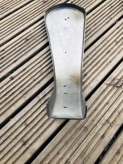

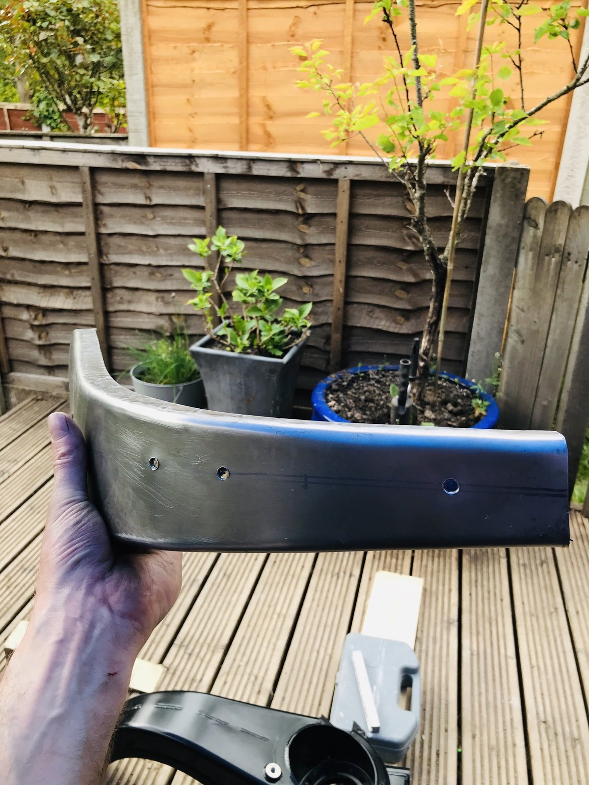

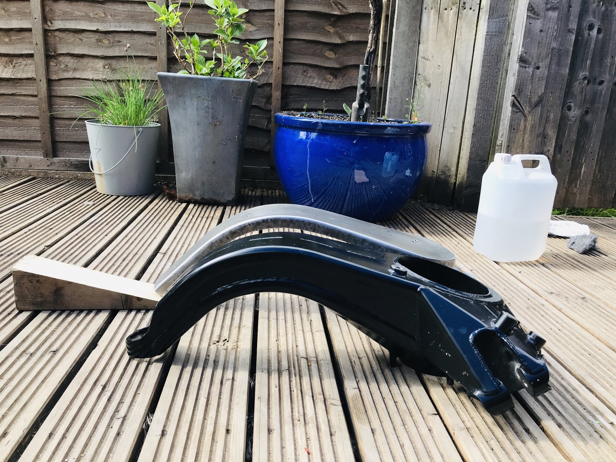

    Ok my first attempt at forming one of the curved 2mm pieces,I need to tidy the edges but a lot of hammering and two blisters later 6E182AC5-672A-41B8-BD79-2B3359B8AF66.jpeg 6529CE1E-EDE6-4144-8100-D0797387EDE7.jpeg A07C00CB-B08D-490B-8B39-EBD94117B861.jpeg C71FA79F-C832-4931-A962-5AF391165288.jpeg 6FFB6154-828A-428D-B0DD-EFF81003E57C.jpeg 099E07D0-FA3C-4905-866E-D51DB68BFF01.jpeg

    Oh, that's nice! I have a feeling we were all underestimating your abilities.
    Are you sure those parts are just mild steel, though? Like Brad says, it's likely to be chromoly if it's a bona fide GT3 part.

    I wouldn’t like to form that by hand in 4130. Would be easier to make in 2 parts.
    Nice work.

    That’s a good start, I suspect you have more experience than you first let on.... Did you tuck shrink the edges to form the curve? If so did you have to heat it?
    A couple of further questions if you don’t mind:
    1. What are you using as a form? Presumably something fairly durable!
    2. As good as it looks, are you confident that it will all be dimensionally accurate? I imagine you’re working to tight tolerances.
    Keep us updated with your progress. :thumbup:
    stuvy likes this.
  12. NathanO Member
    Messages:
    19
    Location:
    Midlands
    Yes , I had a shrinker/stretcher delivered yesterday just in time try it out , I was a bit sceptical to if it would work or not as working with a Shrinker designed for smaller gauge steel,no experience forming steel at all,I made a cardboard template of the original part and thenmade a forming block out of timber faced with 2x sheets of the 2mm steel,then with the same template added 20mm or so to the edges then clamped it to the block and dressed to metal over the form , I headed the steal mildly with a blow torch but not to hot as I didn’t what to get to much heat in to it .
    Im confident it will work but it’s early days, at the end of the day I know now I can form the shape which I was not sure would work with out heavy duty industrial bead rollers and shrinker/stretcher.
    Im going to make the internal curve pieces next , I’ll do a step by step on the next piece, which my be a few days off as the weathers crap and I’m stuck in the house decorating .
    I spoke to a guy yesterday at proformace metals in Daventry and they supply the motorsport industry,I may get a sheet of s515 and try to see if I can make it out of that which will make the part even stronger, don’t fancy trying chrome moly as you have to pre heat before tig welding and heat treat after from what I can gather.
    willie.macleod, SierraV6 and Shox Dr like this.

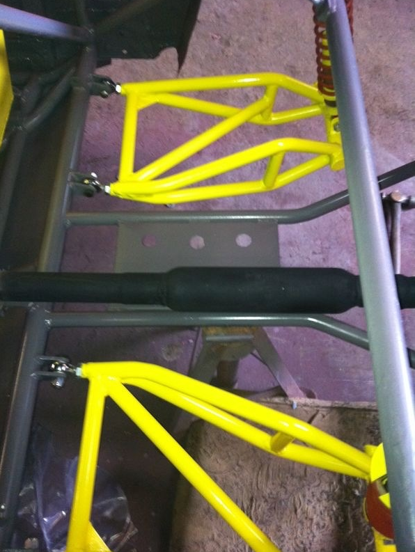

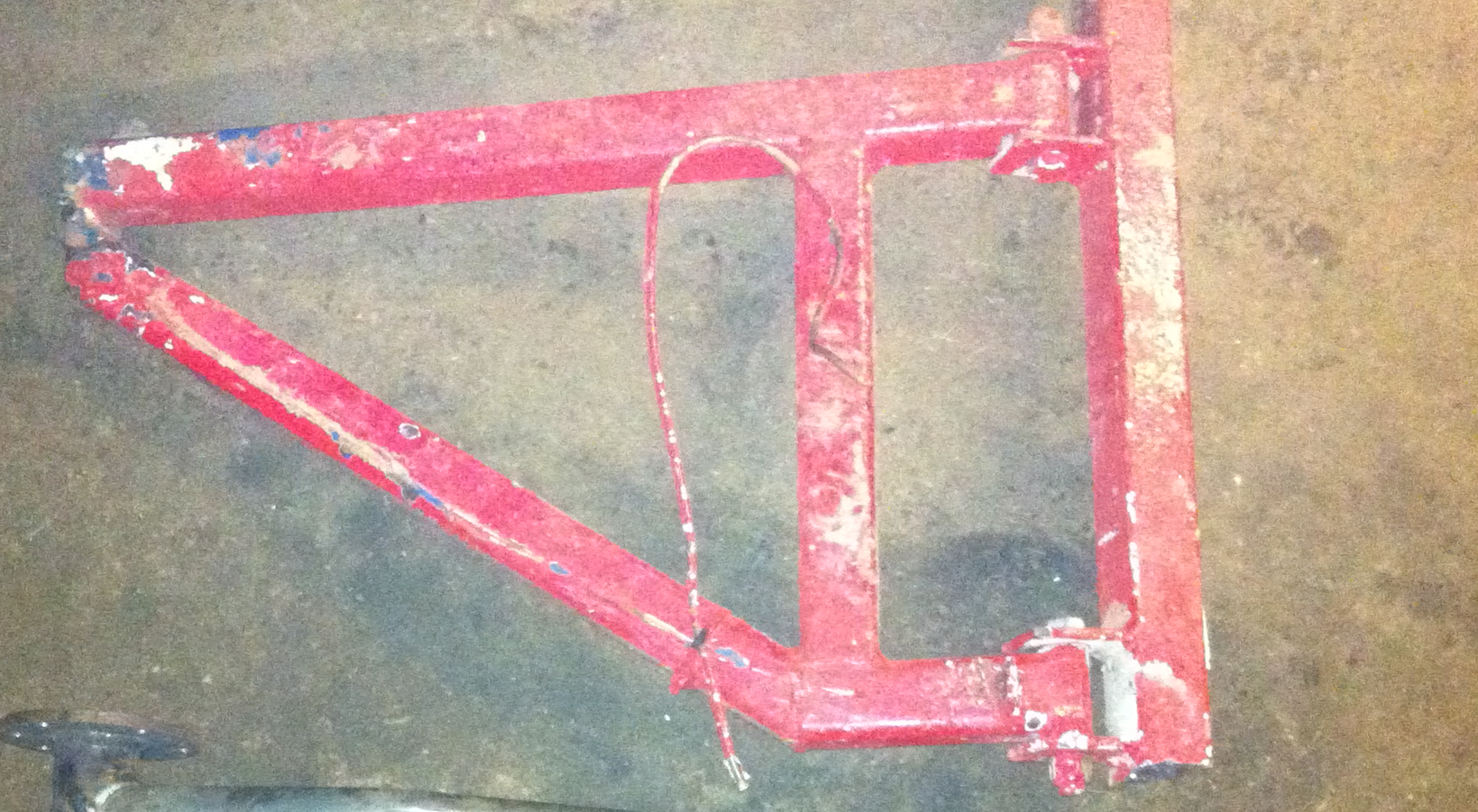

  14. carbon
    carbon Member
    Messages:
    1,690
    Location:
    S. Glos. U.K
    Made some rear swing arms for an autograss mini some years ago, went from this
    to this
    definitely not as complicated but withstood the punishment
    stuvy likes this.
