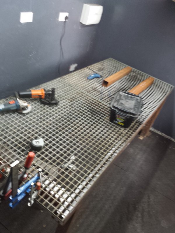

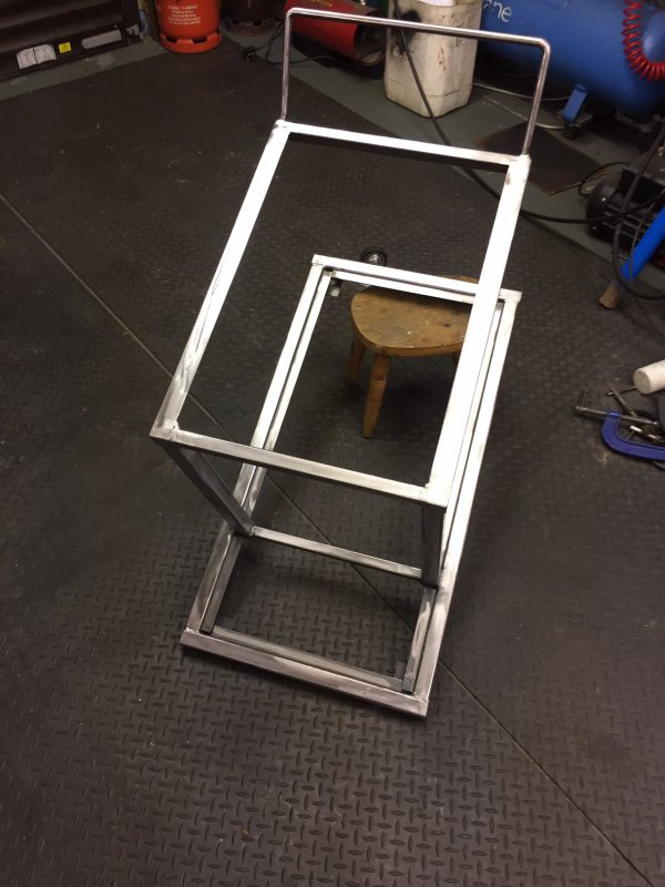

Does the top welder bounce around when moving? As there is no support at the front.
I thought abou doing that as well. However I use the bench for rebuilding bike parts like carbs and brakes and would end up losing bits through the gaps!Steel grating for the top on a budget,
F clamps fit between the holes so can clamp anywhere on the table too.
I don't think id even want a solid top now after using it for mine.
Likewise scribers, centre punches an all manner of such stuff and heck how do you draw stuff out on it? Yesterday I had to weld a load of underground reinforcements, no great tolerance in it but just to get some uniformity I welded one up and marked round it then just matched each subsequent one up to the lines. There is quite a bit you can do like this and it don't half speed the job up when a jig isn't worth making and you don't want or need or want to set each one up perfect.
As a non smoker this is often how I do my "fag-packet plans" so I might be lost without a solid top
Yeah its definitely not good as a layout table but for the price of reclaimed ones its pretty nice.
Could just make a lip for pens/scribers ect like on a white board but they rarely fall through for me so not bothered to.
The clamping anywhere is the part i like, id hate to have to tack things and grind them off.
