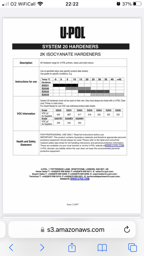

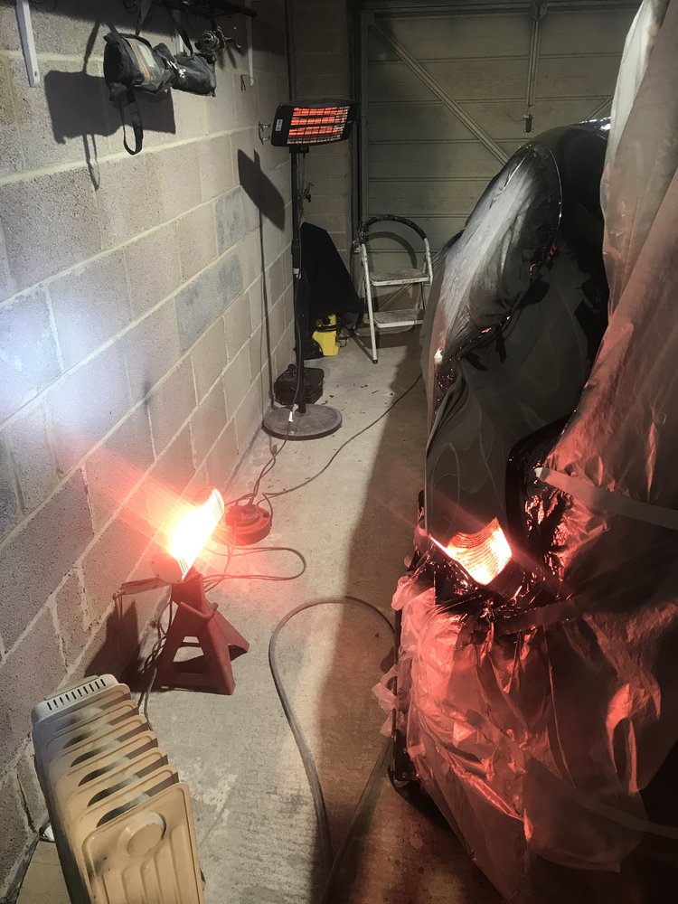

Hi. Just looking for a rough guide. Currently 15 degrees in my garage. One panel. Left rear quarter panel. Not sure if that’s the right name? From the left rear of car, all the way down the front to windscreen.
I’ve found tables from upol for what is a rough guide. Chart of temperatures vs what thinner and hardener to use.
I know from guidance on here, fast is ideal only for small areas and low temperatures. Wondering if I put standard thinner and hardener on at this temperature is it going to run easily? Tempted to use hard thinner and hardener. Had no problem with medium/standard at 20 degrees.
