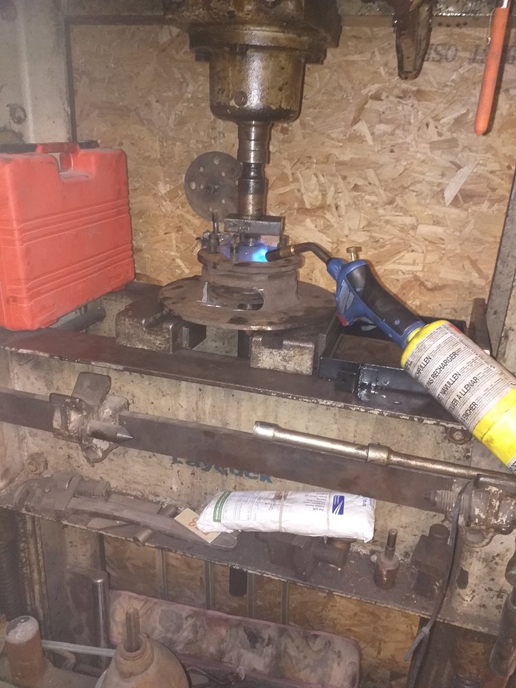

Seldom requires more than six tons of force on anything, but, then again, I do have blowtorches and a tin of Rocol anti-scuff paste.....

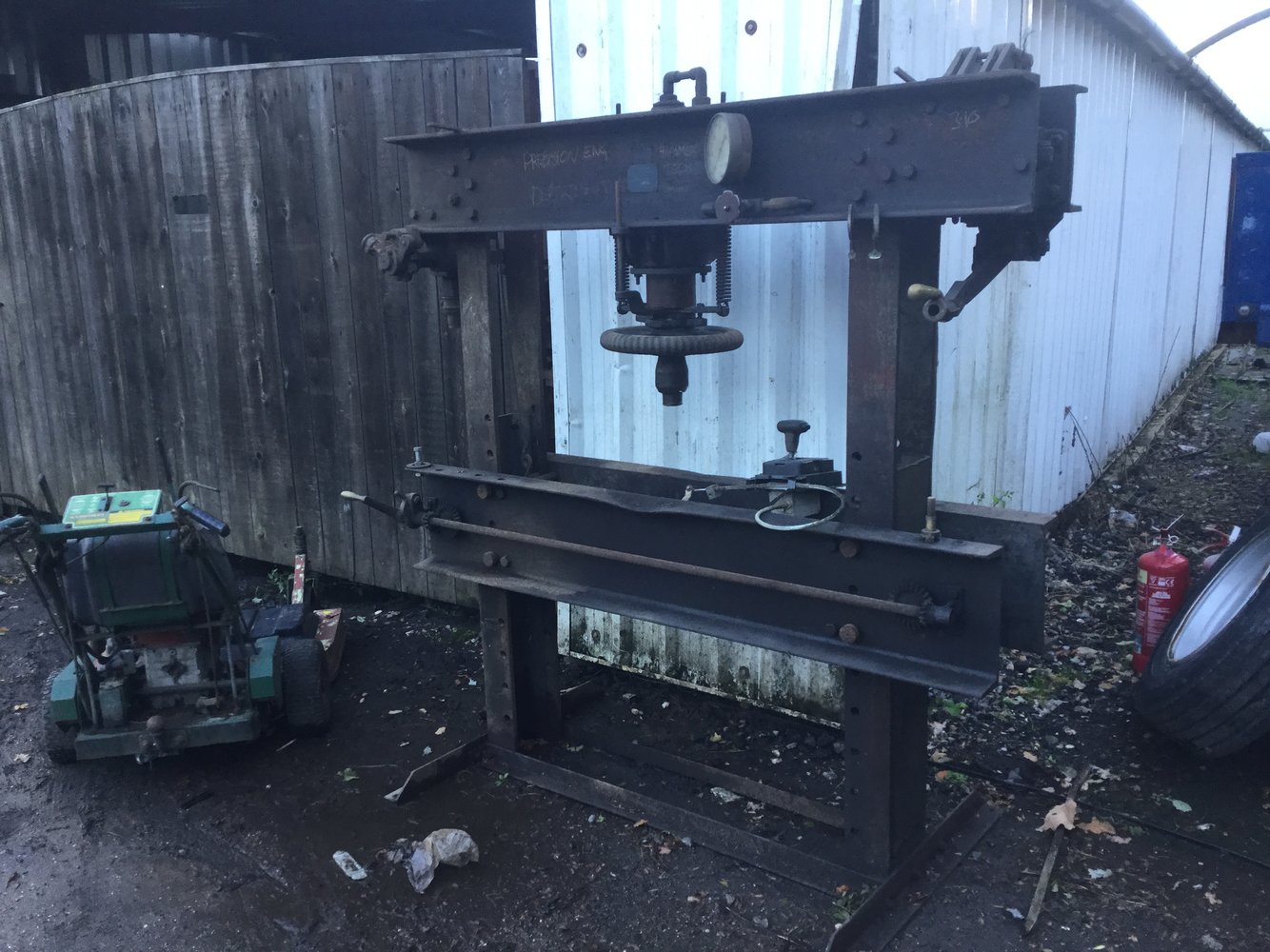

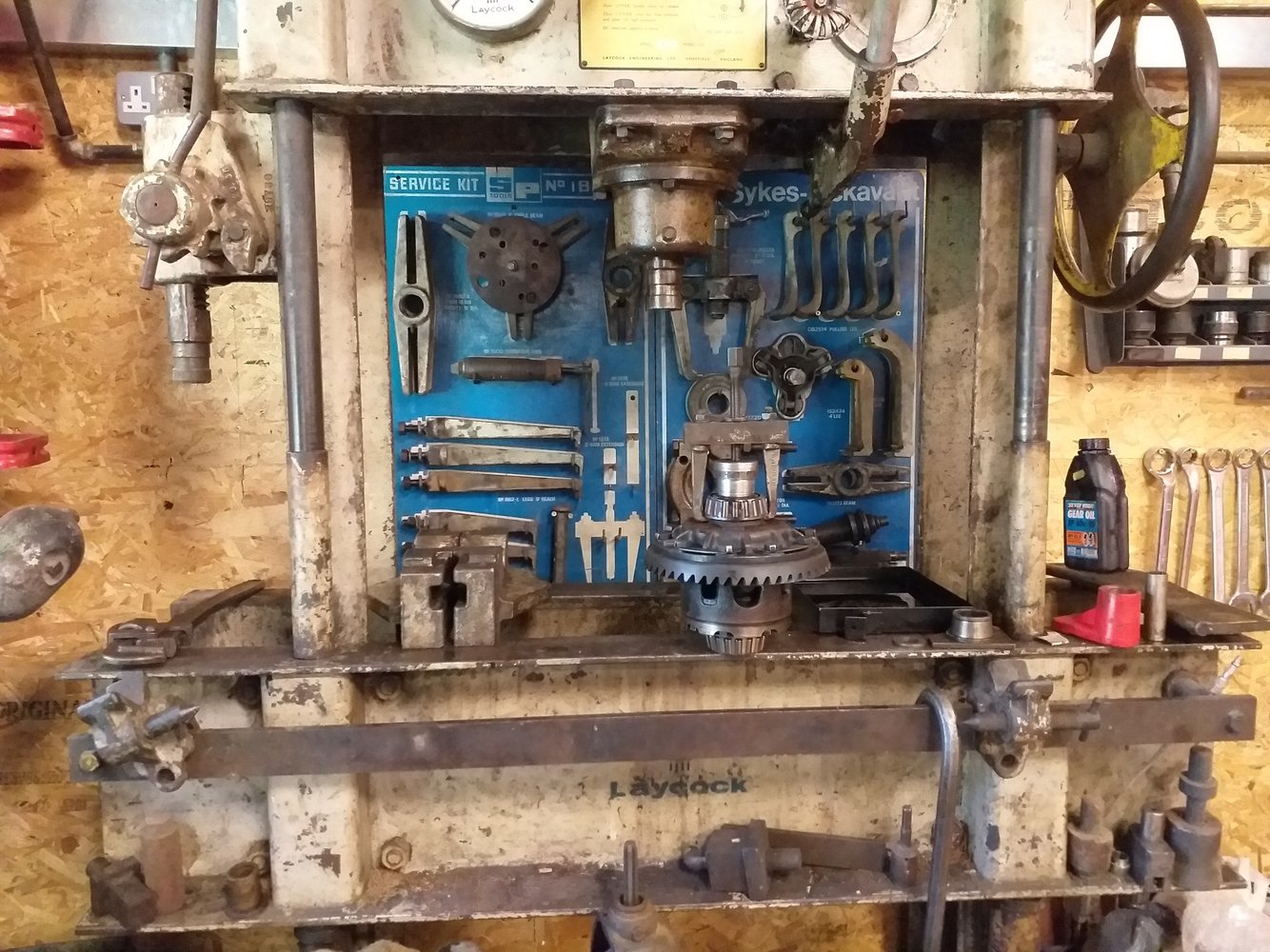

I have a Laycock 60 ton press, best £80.00 delivered I had spent in a long time, bought it around 30 years ago, would not be without it, cannot recall ever going over 5-7 tons, maybe 15 on the very odd occasion but the size is useful when trying to get a motorcycle frame straighter, or girder forks! or rear half shaft bearings on a Mk 2 jaguar,
