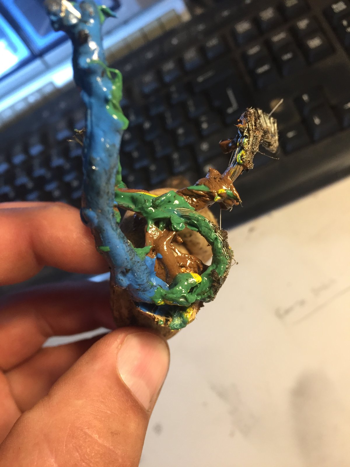

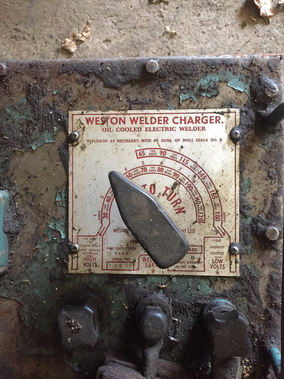

    Can anyone reccomend an approriate spec of power cable for my Oxford Oil cooled welder?
    Its 180amp max output. I plan to wire it to my 3 phase 32amp supply as others suggested in a previous thread so need three cores (2 phases and earth) and woudl ideally like a 12 metre cable length (15 or even 20 would be better) so dont know how this affects the spec.
    The current cable looks original and is 'melting' in places as I think it is natural rubber (its not current related as I havent plugged it in)

  7. reb78 Member

  10. reb78 Member
    Messages:
    1,066
    Herts UK
    I guess this old cable needed replacing?!
