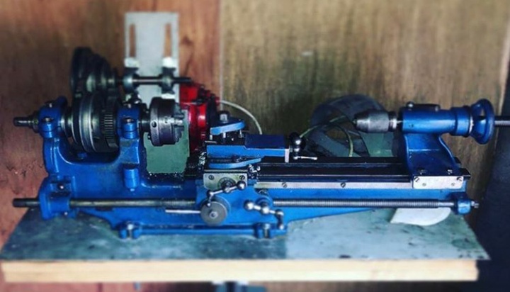

R Ruffian Member Messages 3,621 Location Devon UK Jun 12, 2020 #1 Hey all, Anyone know what myforrd lathe this is. My mates bought it and after some spares etc. Cheers 20200612_180033.jpg 77.8 KB · Views: 107
eLuSiVeMiTe Member Messages 16,282 Location ...... Jun 12, 2020 #2 An Ml Based on the Drummond m Think the larger beds were ml1 and 3. Check lathes.co.uk for a fair bit of info on them
Matchless I started with nothing, still have most of it left Messages 3,021 Location Essex UK Jun 12, 2020 #3 sounds like a knock off Myford…………..
R RichardM Member Messages 4,724 Jun 12, 2020 #4 probably a late ML4 if the v belt pulleys are original. http://www.lathes.co.uk/myford-ml2-ml4/
grim_d Unlikeable idiot. Messages 4,160 Location Scotland - Ayrshire Jun 12, 2020 #5 Matchless said: sounds like a knock off Myford………….. Click to expand... That's what the sons did.
