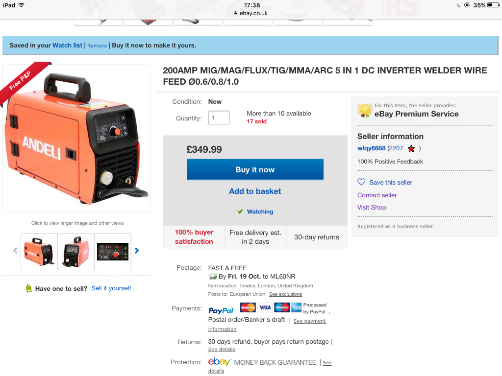

View attachment 156769 Hi guys , fancy a new welder going to be welding car body nothing to heavy ,got my eye on this is it any good for what I need ,any advise much appreciated ,

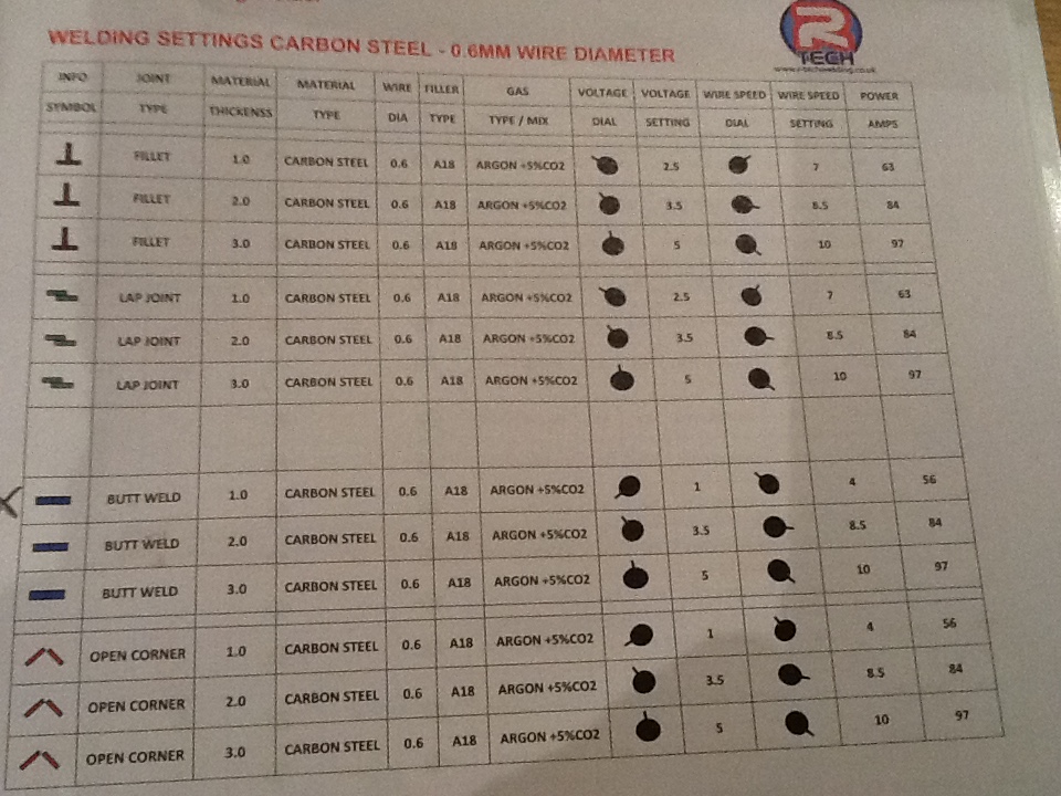

Maybe a little bit but I've been welding 0.9mm sheet ok on the lowest setting. Works well for the priceI looked at that and to be fair it seemed ok but I noticed on the MIG seeing the lowest it would go is 50amps which from what I've read on here and remember maybe a bit high?
Needs to be good on mild steel ,and body panelsI have an rtech 180 and they are brilliant. So smooth to set up and use
