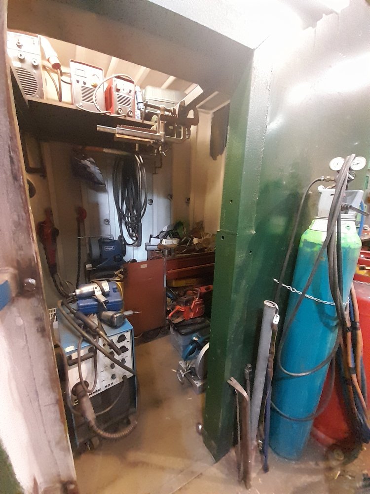

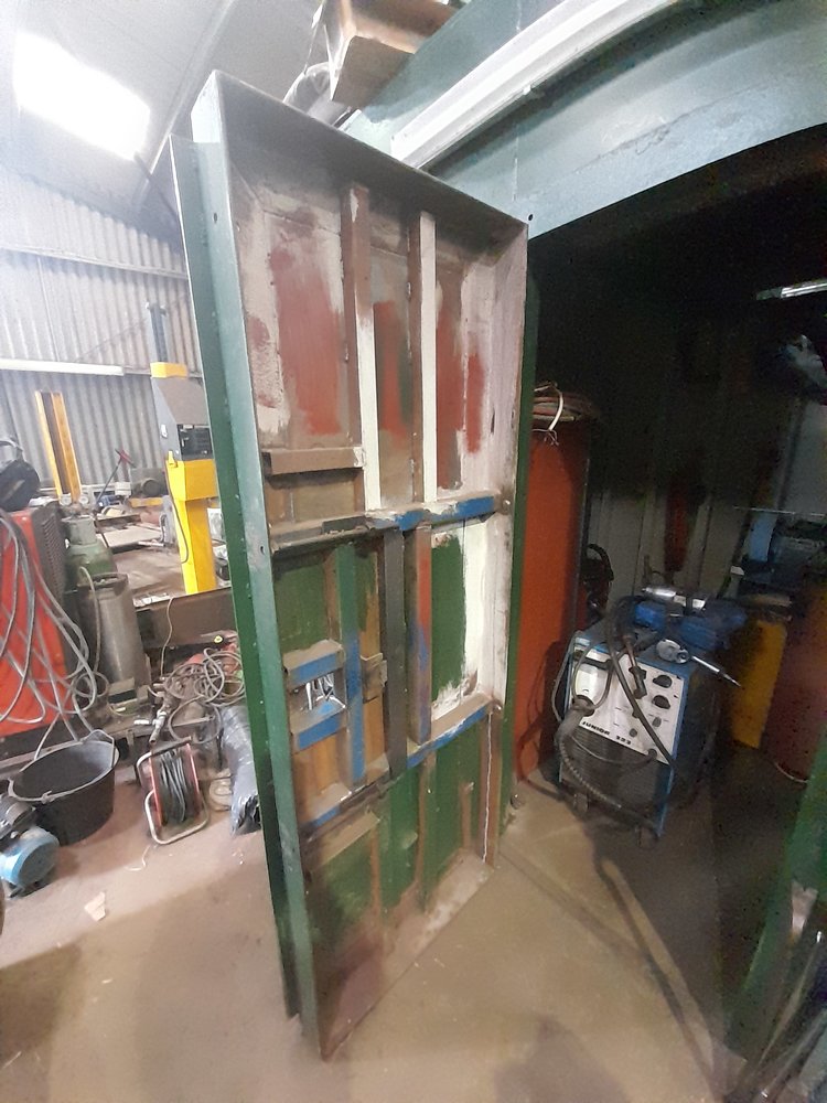

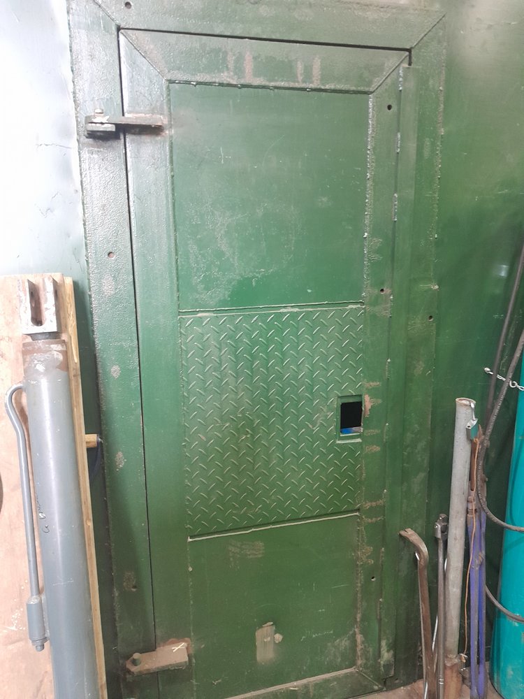

2x2 RHS frame.
3mm steel skin.
Rack bolts in each edge so even if hinges are cut, the door can't be pried open.
"Sound bomb" style alarm.
Make it difficult to attach a winch/towrope and just pull the entire door+frame out with a stolen land rover
Favourite tool of choice round here is a cordless angry grinder, so consider how to make access difficult - 1/4" steel shell over any padlock is usually the first step
