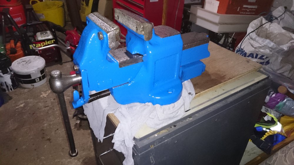

for my quick release vice it has a bar underneath

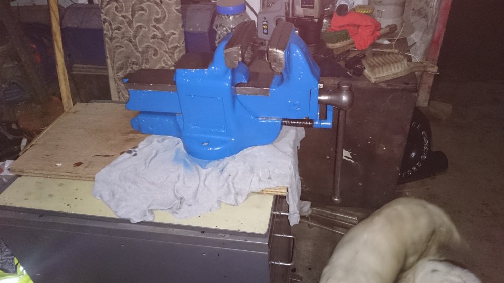

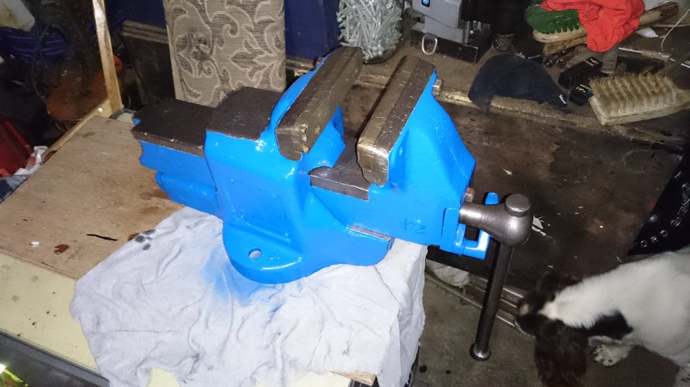

I made the mistake of putting on a grey primer which shows up when it gets chipped. I think putting the blue straight onto the bare metal would've been better.

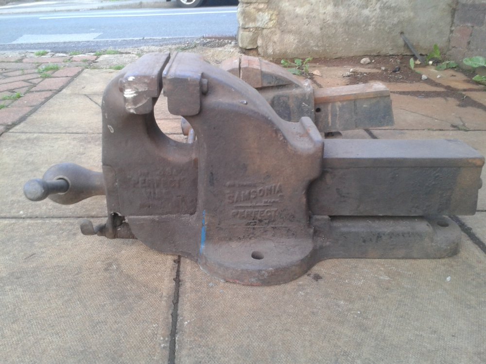

Well I hate to do this but I picked up this little gem in a job lot, for a fiver!
It's so minty and original, I daren't use it. Probably just tidy it up and sell it to a vice museum!

Love it. Well found.
Aww no! I grey primered mine, never thought about paint getting chipped.![]()
