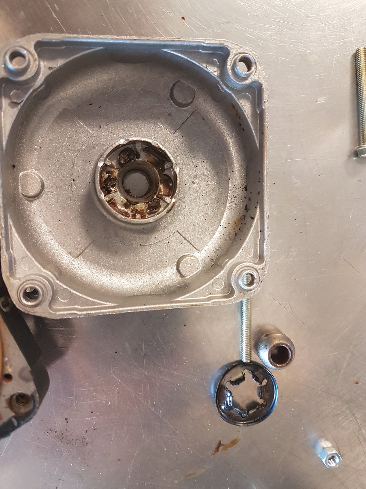

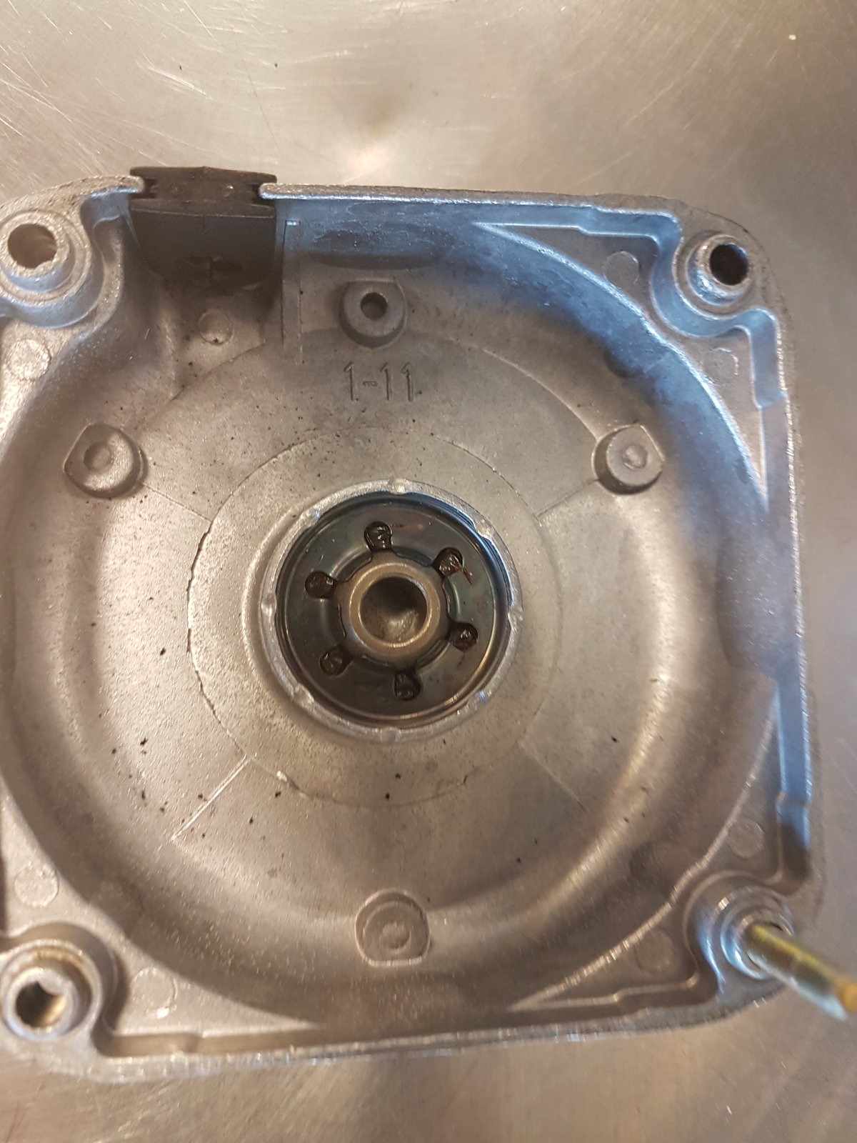

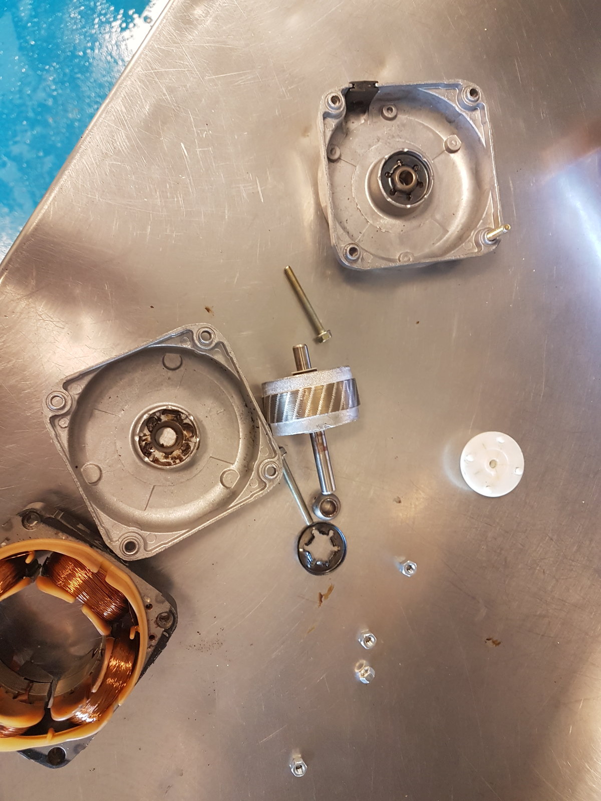

Can they just be greased and put back together. It's a cooling fan for a freezer freezer was not getting cold new fan all is good just greased this one and it is running on again but what's the life span on this type of bearing
now and then a few pack in and I just replace them . they just sieze up cook the windings and pop
its cheaper to just replace when needed as there is about 100 of them
