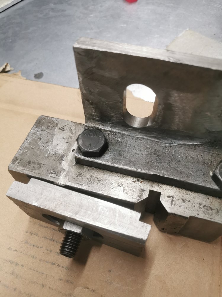

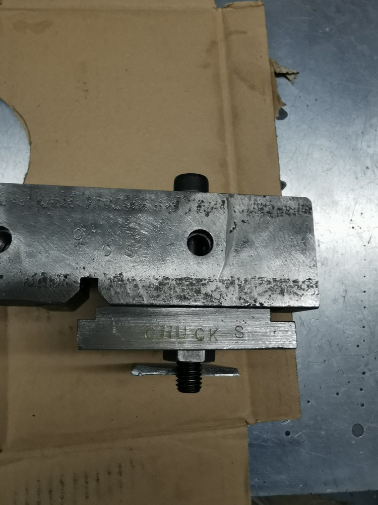

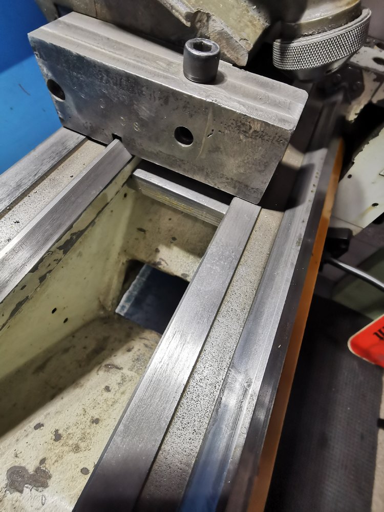

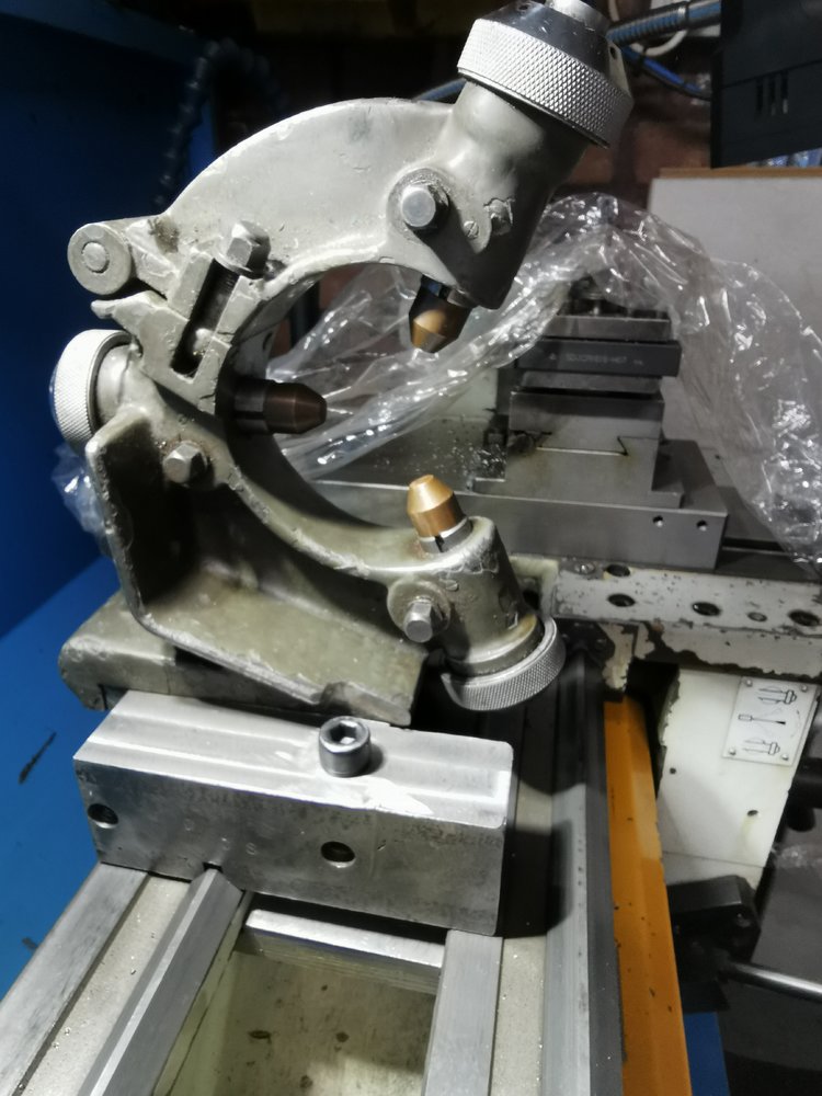

I reckon that’s a boring bar holder.Don't know I got one too with a lathe I bought, dont expect we will ever know their use
View attachment 362118View attachment 362119
Looks a bit heavy duty to just be a bed stop, I was thinking it's an adapter to use a fixed steady from a different lathe.Bed stop for turning up to a stop repetitively.
That kind of looks like a way clamp for setting up a fixed steady .Don't know I got one too with a lathe I bought, dont expect we will ever know their use
I'd be perfectly happy turning 2" bar with 4" hanging out, no need for a steadyFor some time I've been pondering how to turn out the end of a 2 " bar some 100 mm long in a shallow chuck that only has a headstock bore of 3/4 "
I see it now. Couldn’t make it out on my phone. I thought it was just someone’s nameThe clamp fits the bed both bits have Chuck side stamped on
