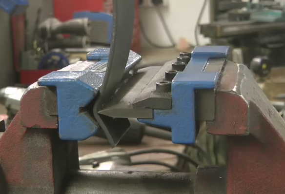

The seller of that is called stakesys, isn't he a member on here? I wonder if it's the same person.just for you vice metal bender/folder
http://www.ebay.co.uk/itm/150mm-6-V...559?pt=LH_DefaultDomain_3&hash=item3cf0745ce7
Agree theres no way thats going to push that into a sharp 90...poor vice would be crying out for a paramedicThe photo shows it apparently bending what appears to be 3mm flat bar at least and maybe even 5mm, personally I think that is beyond it's capabilities and you would end up hanging off a lump of bar on the vice handle risking damage to vice/tool/body.
Good tool for 2mm and less though.
Ive got one, they have really strong magnets in them for gripping the vice, had mine ages,theyre excellent for forming small brackets etc. I cant be sure but think I got it from axminster tools, could be wrong it was ages ago.I've racked my brains and can't get any results on my ideas (vice jaw bender, vice jaw accessories etc.)View attachment 65953
Anyways, it looks like a really handy attachment for a vice, so I'd quite like to get my hands on one!
The fingers on mine are adjustable, I think the term for the gadget is a box and pan type folder.I like the Stakseys version as the fingers are adjustable - which doesn't look like they can be on the axminster one.
Isn't box & pan where you have a lever and a moving side?The fingers on mine are adjustable, I think the term for the gadget is a box and pan type folder.
