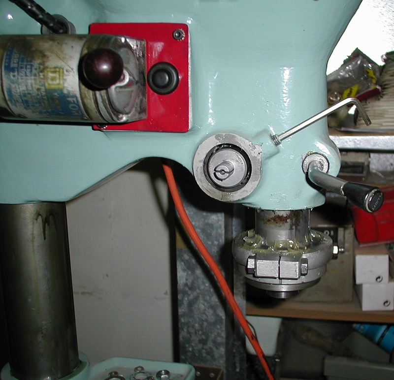

I wondered whether it was perhaps to assist with setting a depth stop (presuming it has one?), would the quill lock really be strong enough to hold it in place during milling?My Progress has a quill lock, I think it's so you can do light milling, or maybe it's easier to drift the taper with the quill locked.
