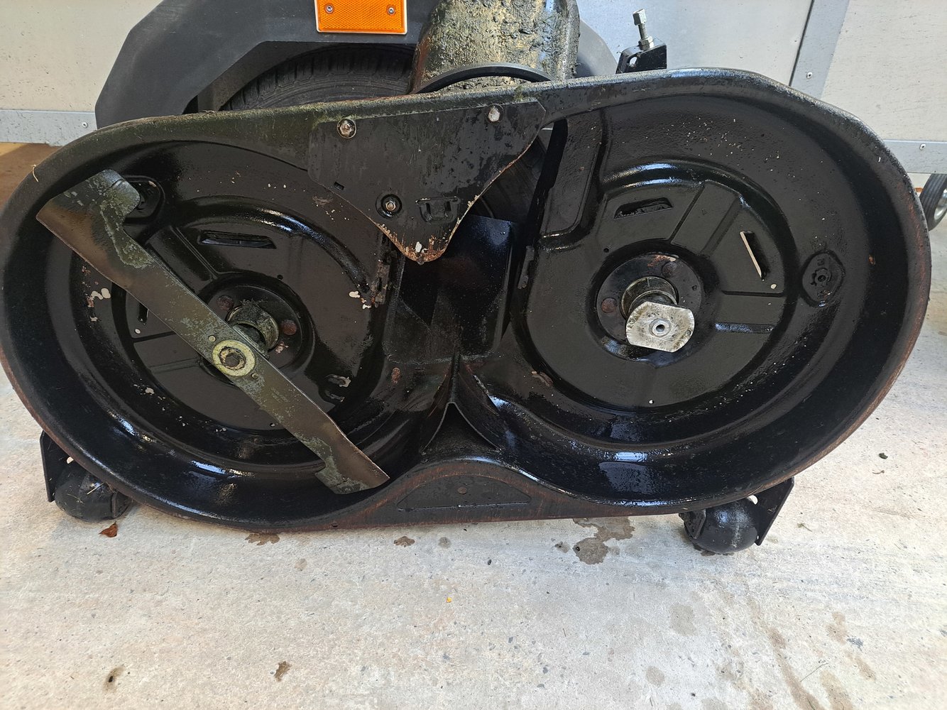

Discovered that ride on lawnmowers use a left hand threaded retaining bolt on the right hand blade. Unfortunately I only made this amazing discovery after I'd sheared off the blade retaining bolt!![]()
And of course it broke off some distance down the spindle.
FFS thinks I!
Stripped the deck off it, removed the spindle and managed to take the shaft out of it, fortunately revealing the broken bolt level with the end of the shaft. A washer, m10 nut and judicious application of the mig had the recalcitrant bolt out.
Pretty much a free fix apart from being fleeced at the local lawnmower shop to the tune of £2.15 for a single replacement left hand threaded M10 bolt.
Gave me an opportunity to give the deck a really good power washing while it's off.
I think I'll give it a coat of paint just to give it some protection. In 2 minds to use epoxy primer or a zinc based silver paint. Maybe both? Don't suppose it will make much odds as it'll still get chipped with flying stones. View attachment 485585

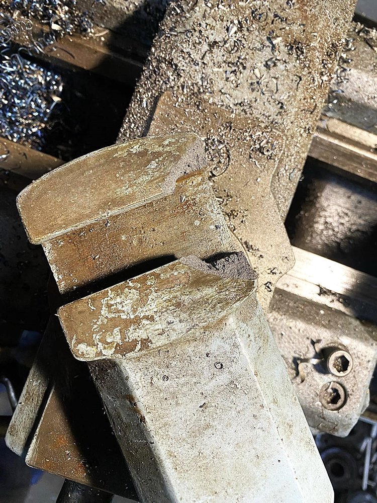

Toolpost bolted too close to the edge of the top-slide when the parting blade jammed in the cut.
Did you use cast iron arc rods to build it up again?Same thing must have happened to a Boxford top slide I had.
Welded it up and it came out ok.
Yeah thanks, I will go the nickel rod way when I do repair it, there is actually plenty of toolpost slide left for any lathe work that I am doing, I'm just annoyed that I broke it due to carelesness.High nickel cast iron rods would be an excellent choice and easier if you have a arc welder.
I'd preheat and post cool if you can.
