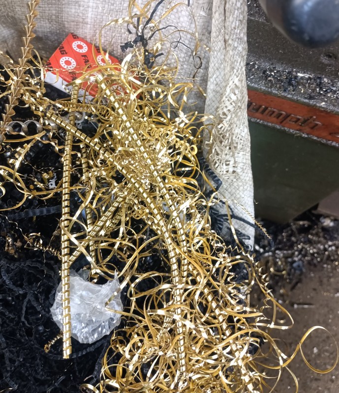

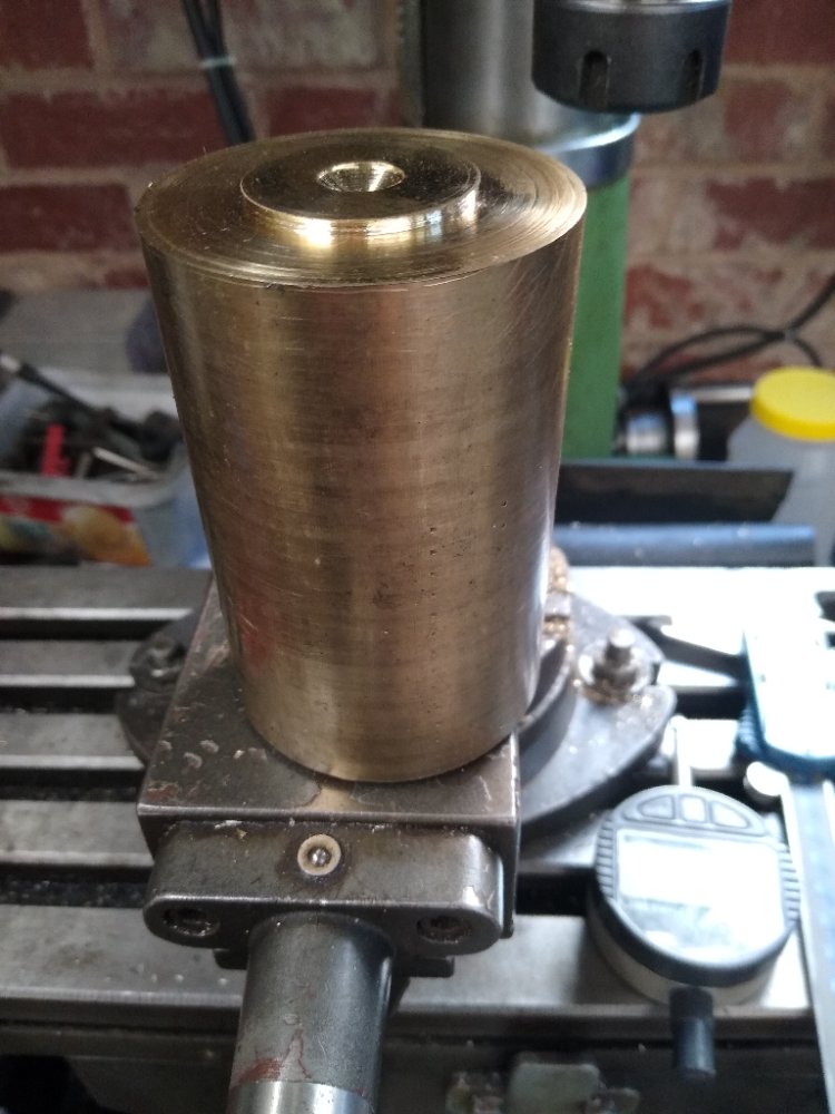

In my stash of spare stock I had a 75mm diameter chunk bass, I don't remember where it came from.
I bored out a inch and a half hole in it and parted off a 1/2" thick piece. It was not like any brass I have cut before making mainly fluffy swarf not little sharp chips. Parting it off was a challenge but I got there in the end with a really slow feed rate. A couple of times the tip dug in and I had to run an hacksaw blade in the groove to clear the divot which seemed really hard.
Then I put it in my new to me mill and really struggled to drill a 4mm and then a 5mm hole through it, I changed the drill bits twice but that didn't help.
I then had to tap a 4mm thread in one of the holes so I used a first tap and lots of lube and eventually got through but the thread was really tight so I then used a second tap gently with cutting oil back and forth but you guessed it, the tap snapped in. I have changed the design
now still using the part.
I know there are lots of different brass types and was curious to know if anyone could say what it is?
Some bits of swarf from the scrap bin.
