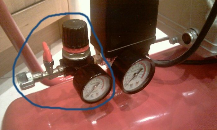

A couple of items arrived today, could I have some advice on how to put it all together please?

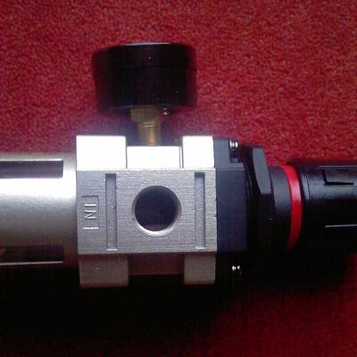

a) Should I take the entire section (regulator) off the compressor as per blue circle in the compressor photo? And then fit the filter/regulator here instead? The filter/regulator has a 3/8" BSP, what fitting do I need to attach it to the compressor?

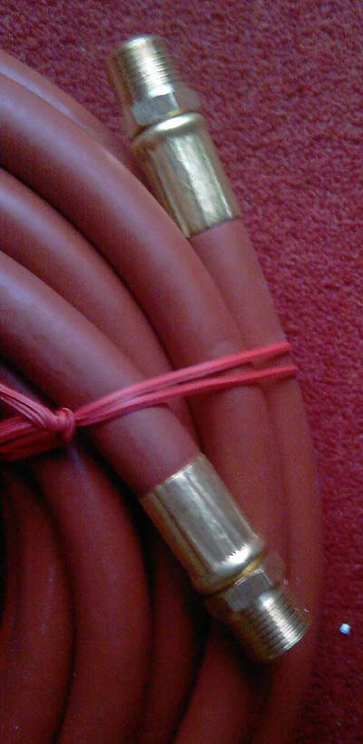

b) The 3/8" hose screws straight into the filter/regulator, I take it there is no need for any other fittings here then?
