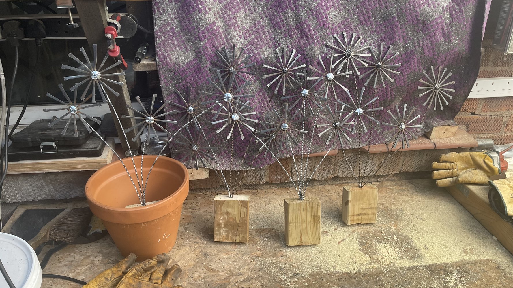

Hi, I have been using a piece of scrap SS about 2ft square as a welding table. It’s only 2mm thick and is not ideal, but it was a couple of quid from a scrap merchant so has suited me as a hobbyist and owes me nothing.
I think my level of sophistication will be shown below. So not looking at precision work.
