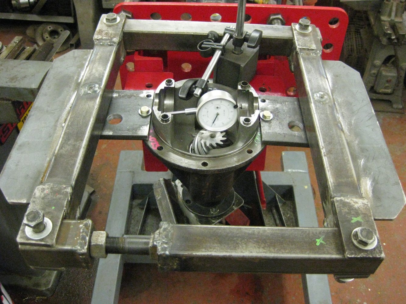

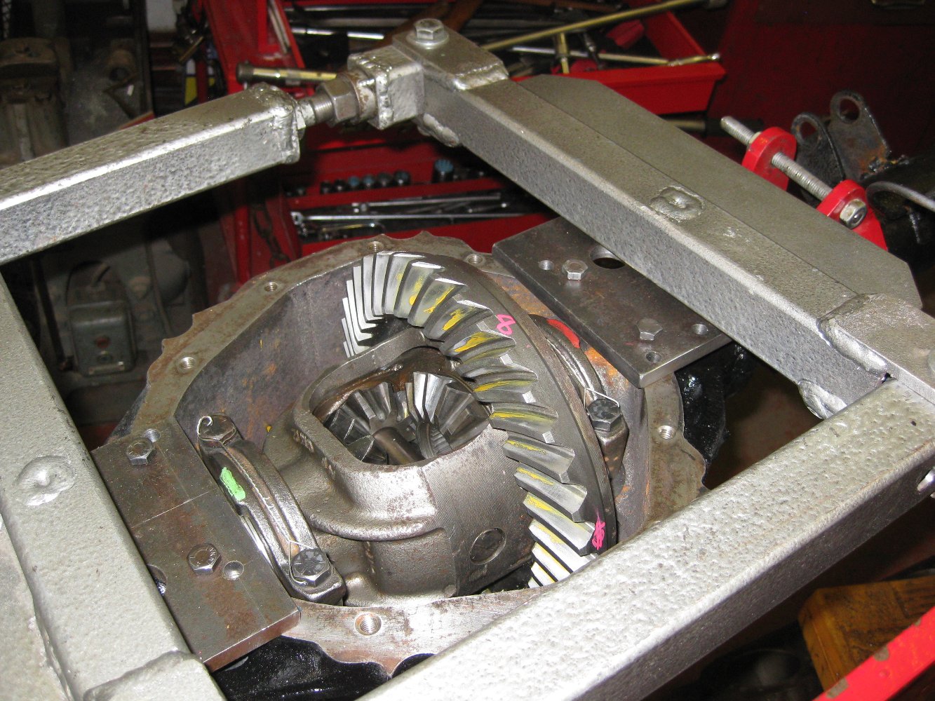

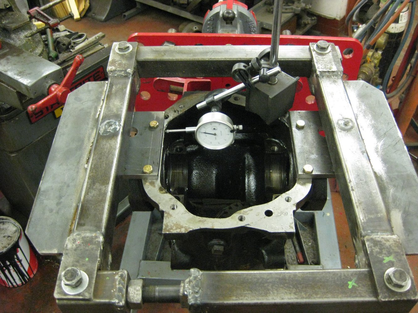

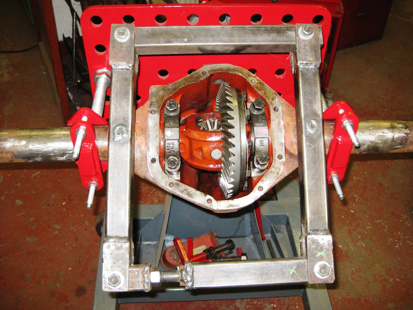

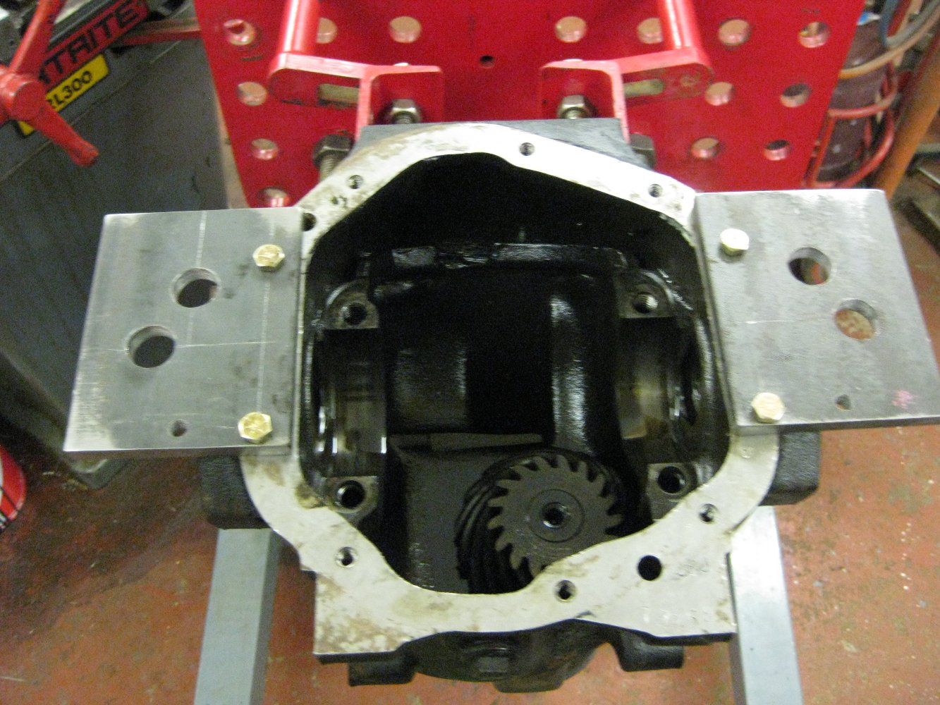

Well they won't will they when there's a chance to sell a special tool.![]()
Curiously, the dingcroft one is a crusher, rather than a stretcher -
Differential Case Compressor
Application: Salisbury axles on Series 3 and Defender. (Also aplicable to some Jaguar models!!) Description: Tool for compressing the Salisbury axle casing in the vertical plane. This allows the differential to be removed. This tool does the same job as the earlier spreader and pins referred to...
