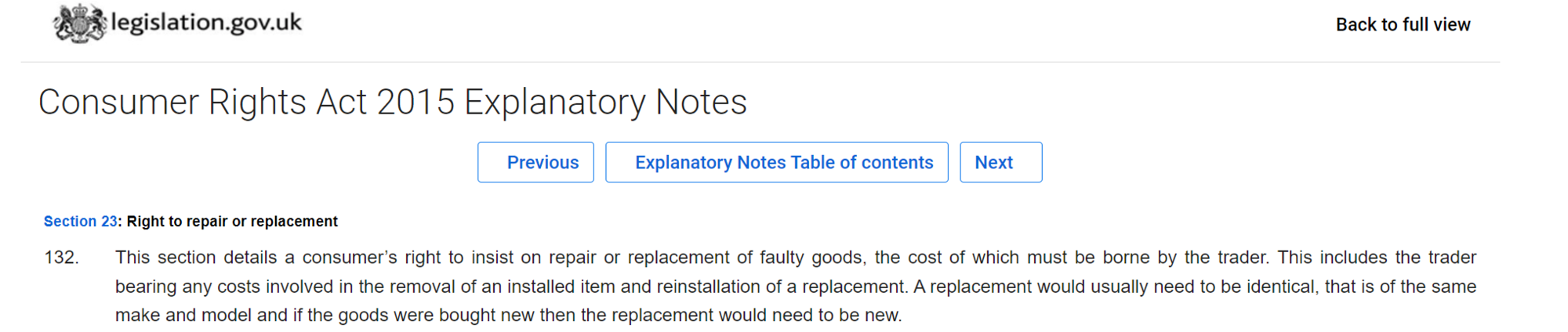

It doesn't need to be court ordered. Under CRA 2015 (talking about goods for a moment), if a defect becomes obvious in the first six months, the seller has to accept that it has an inherent defect unless they can prove otherwise. After six months, the consumer employs the professional of their choice to provide the report. It is something I often did for customers of Currys who believe that their own terms and conditions override the law. That report would also be admissible in court should it get that far, as Small Claims Court works on the balance of probabilities rather than "beyond reasonable doubt".
How that works with services I will have to revise as it isn't something I was involved in very often, but my instinct is that a similar procedure would be the case for a consumer. The SGA and SoGaS were both amalgamated into the Consumer Rights Act in 2015.
The CRA 2015 covers them all, so that is the law of the land. Small claims track is far different to Fast track or Multi track cases. The only time a CRA claim would go to court is in the event that the supplier refuses to help. In that case, a report, like the ones I produced are evidence enough for a Small Claims case. Five years ago I could quote you chapter and verse off the top of my head, having administered over a dozen successful cases. Nowadays I would need to revise the facts before I could do that.Goods are different to professional services. The judge is never an expert on these matters and will only rely on a professional, if both parties bring an expert in defence it will be no help to the judge, this is why a judge has to appoint an independent.Its never easy.

you have the protection of The Sale of Goods Act,
I'm out-of-dateNot since 2015. The SGA and SoGaS were both amalgamated into the Consumer Rights Act in 2015.
I'm out-of-date
The CRA though... surely it does not reduce the levels of protection of the consumer from rogue traders over the scope of the old SGA?
