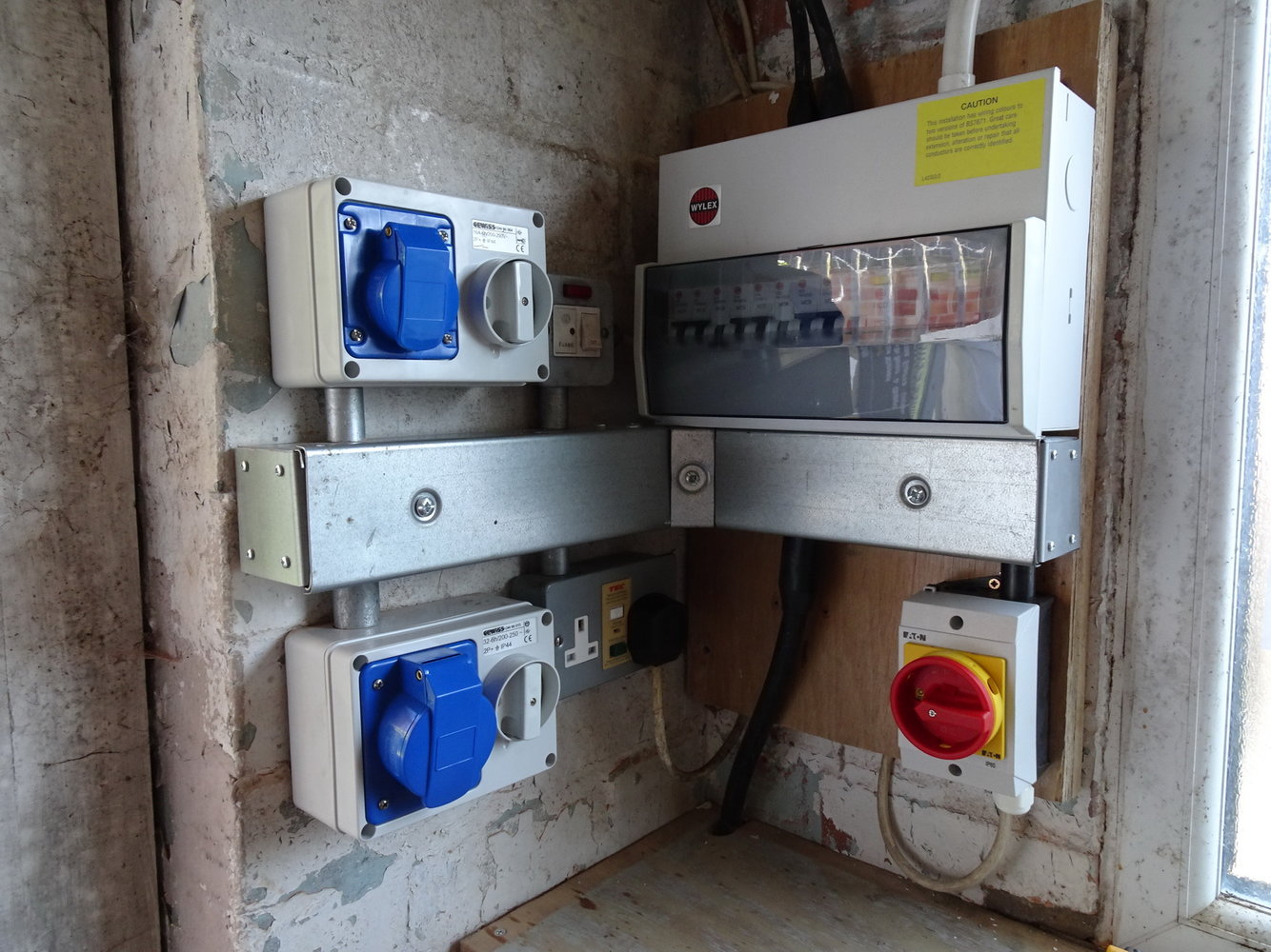

You could, yes. But the mcb only switches the live, so not total isolation. Those isolators will be Double Pole.thats posh you could have used the mcb as isolators as the sockets are next to the db
Went for same when having new garage wired. 16amp outside for the caravan, 32amp inside for the welder.

You can get a 16amp socket/isolator as one unit https://www.superlecdirect.com/p-gw...MIrsrTq7fs8wIVSJ7tCh3NVw7CEAQYAiABEgI7nPD_BwE
Yep, that did look like a good price. I think Screwfix were about £130!I didn't realise they were that cheap now, last time I priced one they were crazy money!
