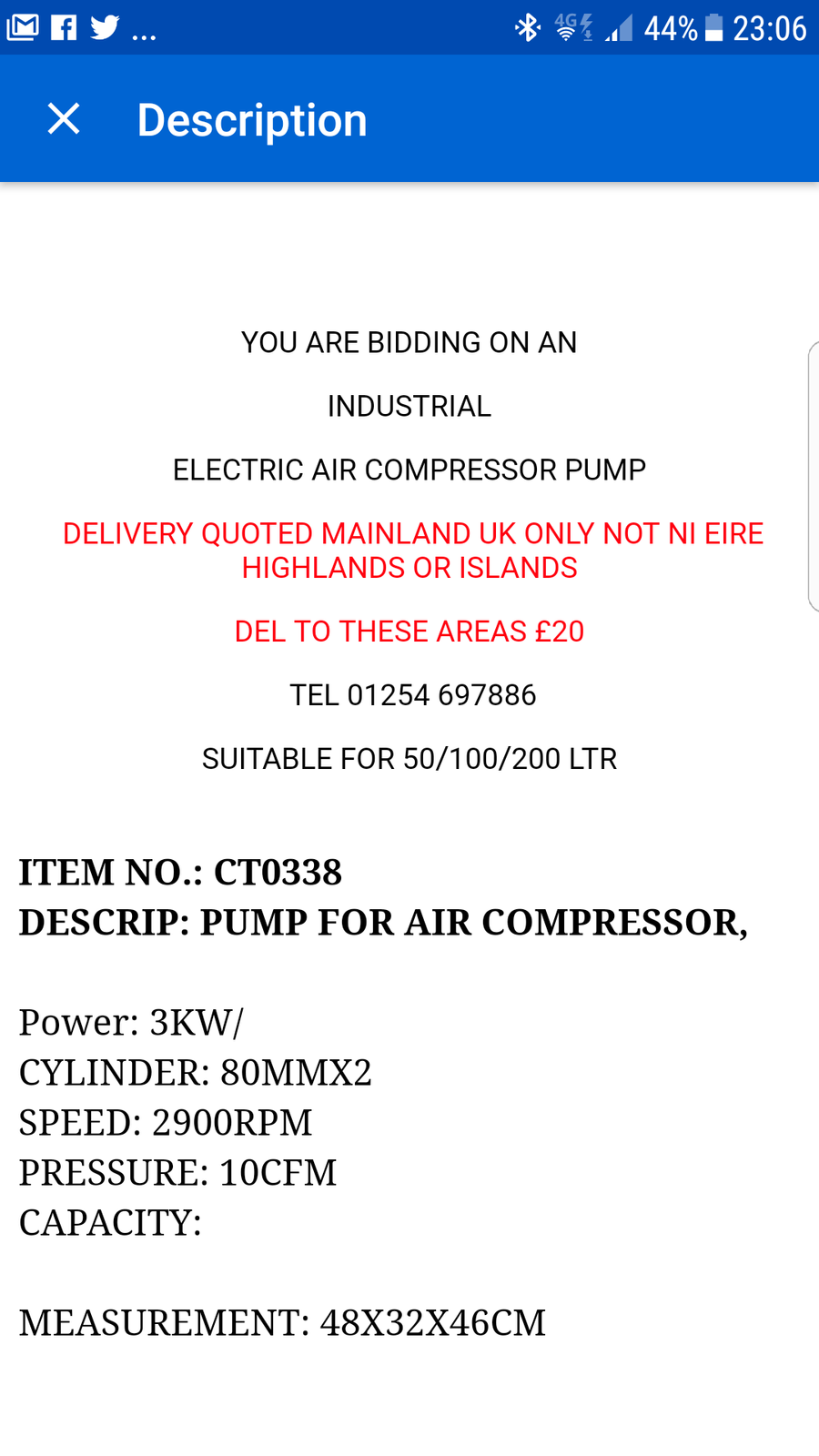

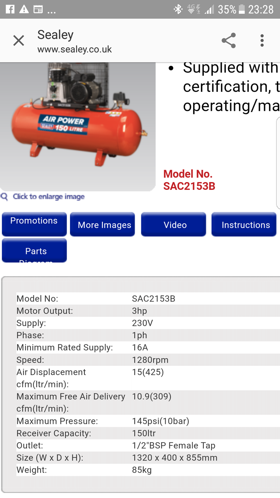

As mentioned by several others on here, for the money you can't beat one of these http://www.ebay.co.uk/itm/Wolf-Air-...121720&hash=item566fe67977:g:KbMAAOSwrlRZw3um on recommendation from the forum, I did...
Really is a great piece of kit, and on comparison with the price SIP from machine mart, the Wolf isn't that different. However the performance is, belt driven and 14 CFM (around 9 Free Air Delivery) it's gotta be the better buy all round.
...and yes you can link the compressors, and certainly a good idea.

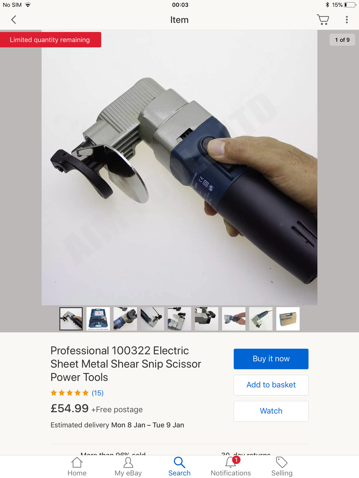

I’d like to be able to use air nibblers as currently I cut sheet metal with an angle grinder, I feel nibblers would be a lot better and electric nibblers cost loads.
Had a quick look at the Hvlp turbines and they seem to cost way more than a compressor. Would the multi capability of a compressor not be a better buy?
