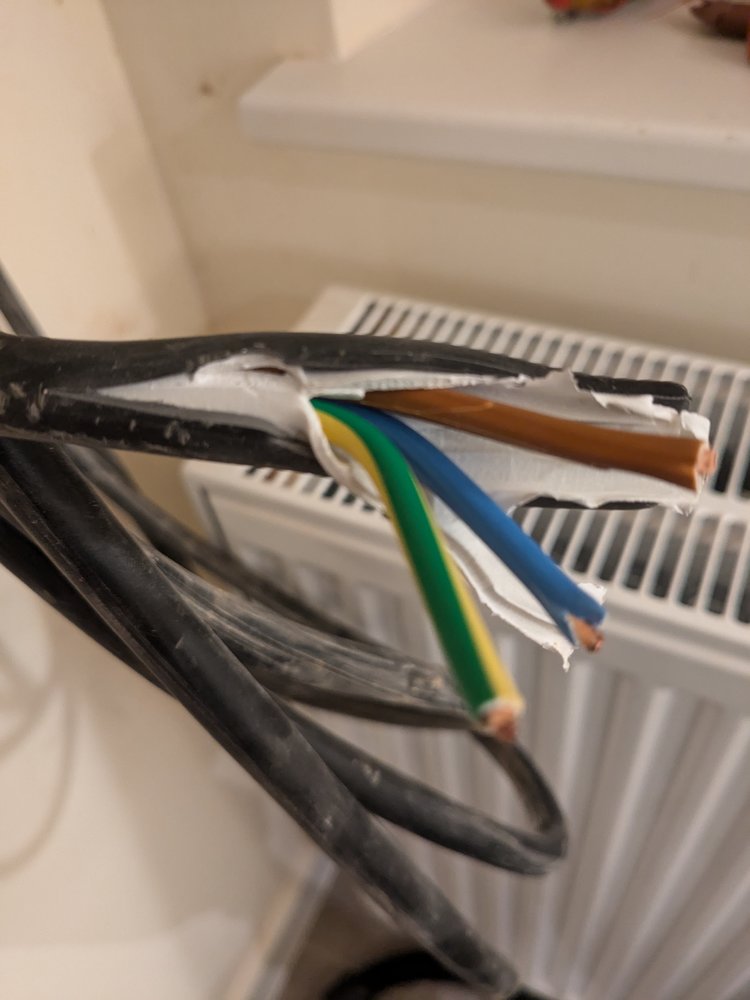

M Mikey D Member Messages 1,712 Oct 21, 2024 #1 Morning chaps , what might this cable type be called it's stiff like swa but there's no steel armour in it ?? Thanks Mike
dobbslc Member Messages 13,947 Location Hertfordshire UK Oct 21, 2024 #2 It will usually have a BSEN number stamped on it. You might need a magnifying glass to see it though.
D Dave-sparks Member Messages 705 Location Woking Oct 21, 2024 #3 Could be NYY-J or a proprietary own-brand version such as Hi-Tuff or Tuff-Sheath. NYY-J has solid core conductors whereas Tuff-Sheath has coarse stranded conductors, I can't remember what Hi-Tuff has.
