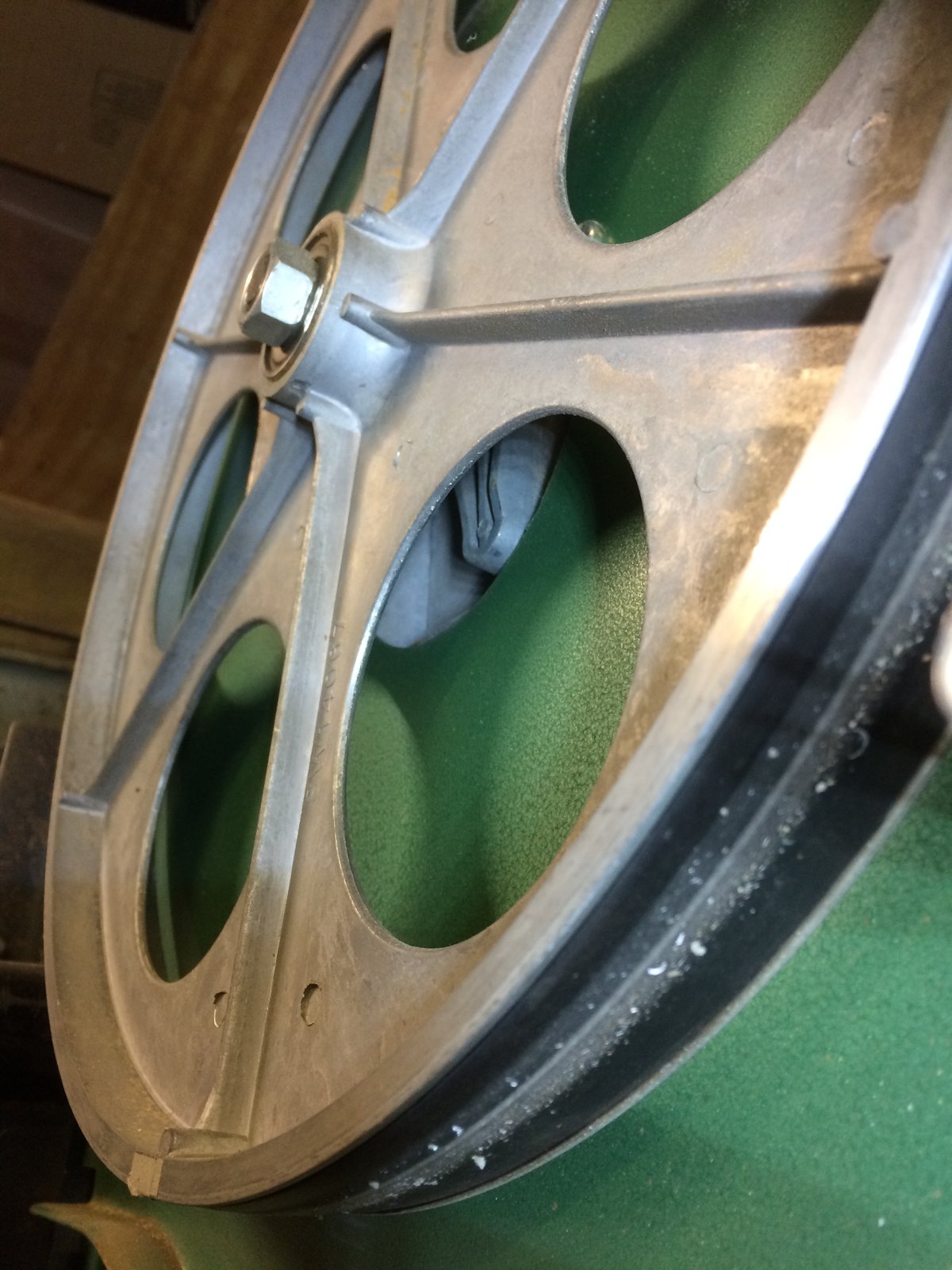

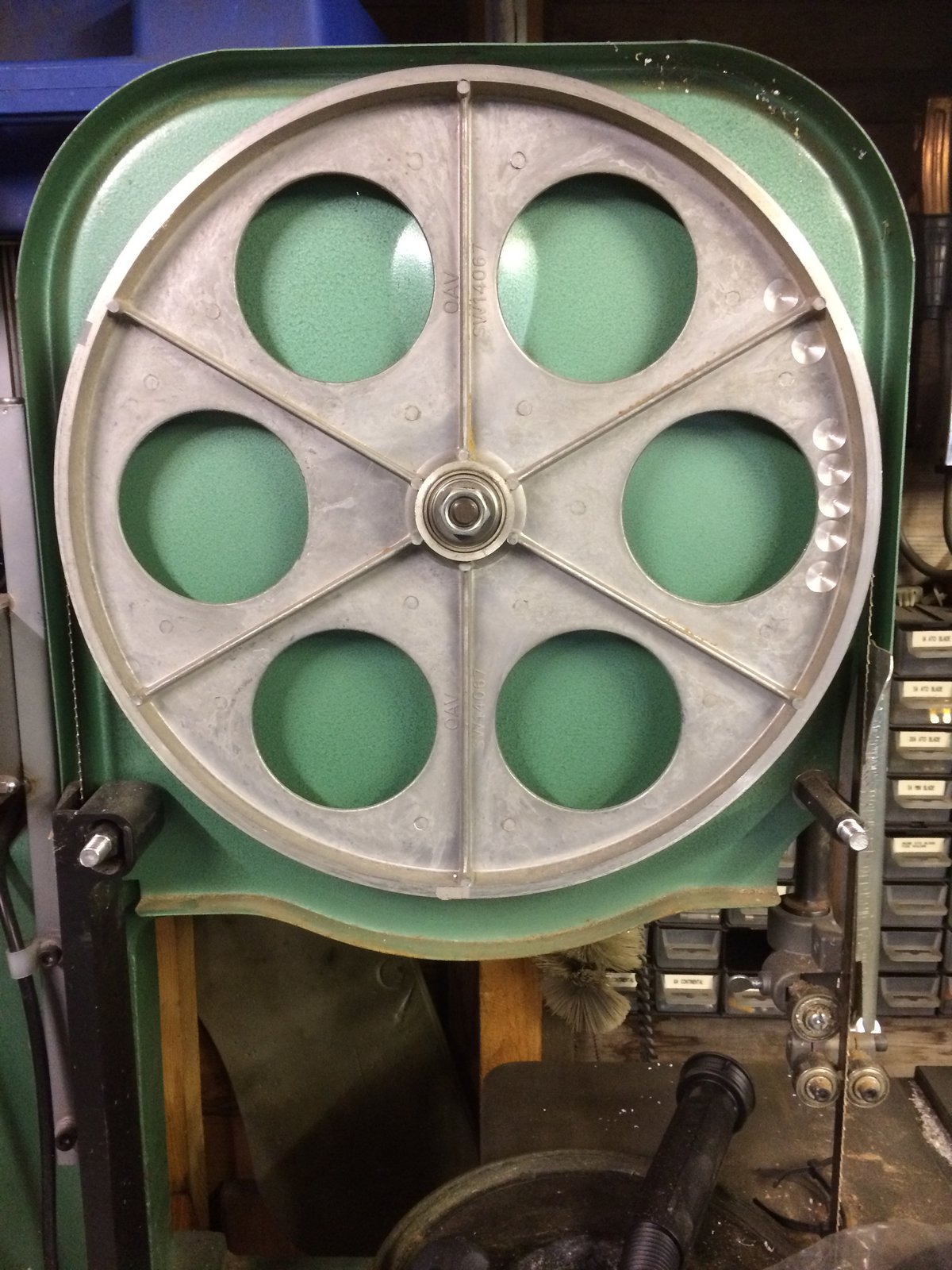

Measured the blade on mine. Seems to be 91 3/4" (or there abouts).
Someone suggested putting the top wheel in the mid point of its travel, and then measuring the distance between the two centers, doubling it, and adding the circumference.
There seems to be no real stop point on the adjustment, before the wheel hits the guard. I guess i should count this as the end of range at one extreme.
I wonder if someone fitted a shorter blade on mine as its missing the tyre on the bottom wheel? A 5mm thick tyre on one wheel would add about 1/2 an inch to the circumference but im sill about an inch to an inch and a half shy of your measurements.
I need to go and look at the range a bit better i think.
Seems like the price has risen drastically, I have the bearing conversion price noted down as £54.88 including postage from Axminster and the date as 28/08/2014. Luckily my saw was only £40 to buy in bits and stands me in about £140 now it's up & running. I want to gear it down for cutting metal, there is a version with a gearbox that gives speeds for wood and metal.
I see someone has crossed out 91.5" and written 93" on one of the wheels.
That's not my saw though... Or at least not my actual saw.
All very confusing!
